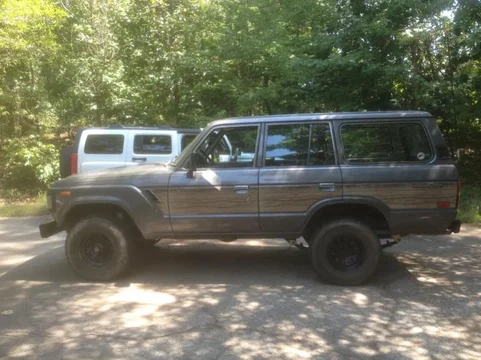

The only real problem is that the new shackles and springs in the front don't create as much lift as the extended shackles did... So the front actually lowered down about an inch hahaha. So, couple that with about a 2.75" - 3" increase in the rear, you got a MAJOR stink bug. I'm ok with the rear being a little higher than the front, but a 4" difference looks pretty dumb.
This week I'm going to replace the new IM shackles up front with the extended shackles I already had on and hopefully, after the rear settles down some, it will level out more :)
Pics when I'm finished... Because I'm too embarrassed to post pics of it right now hahaha.

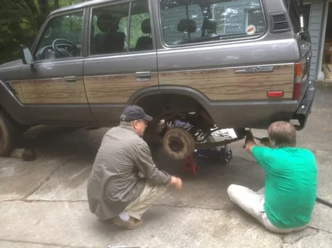

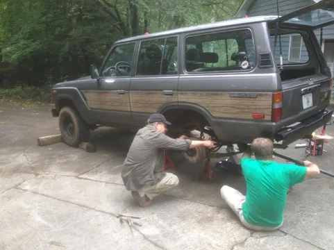

I didn't know my little brother was snapping pics during the install. Sorry if they are bad. He was using the garbage camera on his iPhone...
I'm the one with the legs so white, you need sunglasses to keep your eyes from melting out haha.
RJ and his bud, Pete, working on the rear driver spring. Probably those pins...
TIP: don't burn pins/bushings with map gas for a few minutes, then immediately pound on them while wearing shorts.... Hence the pants..

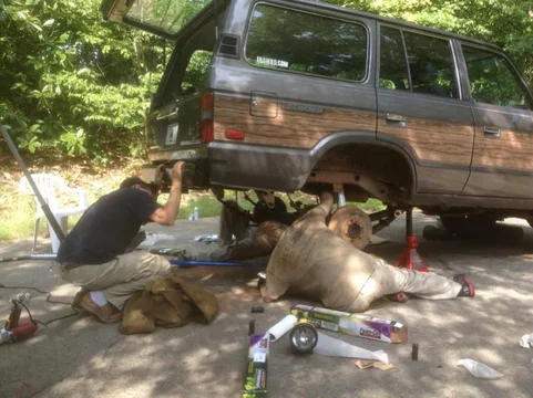

My dad helped me finish the fronts the next day :)
Don't mind the truck in back.. It's my little brothers and he doesnt know any better haha.
Focus on the stink bug.
