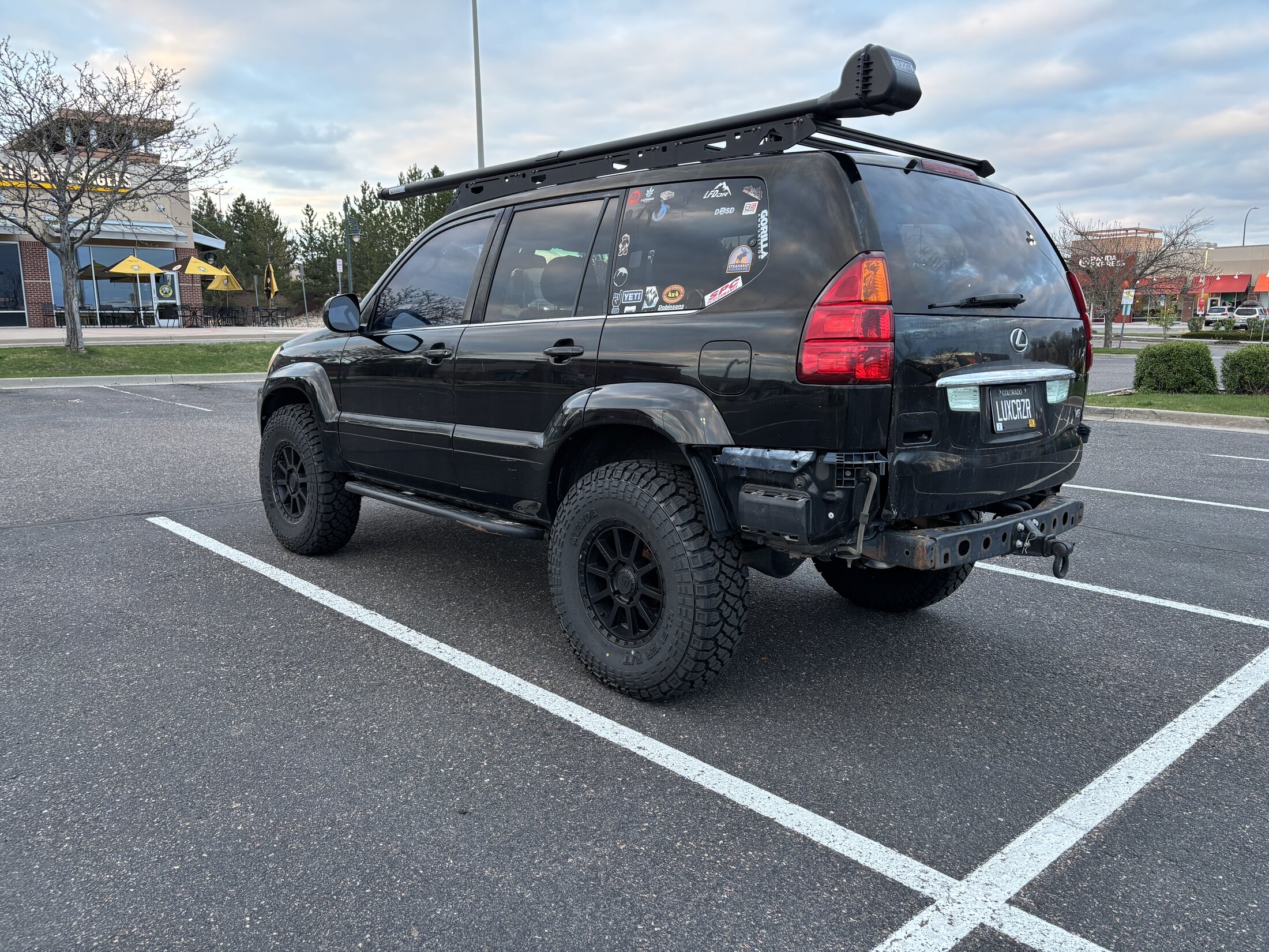

Rear bumper cover delete
- Over a year of offroading with the bumper cover deleted and just the crash bar and I still think its the best option clearance wise. Running just the crash bar with high clearance hitch has solved almost all of my departure angle issues and I barely scrape even with undersized tires. Im not sold on the heavy steel bumpers, if you need a steel bumper I think the lowkey custom single tubes are a better option> Rear bumpers are exensive, heavy, and there are alternatives for carrying a spare. Looks are subjective but i think most of the rear bumpers are ugly. I think there is more use case for the front bumpers but still not sure if I will ever get one since I'm aiming to keep weight low. Might have a better idea if I want one once I upgrade to bigger tires. I just feel hesitant because ive been seeing a good amount of people posting about how they didnt think the steel bumpers were worth it long term.

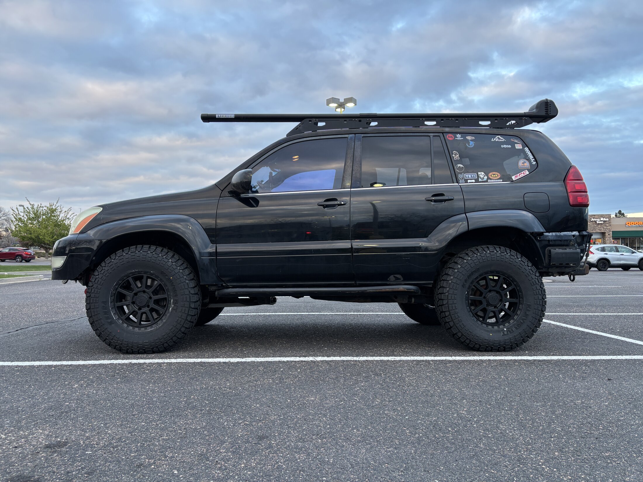

To continue off my last post my plan for 2023 is to put the gx on 35x10.5r17 tires. My original plan was just to put the 4runner wheels on spacers. I decided to give these 0 offset alpha equipt wheels a shot since they were on sale.
Mounted the wheels with the 265/70/17 since I don’t have much space to store them. Have some projects I need to knock out before 35s so will be awhile til its time to put them on
Got back to working on the gx after some time off. Got the 35x10.5r17 kendas mounted. Cut body mount and pinch weld. Trimmed the front bumper some more and moved the fender lines. Got it to drive on the street with minimal rubbing.

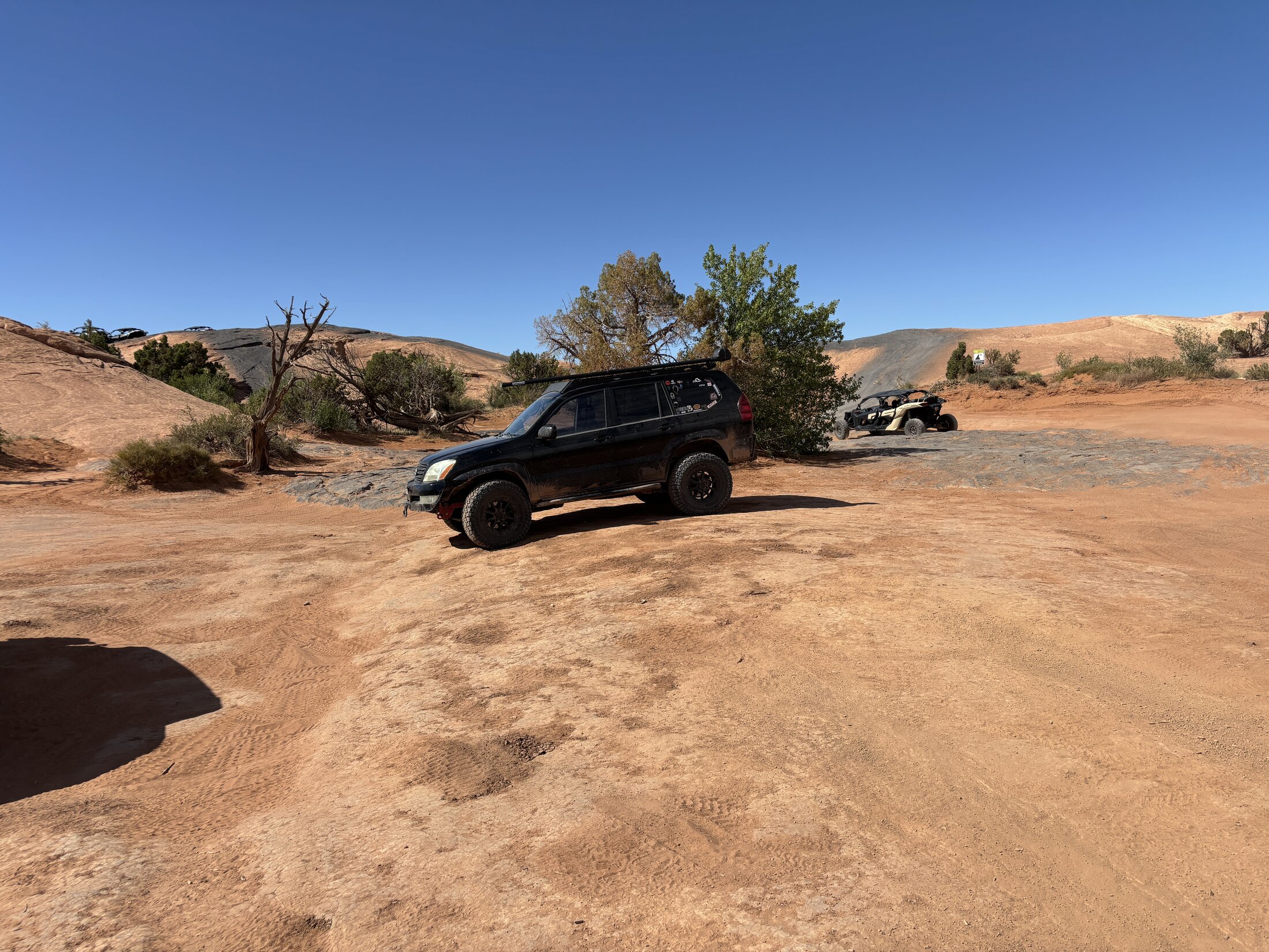

Took the GX470 to Moab for a shakedown run on the new 35” tires. Overall was very pleased with how the gx performed. Clearance and navigating over obstacles was a lot better. Front end had a good amount or rubbing that i will need to clearance some more. Ended up grenading the stock 8” rear differential on the third day of a trip.
Pictures of the grenaded rear third member. After blowing it up we removed the rear driveshaft and drove it out of the trail in FWD. Got a tow back to town and then got the ring gear removed from the rear diff. Drove six hours home in FWD without issues.
