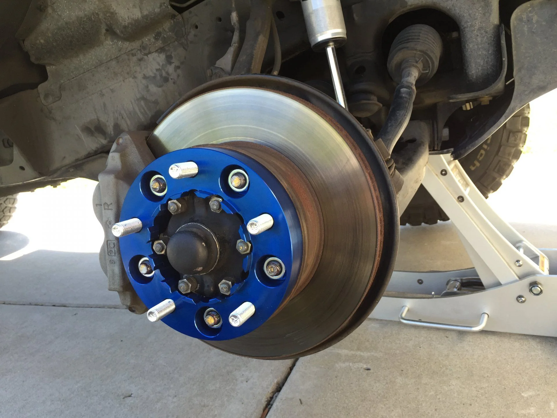

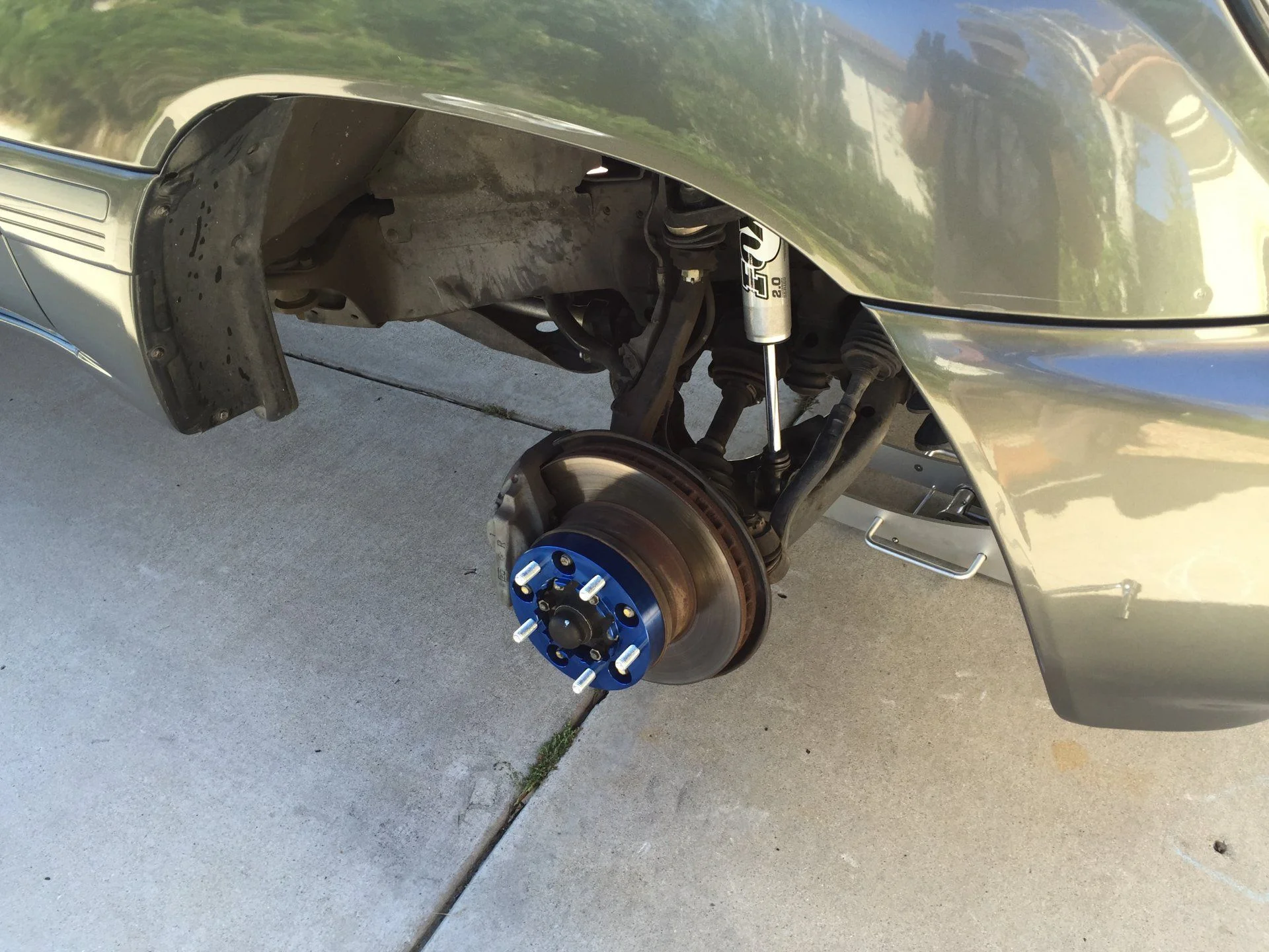

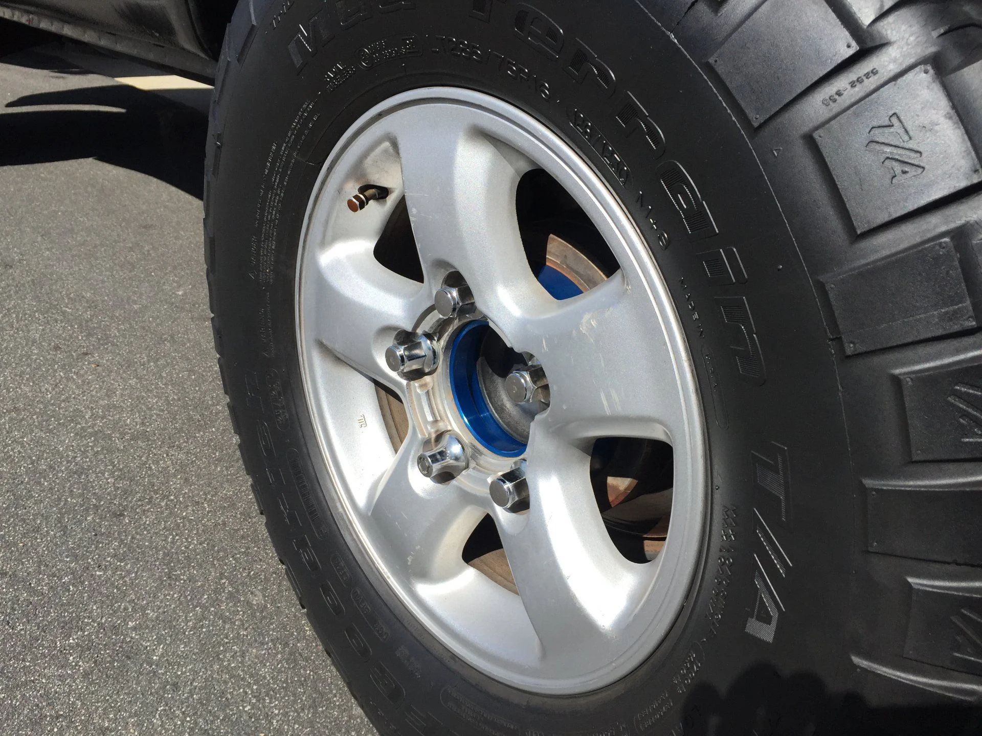

(Have to post these in multiple posts because some weird error on my ipad)
