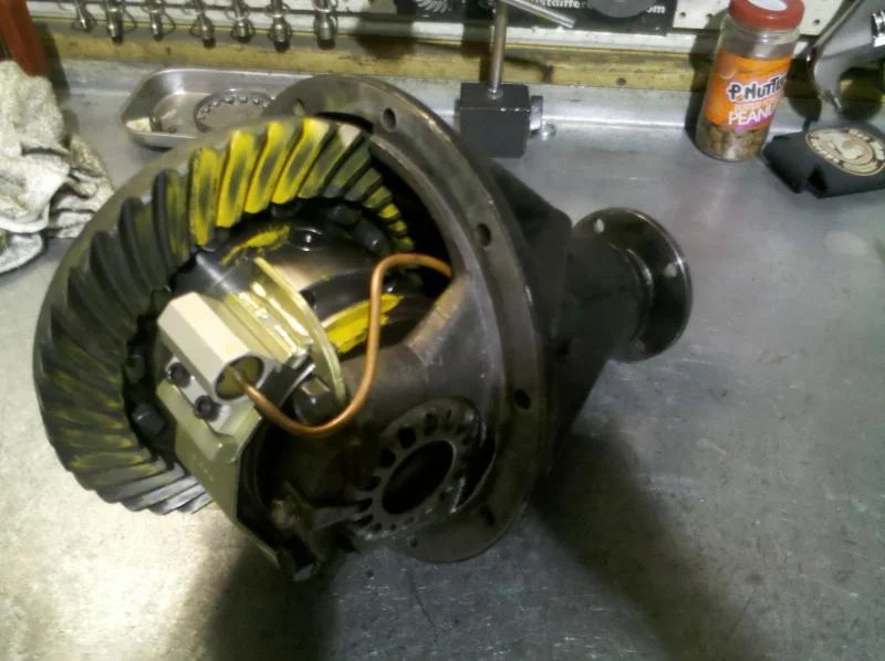

The TJM Lockers are fantastic units. I really really like the fact that the acuator is a piston bolted to the bearing cap, so there are no seals inside the locker or o-rings that require removal of the diff IF it were to leak. Also there are no spinning parts that are also sealing Air.

I do agree that the o-ring set up is screwy, but my first ARB's lasted many years before they went out and it wasn't a show stopper, the lockers still worked. The internal o-rings are still original, probably 12 or 15 years old.
That said I like the looks of the TJM design much better, it seems much less prone to failure.
