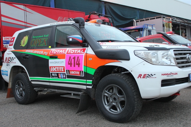

One feature of the Safari that is not on the TJM is the ability to turn the "scoop" on the top of the snorkel so it faces backwards. I read that this is important when driving in heavy snow or high dust conditions - the backward facing scoop would not clog up with snow, and would allow ingestion of less dust than a forward facing scoop. I have also noticed that all the Dakar-prepped LC's have a snorkel intake facing the rear of the truck. Although I do like the look of the TJM snorkel, I would not be comfortable with that air intake that is always facing forward.
Just my $0.02 :p
