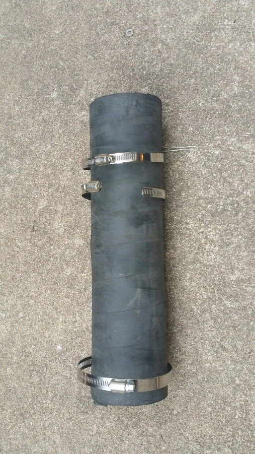

  • Tube between intake box and snorkel is about 2" too short...I guess I'll email the seller?

This Tube is too Short, and Had to buy an extra clamp

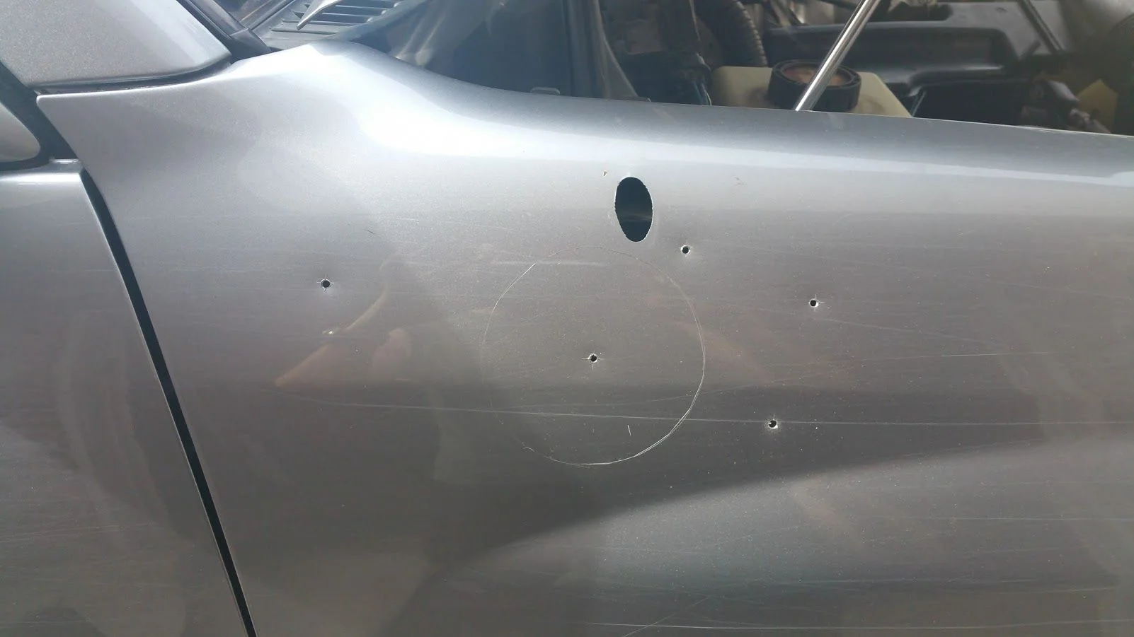

Used a razor blade to transfer the template to the paint

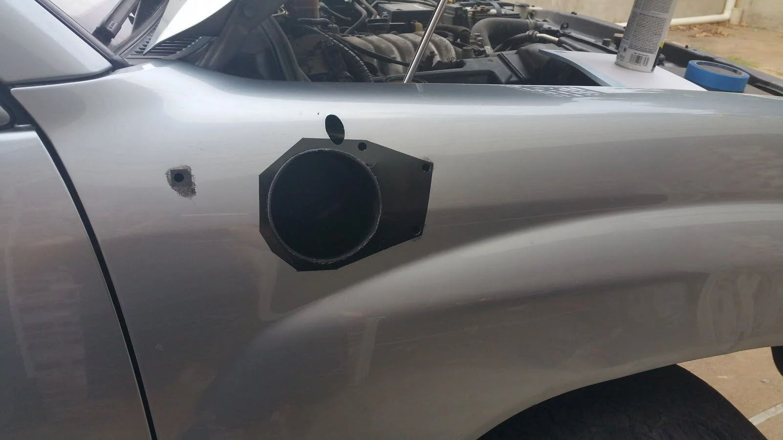

Used Step Drill and Dremel to cut, then a 1/2 Round file to clean up
Test Fitting the Inner Snorkel Box

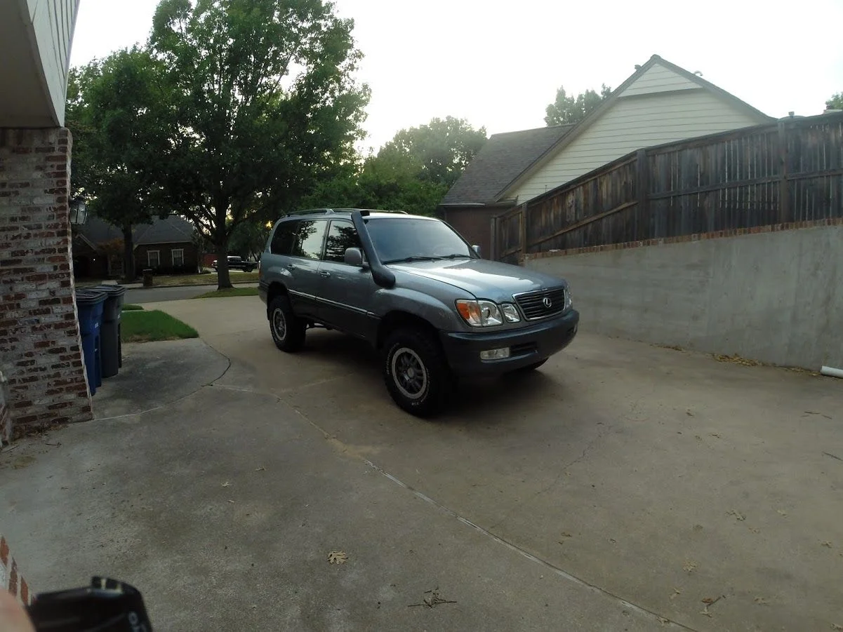

FRONT
3/4

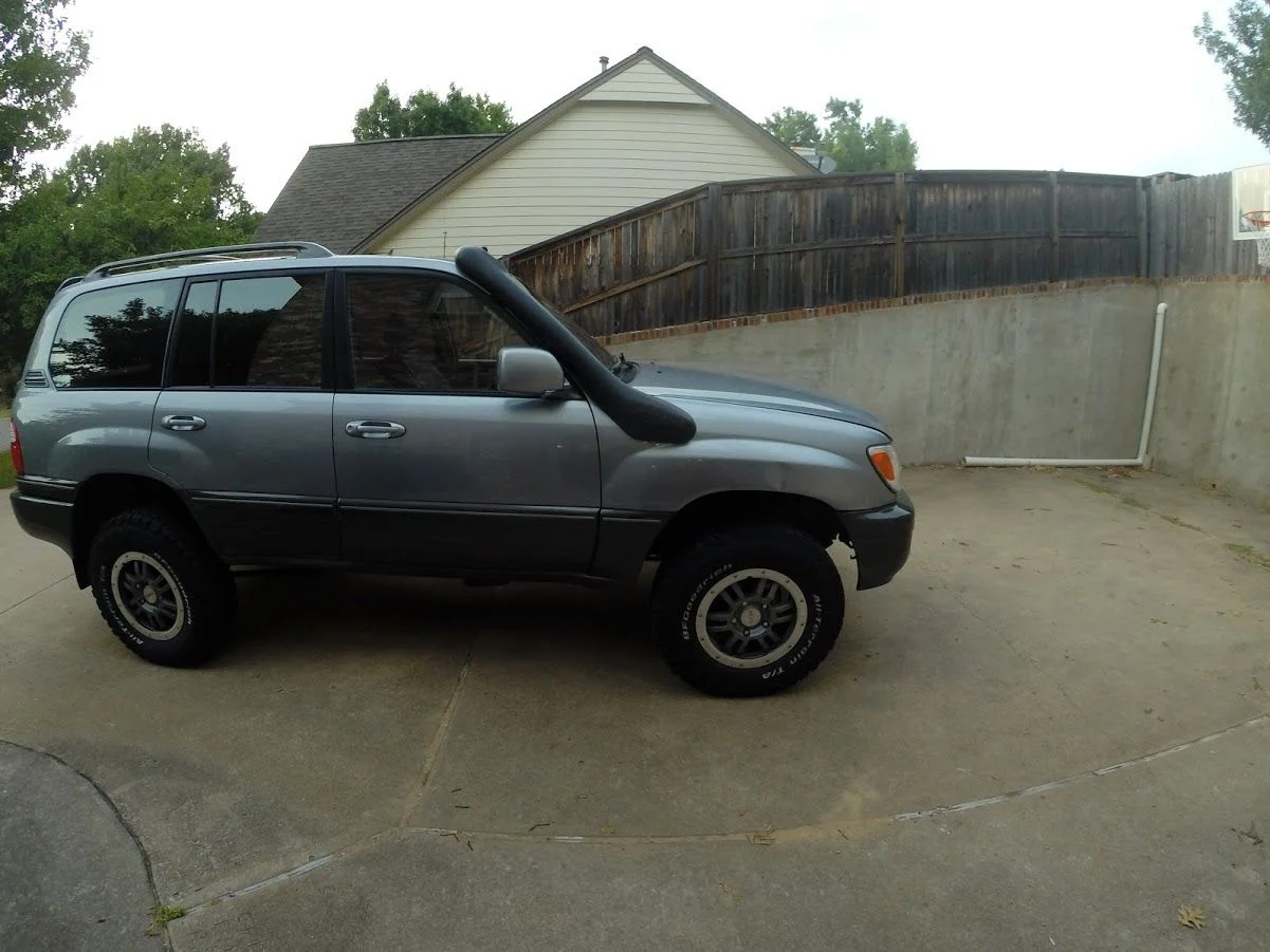

SIDE

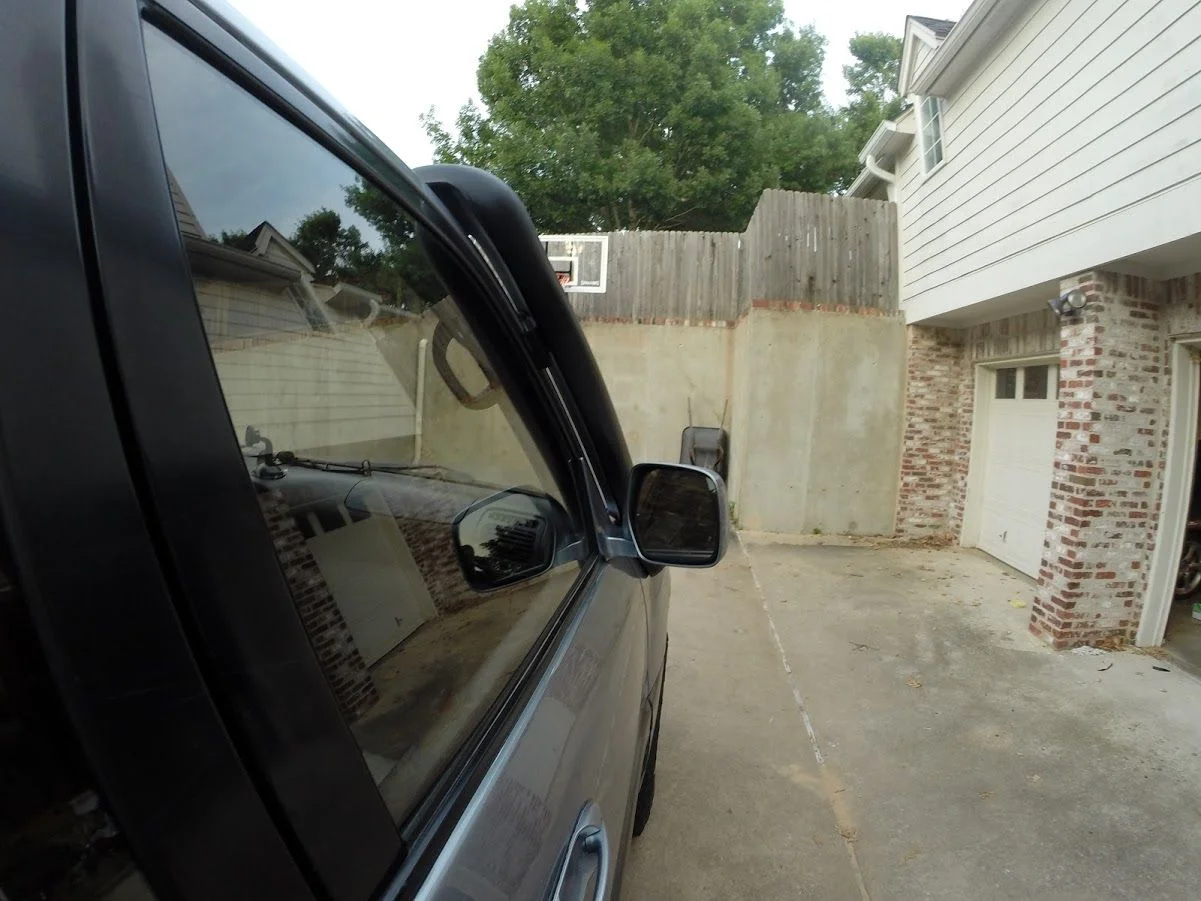

Pillar

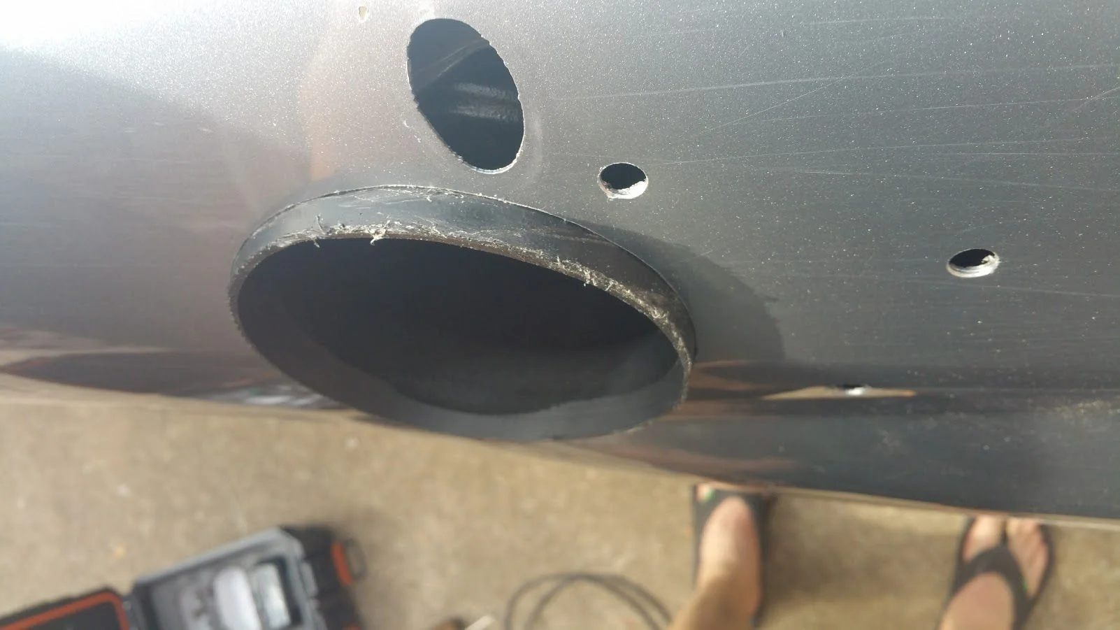

It seems to have more to do with where the hole in the fender and the tubing needing to go through the fender there than the interference of the outer snorkel, right?
Correct. Exactly. Maybe you'll take
Your time and get it to work better than I did but I had a ton of plastic and fender trimming to do. I also hacked up that boxy resonator and had to use parts of it to make the silicone hose go all the way to the filter box intake elbow.
BillZ: nice! Your snorkel head has a gap between the roof and the bottom of the head right? Mine does too. Also, you just have drilled a larger hole than the template indicated to get the inner elbow flange through? I drilled exactly what the template said and it didn't even come close to fitting. I also had the issue of the hose being two inches too short so I used the resonator tube cut it and that did the trick.
