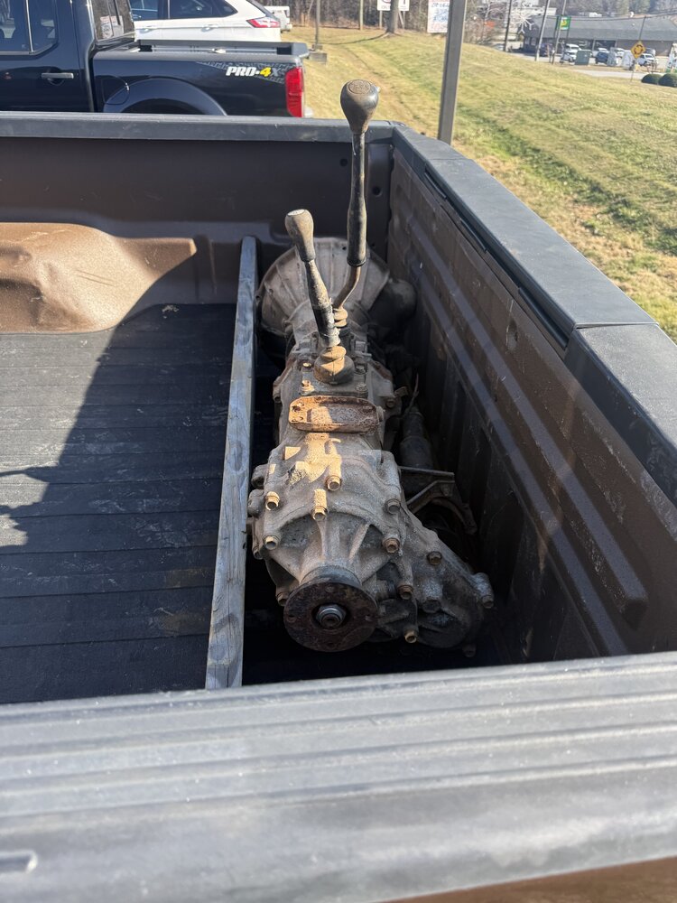

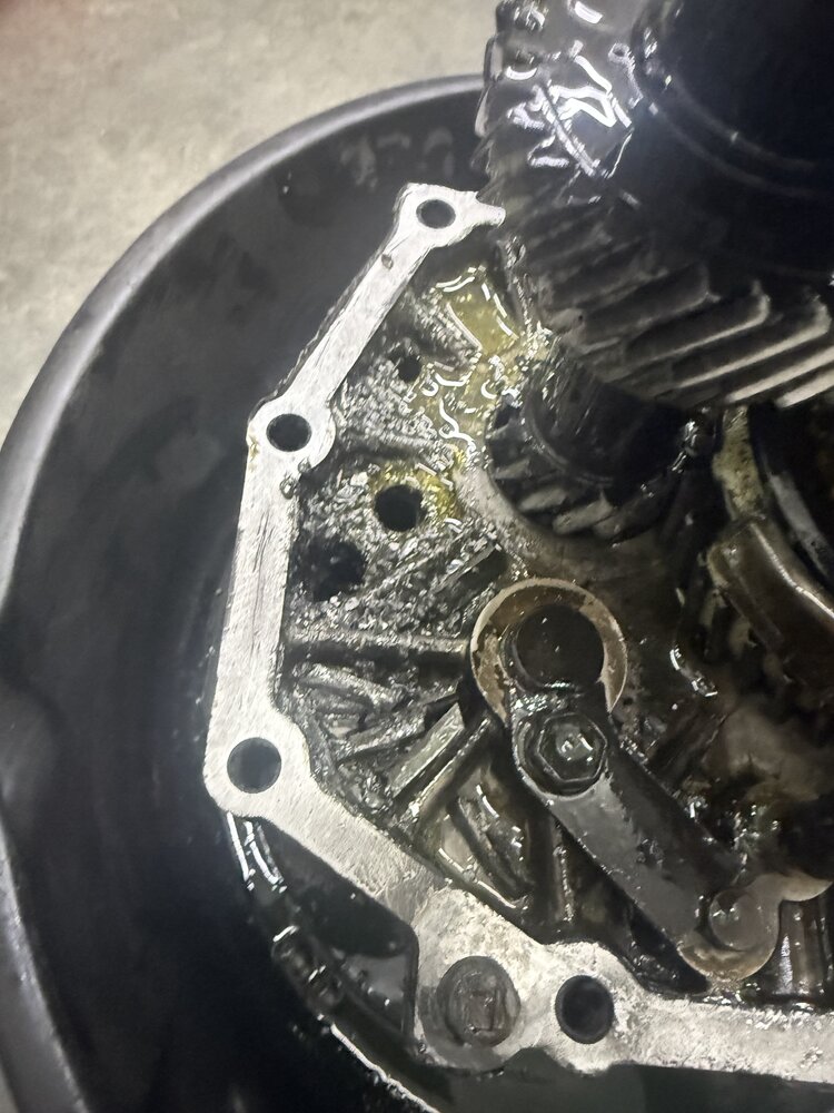

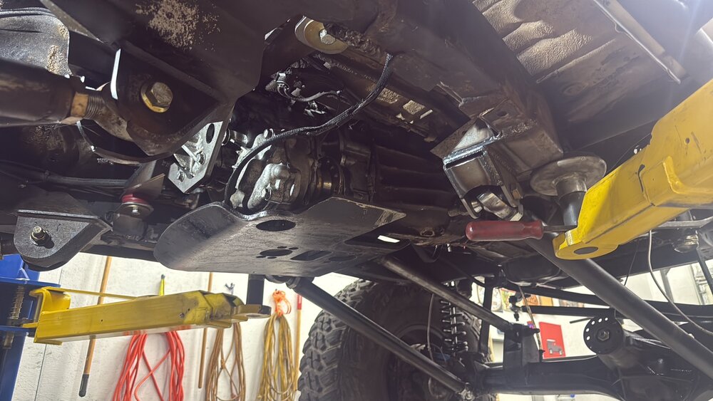

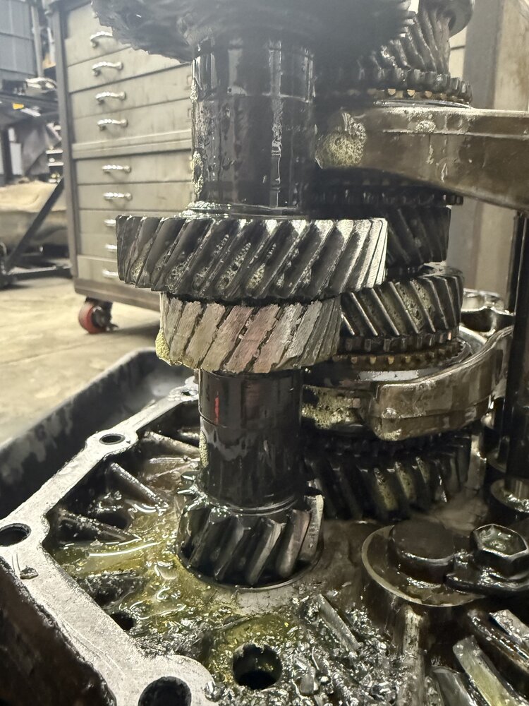

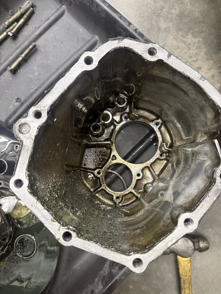

Smooth sailing till it wasn't, Was on my way home from work the other day and barley got into the throttle and went to shift into 3rd to hear the most gosh awful noise I've ever heard a truck make. Was 100% sure i lost a rod out the block, thankfully it was just me loosing 2nd gear. it still drove so i kept on trucking to kroger, went inside and came back out and made it about 400 yards from the parking spot for it to transform into a automatic and every gear was park lol. Brought it up with me up to NC for a 4 day weekend so i could swap out the transmission. Got it apart this morning to investigate the carnage. I'm genuinely impressed with myself on this one, time to hang it on the wall in the shop.
New to me trans is in, drove noise free for 5 miles then 3rd gear started yelling at me, must be the super tech oil I put in there. I’m going to rock it till it goes again.
Well, it lasted 3 weeks and maybe 250 miles. I was driving back from the gym when 3rd left the country. I was playing around with a new edge at a light, did a hard shift from 2-3 trying to keep the boost up and I knew it was going to be too hard of a shift but I didn’t have enough time to tell my foot not to let out the clutch lol. I was winning till I wasn’t. Drove it home without 3rd and have been thinking about my options.
