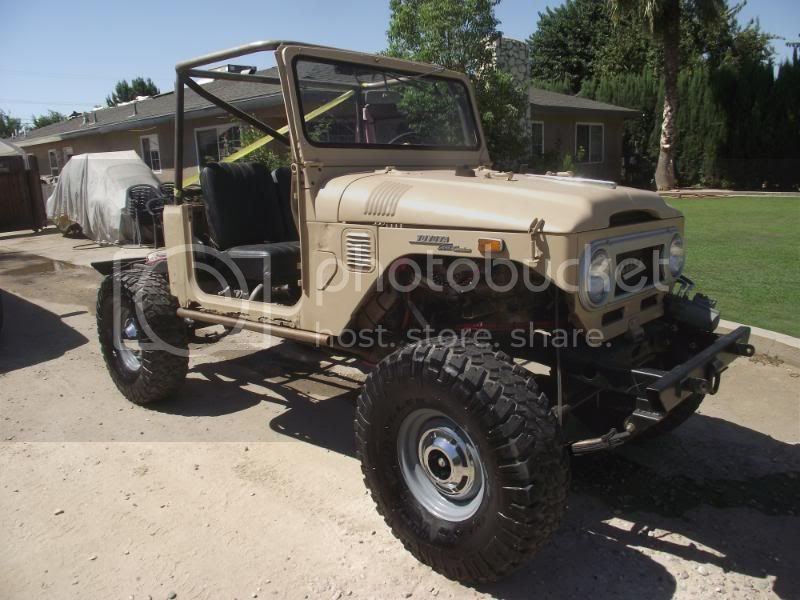

I daily drive my rig on stock stealies (5.5" wide) with 35/12.50/15's. Its V8 powered and I'm an agressive driver. I have never noticed a handling issue or "rolling" of tire bead on or offroad. Find a different tire shop.
wow
Do you have a picture of those 12.50's on a stock steelie? Sounds like a bunch!
This the best shot I have right now. I need to upload some more.
I drove for two years on 32/11.50/15's on stock steelies, Hwy. speeds, off road, snow, mud etc. never had an issue. I'm now spinning 31/10.50's that that make it feel like I have power steering. I don't have any problems at all with the 10.50's. First pic. is the 32/11.50, second is 31/10.50.
