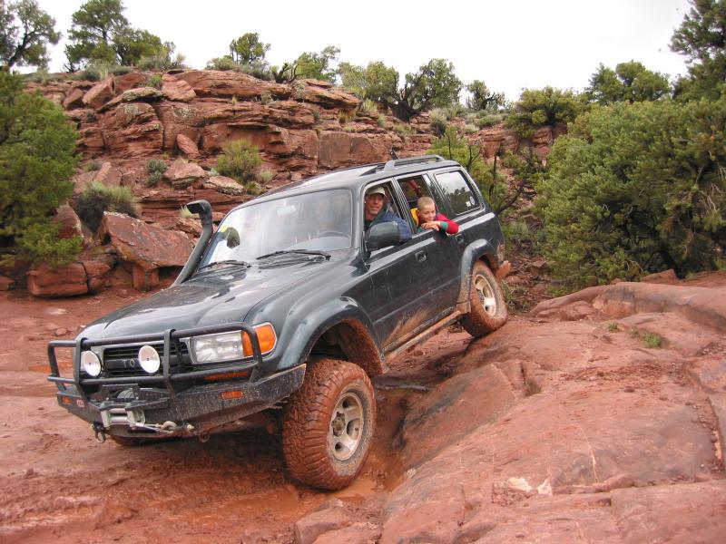

Are we really allowed to have a *eep picture up here? :flipoff2:
Well, the first post said "I am looking for an aggressive all terrain tire or a moderate tread mud terrain." The MT/R fills that perfectly. As an owner of MT/Rs I would challenge the MT/Rs suck in mud mantra. They are no Super Swamper but I am not interested in mud bogging anyhow. I have never been stuck in mud witht the MT/Rs.
JMHO
JMHO
