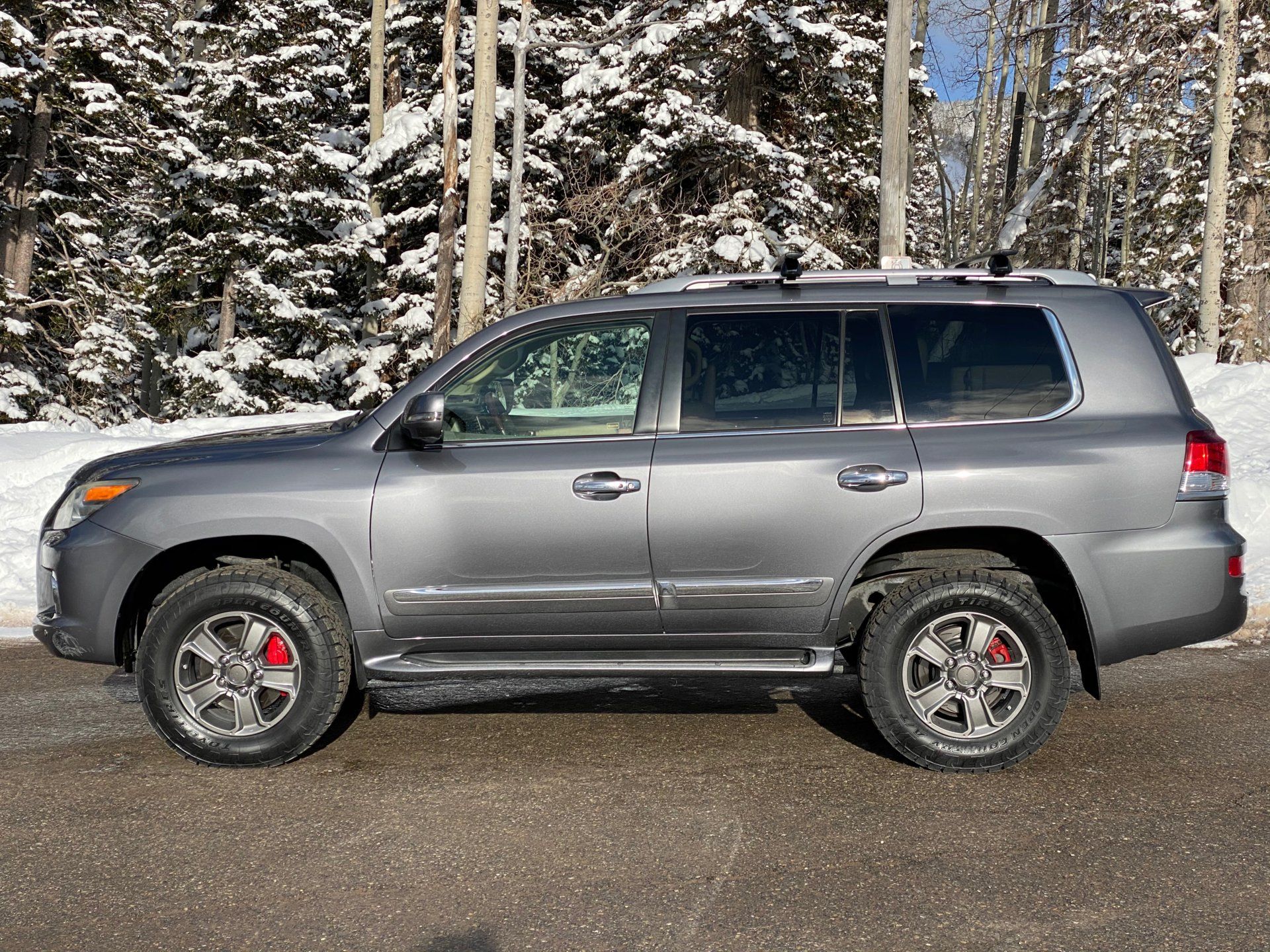

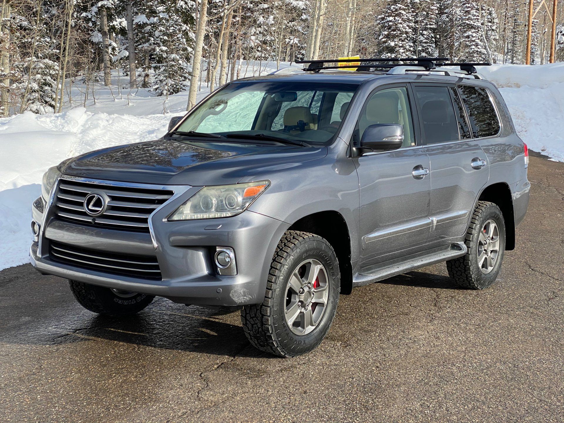

Ready to pull the trigger on tires. In the end, decided to ditch the 20" stock LX570 wheels altogether and go with 18s for my DDs. Between the extra stiffness of the E rated tires I'm putting on, and constant reminders on our recent trip to Goblin Valley of the inadequacies of 20" rims for even light off-roading, the extra sidewall should pay dividends on-road and off.
I'm going to take a risk and try out the new Toyo AT III in 275/65R18, mainly because its the lowest weight in an E-rated tire that size, should be a good DD with decent off-road capability, and well, it's new! :) If I don't like them I'll take advantage of their 45-day guarantee and replace them with the Cooper AT3 XLTs (in 285/65R18). I'll let you all know how it goes!

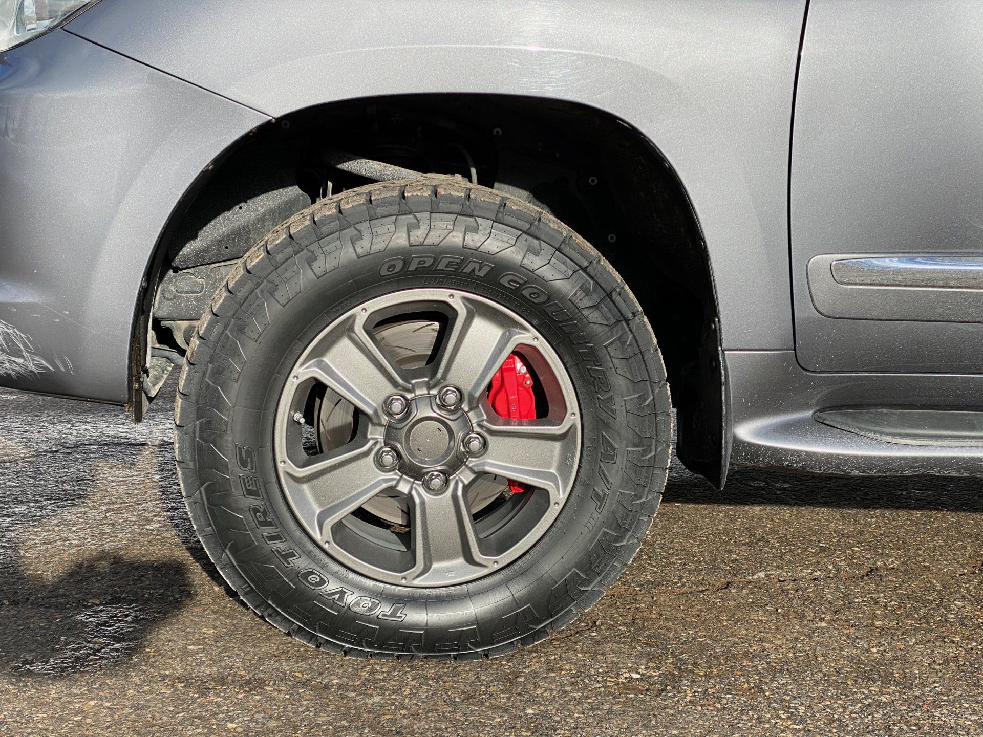

Some pics of the Toyo Open Country ATIIIs in LT275/65R18 (32") on the LX570 in High.
Showing how "low profile" the sidewall lugs really are. If you want a really aggressive look, ala KO2s, this is not the tire for you.
