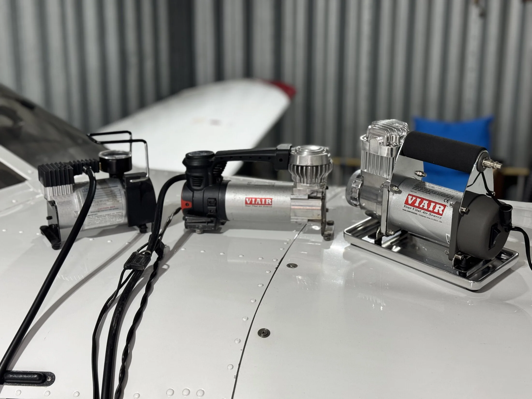

I had a few minutes to spare, some beer and three different tire inflators. VIAIR 073, 088 and 30033.

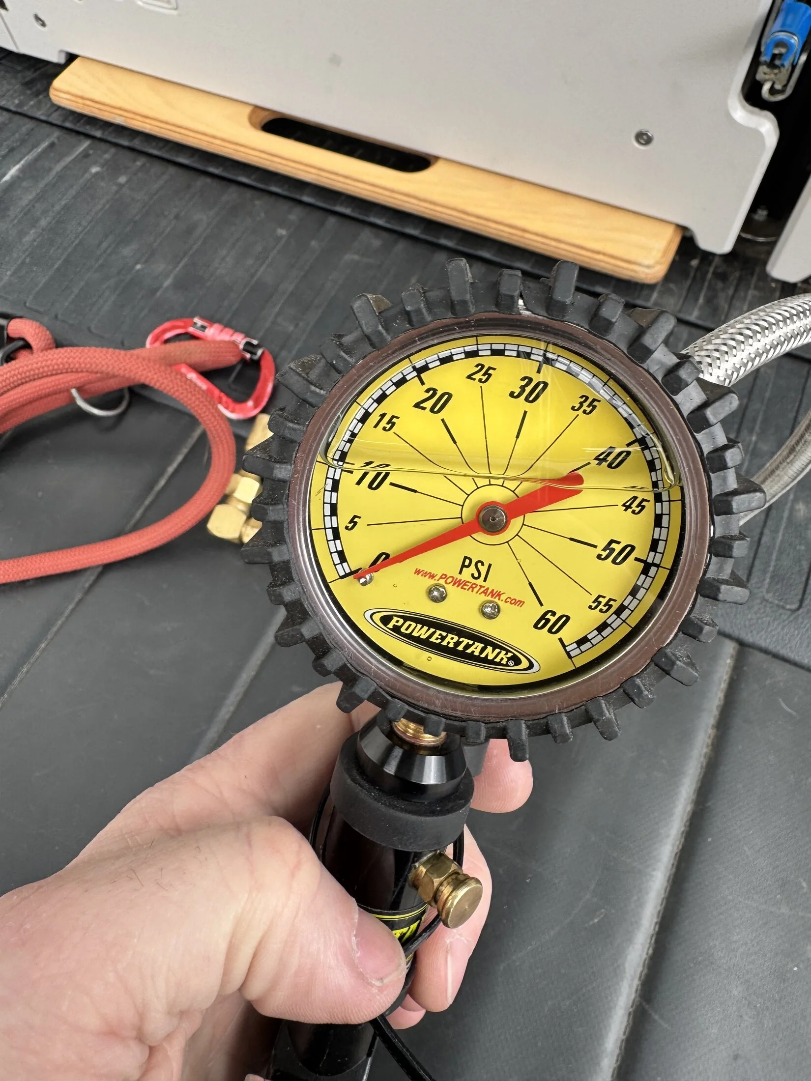

Tires were all identical KO2 285/65/18, deflated to 15 PSI as measured by a decent analog gauge. Target pressure was 42 PSI. Power supplied by a 30a DC switching supply.
Results:
Model 073:
6 minutes 29 seconds, 12.2-13.7 amps.
Model 088:
4 minutes 0 seconds, 19.3 amps
Model 30033:
2 minutes 59 seconds, 23 amps

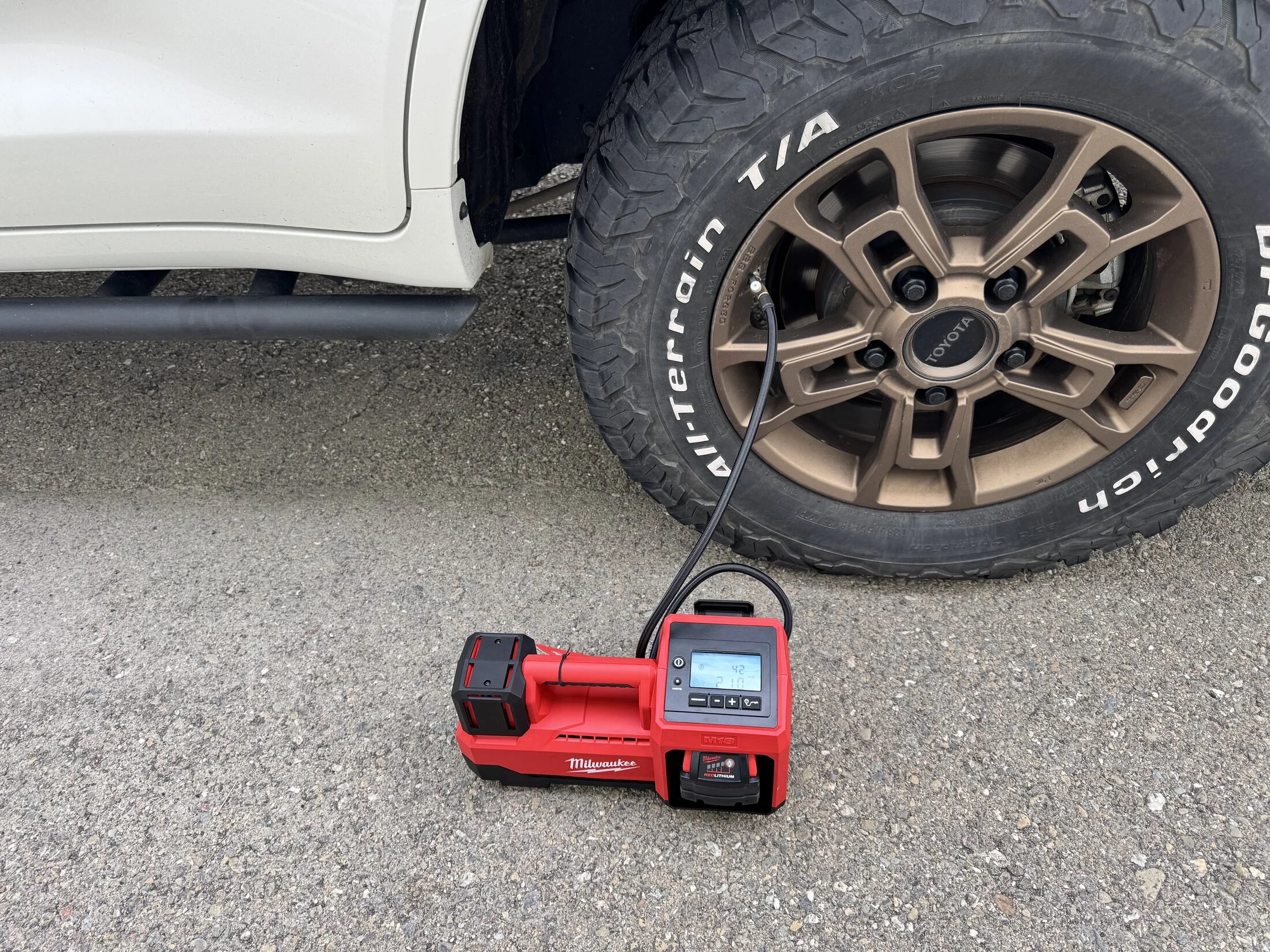

Added in one other option which turned out surprisingly fast with the same inflation parameters:
The Milwaukee got the job done in 3 minutes 5 seconds. Battery still indicating full charge- it’s the 5.0 Ah M18 XC. So nice to have the pressure preselect feature.

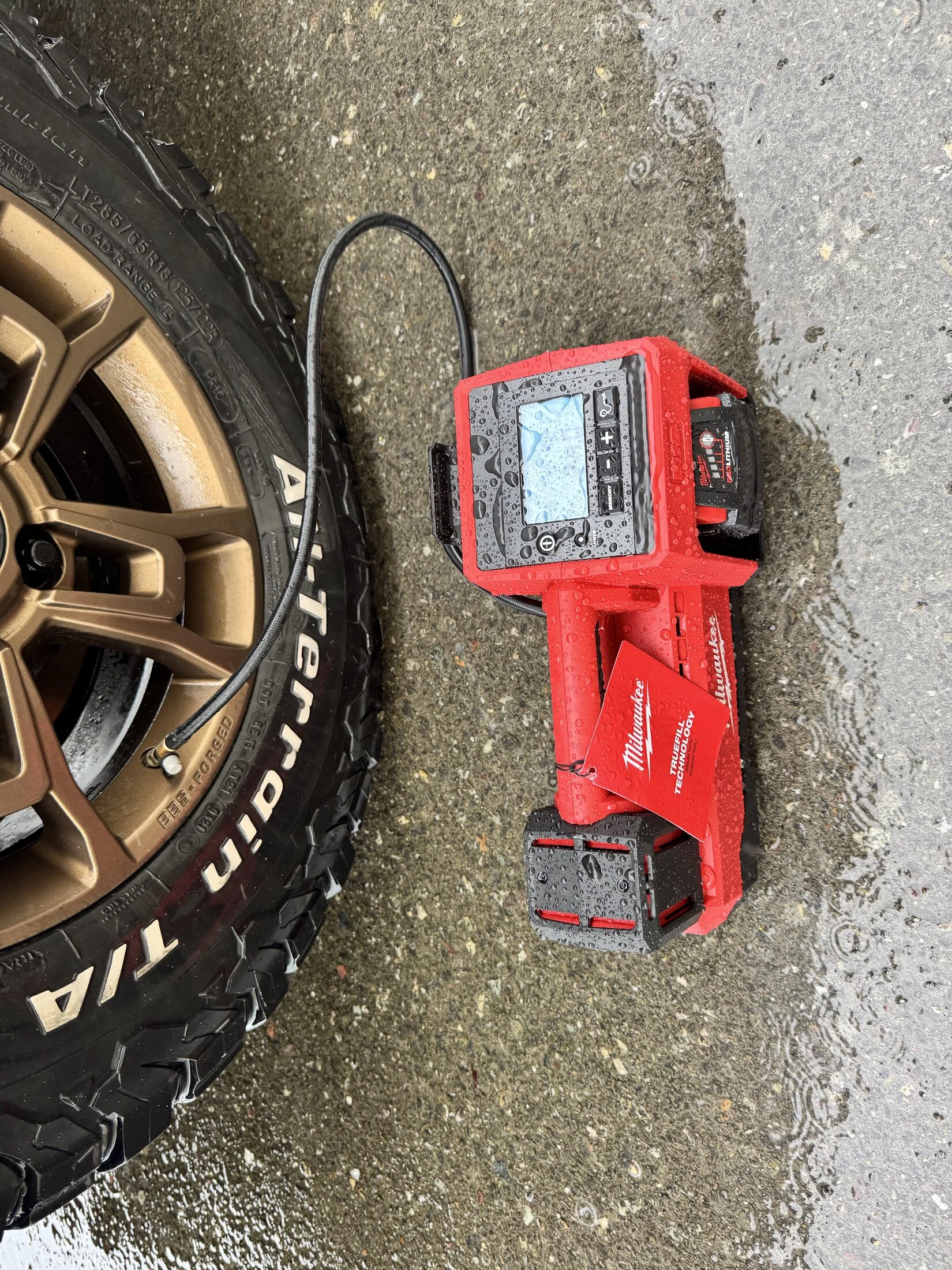

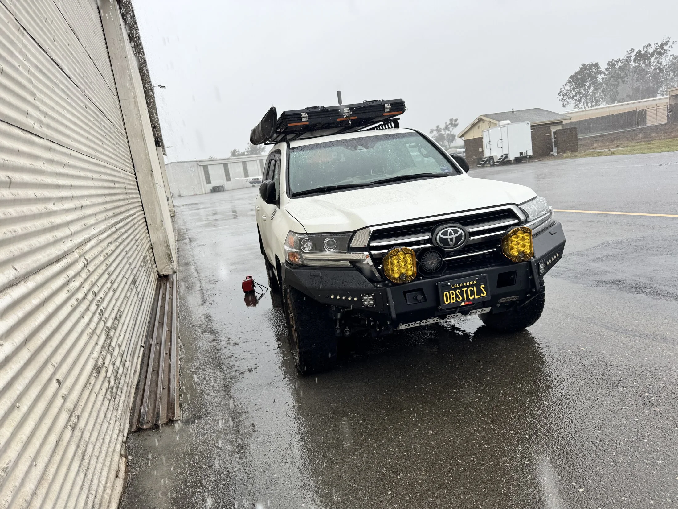

In the interests of science- and beer- I decided to investigate the Milwaukee further. I ran it through a series of inflation cycles to see how many times it could take a 285/75/18 KO2 from 15 to 42 PSI.
Did I mention it is extremely wet and definitely not flying weather here?
Anyway, the M18 inflator with a fresh XC5.0 battery took a 285/65/18 KO2 from 15-42 PSI 8 times, and the 9th attempt crapped out at 29 PSI. The spec for this battery is 5.0 Ah at 18V, implying 90 Wh of energy is available. Considering that a single inflation from the Viair came in at 180 seconds, 14.1v, 23 amps so about 16 Wh worth of energy, the Milwaukee seems to be over delivering on battery capacity (16 x 8 inflations = 128 Wh) or is just a really efficient compressor (maybe the active cylinder cooling helps).
Again, all of this is at sea level on a cool day....so the density altitude is low. Compressor suck at high DA, so if you're at 8k feet in the summer in Denver, count on far less performance from any compressor.
And everything including me is very wet.
View attachment 3831883Did I mention it is extremely wet and definitely not flying weather here?
Anyway, the M18 inflator with a fresh XC5.0 battery took a 285/75/18 KO2 from 15-42 PSI 8 times, and the 9th attempt crapped out at 29 PSI. The spec for this battery is 5.0 Ah at 18V, implying 90 Wh of energy is available. Considering that a single inflation from the Viair came in at 180 seconds, 14.1v, 23 amps so about 16 Wh worth of energy, the Milwaukee seems to be over delivering on battery capacity (16 x 8 inflations = 128 Wh) or is just a really efficient compressor (maybe the active cylinder cooling helps).
