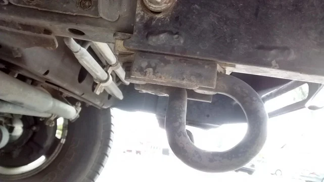

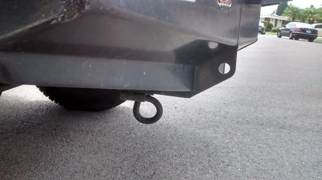

So if I don't have the factory recovery points with my ARB, where is the best course of action to pull me out of the mud? Is a sling on the bumper tubes safe?
Do you have the winch mount version ? I do not have ARB bumper here right now but an Ironman bumper is sitting here so I will look at it later and tell you the way I would recommend to hook up a chain or a strap to it for a safe recovery.
I do have a winch. But what do I bring the hook back to when I'm using a snatch block? Or if my winch quits and I need to be snatched out. I'm not too worried, about it, I could easily figure something out...just seeing what your thoughts were.
Is this what you are talking about? The lower mount?
