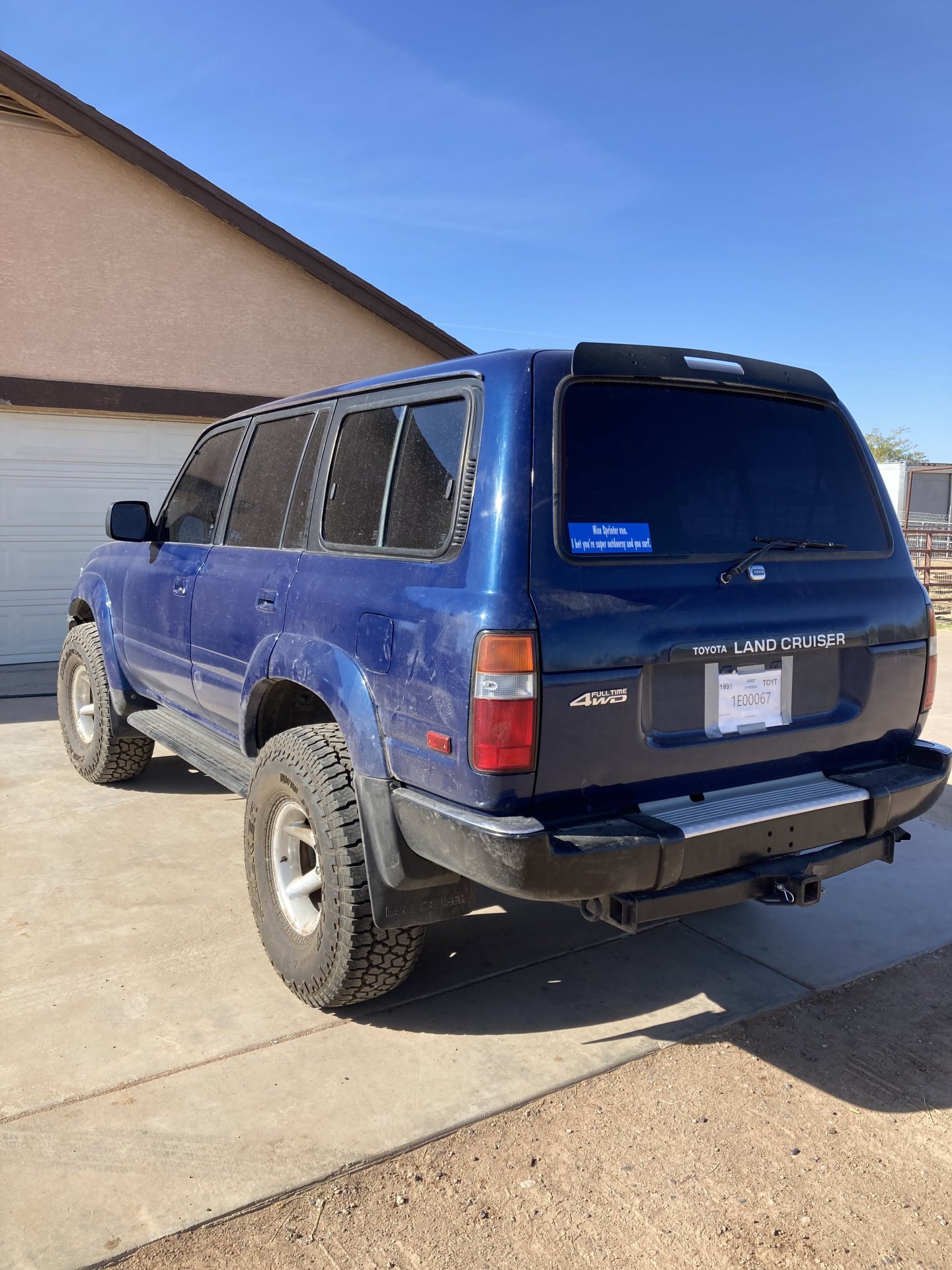

Looks like a 91 from the tag on the back.
That's a 3FE, so he's "special".
