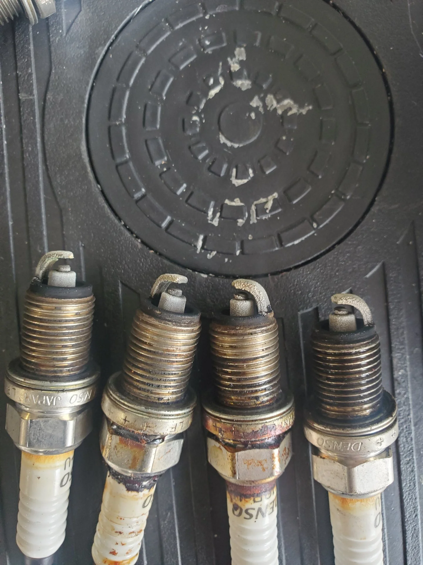

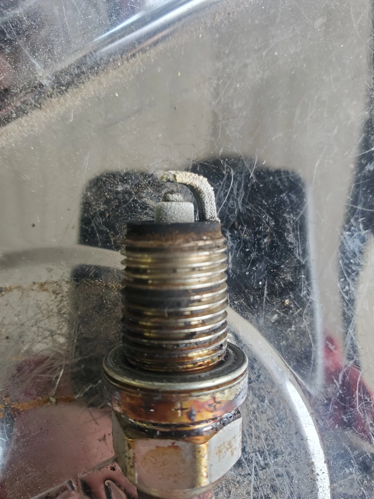

First I pulled the spark plugs this is what they all looked like...
I replaced them all with OEM
Need some feed back on what's possibly going on with these.

There might be more too it but the spark plug page of my Haynes Repair manual points to hot plugs, which is a fairly unique symptom with the white blistering.

Those plugs may be ashy from oil consumption. The most common source of oil consumption with these tends to be valve stem seals on engines where they haven't been changed in a long time. There could be other causes for the ashy deposits as well as other sources of oil in the combustion chamber. A gunked up combustion chamber won't typically cause noises but can contribute to pre detonation / pinging when running hot and hard.
Those plugs are all pretty old, as shown by how eroded the electrodes are. The electrode top starts off flat with sharp edges all around and yours look like they've been run far longer than the recommended interval. That wear essentially increases the resistance in the circuit and can cause misfires and hard starting when it's humid or the fuel mixture is too rich, etc. New plugs should help the engine run better :)

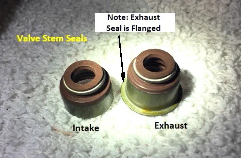

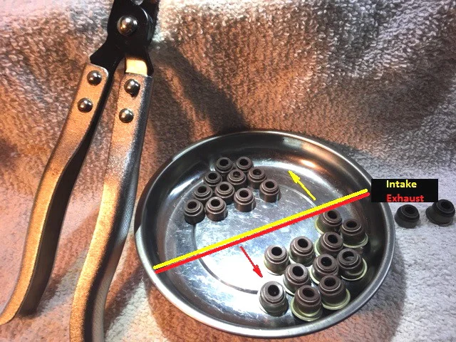

Recommend having the seals on hand (intake and exhaust seals are the same I.D. but exhaust is a larger bonnet).

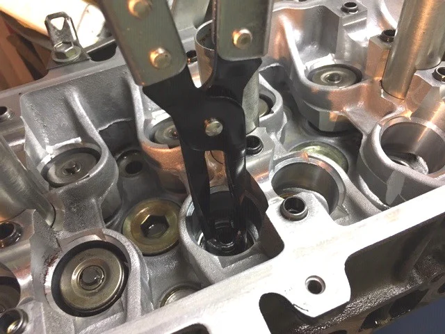

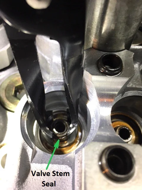

Purchase a 'good' pair of valve stem seal pliers and eat your wheaties before removing them. They are likely rock hard and don't just jump off of their seats. The new ones go back on easily though. A lot of oil gets past Old Valve Stem Seals. Typical indication is a white/blue smoke at first start up, then subsides.
