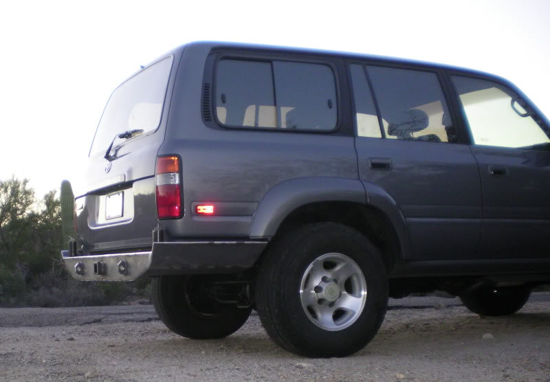

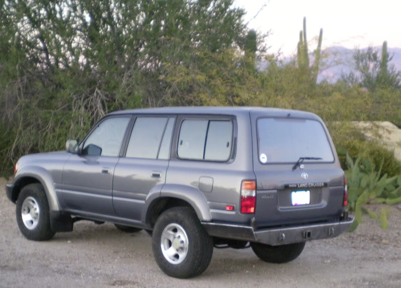

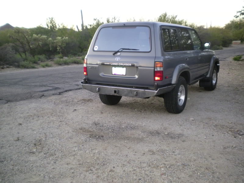

Sorry about slacking on the postings:D Here are a few shots with the recovery points and receiver mounted.. I am going to be adding some "nurfs" on the side for 1/4 panel protection but this will be done on a bender so really is not a DIY type thing:whoops: I will post some better pics later..
Welded in some end caps..
Looks awesome! Do you have some better pics / info of how you added the reciever?
I think I might just have to copy your build.....I think it looks great! It fits perfect. With some paint it will look very sleek for sure. Thanks for all the measurements.
OR.... He can start building them for people! Place your order now folks... :D

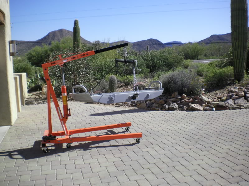

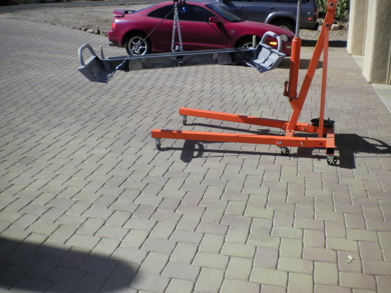

Cleaned up the frame
One coat of paint but its raining today so no 2nd coat today
