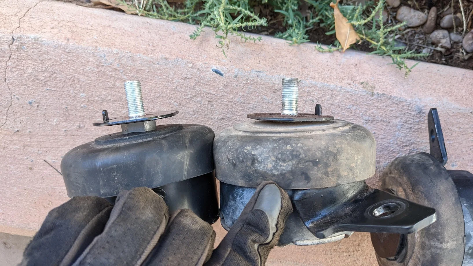

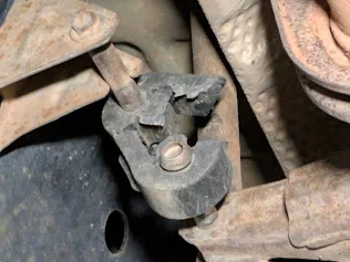

if you go OEM manifolds replace your engine mounts and check all you exhaust hanger isolators. Things pack out, stretch or break causing additional stresses on the poor mani rail design. Replacing your engine mounts and checking all your exhaust hanger rubber can help those new manifolds last a decade instead of 14 months b/c riding on packed out mounts...
Engine mounts/isolators: new left, old right
broken exhaust hanger isolator (under passenger side)
