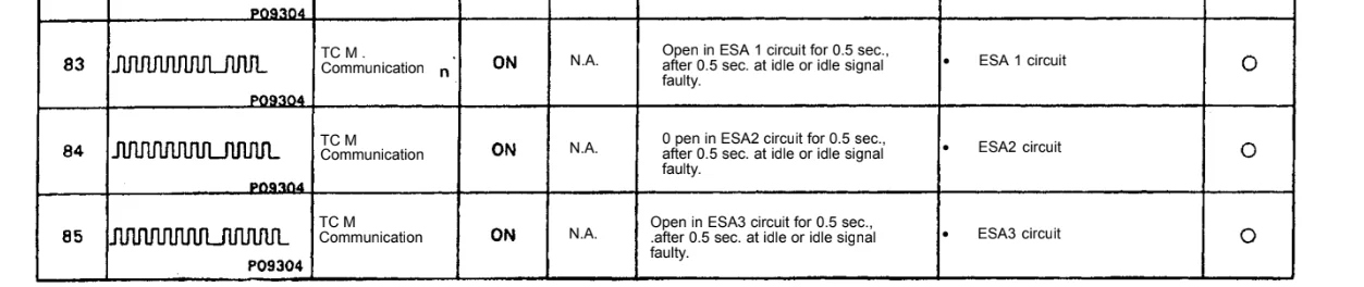

I'd recommend clearing the codes and see which ones come back. The 83/84/85 codes point to an issue with the ECU.

Codes 83, 84, and 85 are related to the Electronic Spark Advance program in the ECM (it's actully in the TCM, but ignore that for now).
Only if I saw any of these alone would I start at the book diagnosis. This is one of the rare cases where you actually have to know something in order to work on this truck (usually, you can cookbook your way through a problem and its solution).
There are no troubleshooting procedures for the ESA circuits. This is probably because almost all the work happens in the ICs and the related wiring, on and off the board. I would first pull the rightmost cable from the TCM (it's under the glovebox, and you'll have to remove that to get at it). Make sure you DO NOT pull on the wires to remove the connector. There's a tab you have to depress to disengage the connector housing. Look for it.

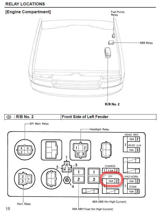

The easiest way to clear the codes is to pull the EFI Main fuse in the engine compartment fuse block. Pull the fuse, count to 15 and put it back in. Now reset your clock.

That's a problem, because pulling the EFI main will clear the codes. There should be at least some time before they return. They should not be persistent and should not return immediately, unless there's a fault in the circuit you unplugged.
