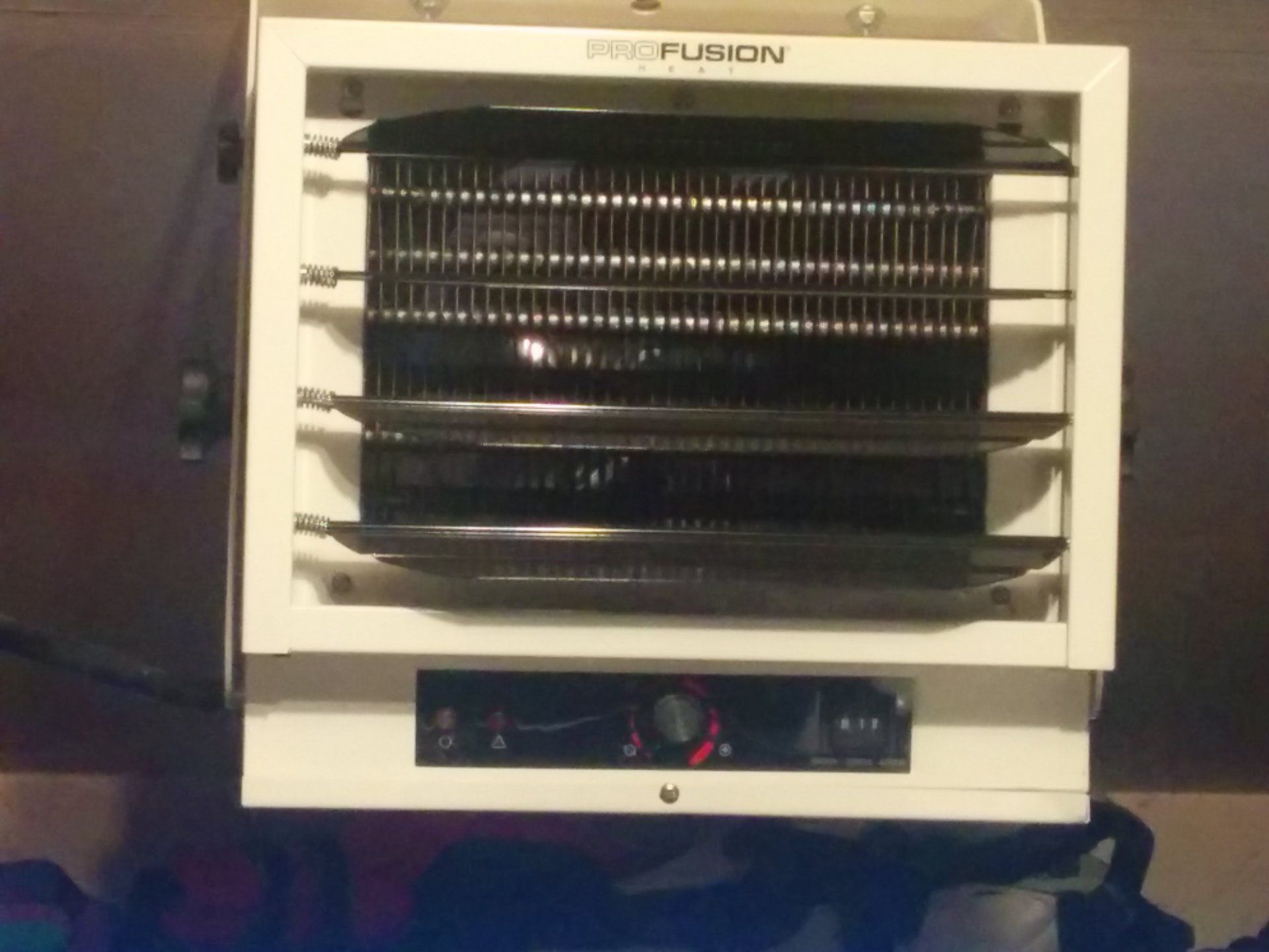

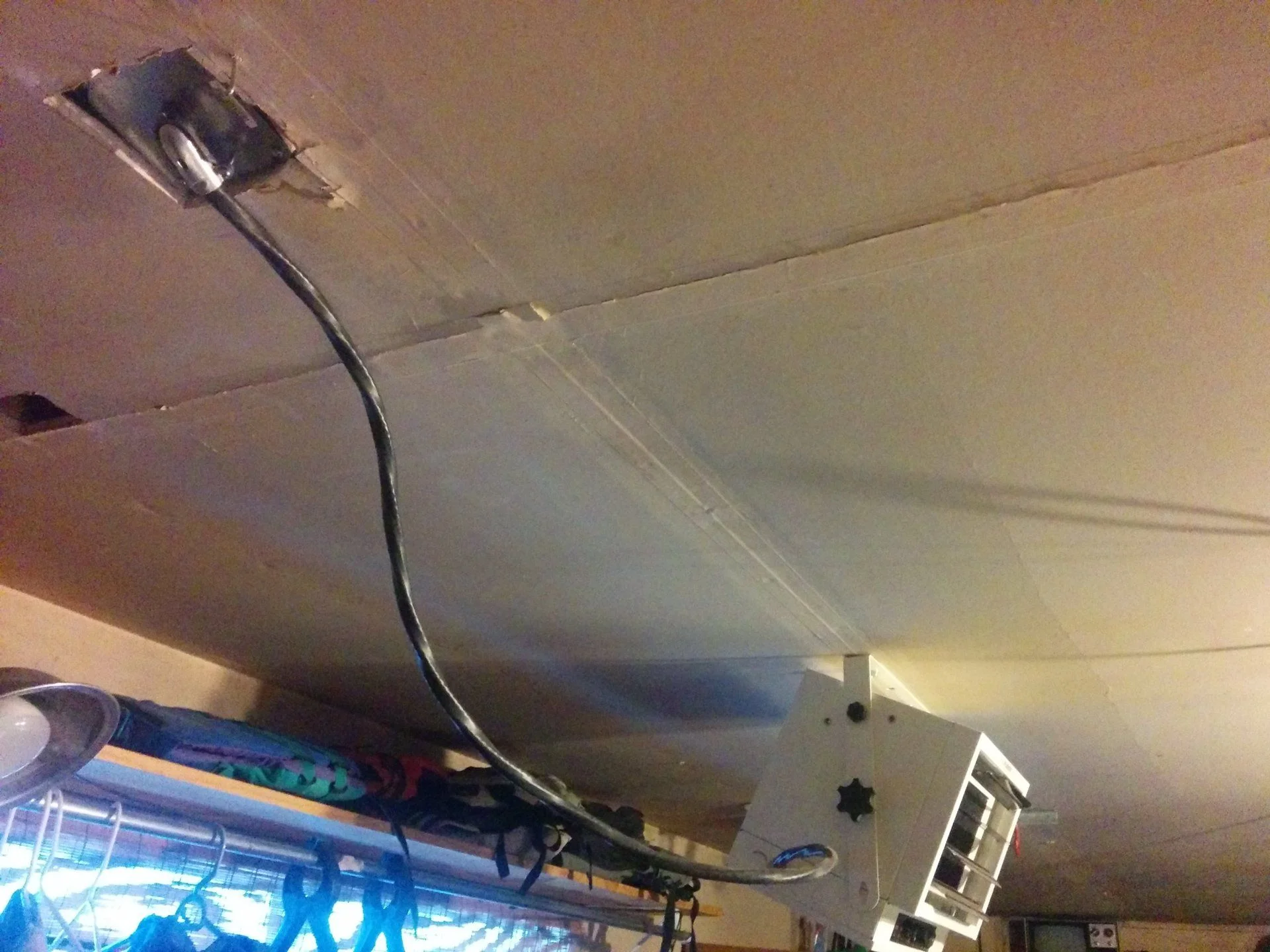

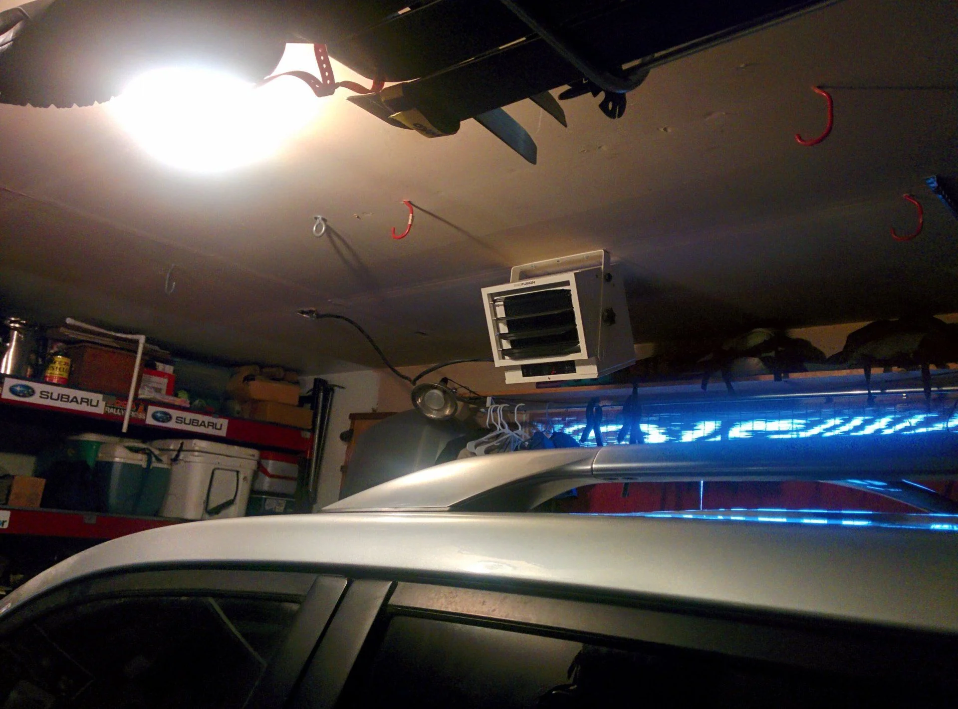

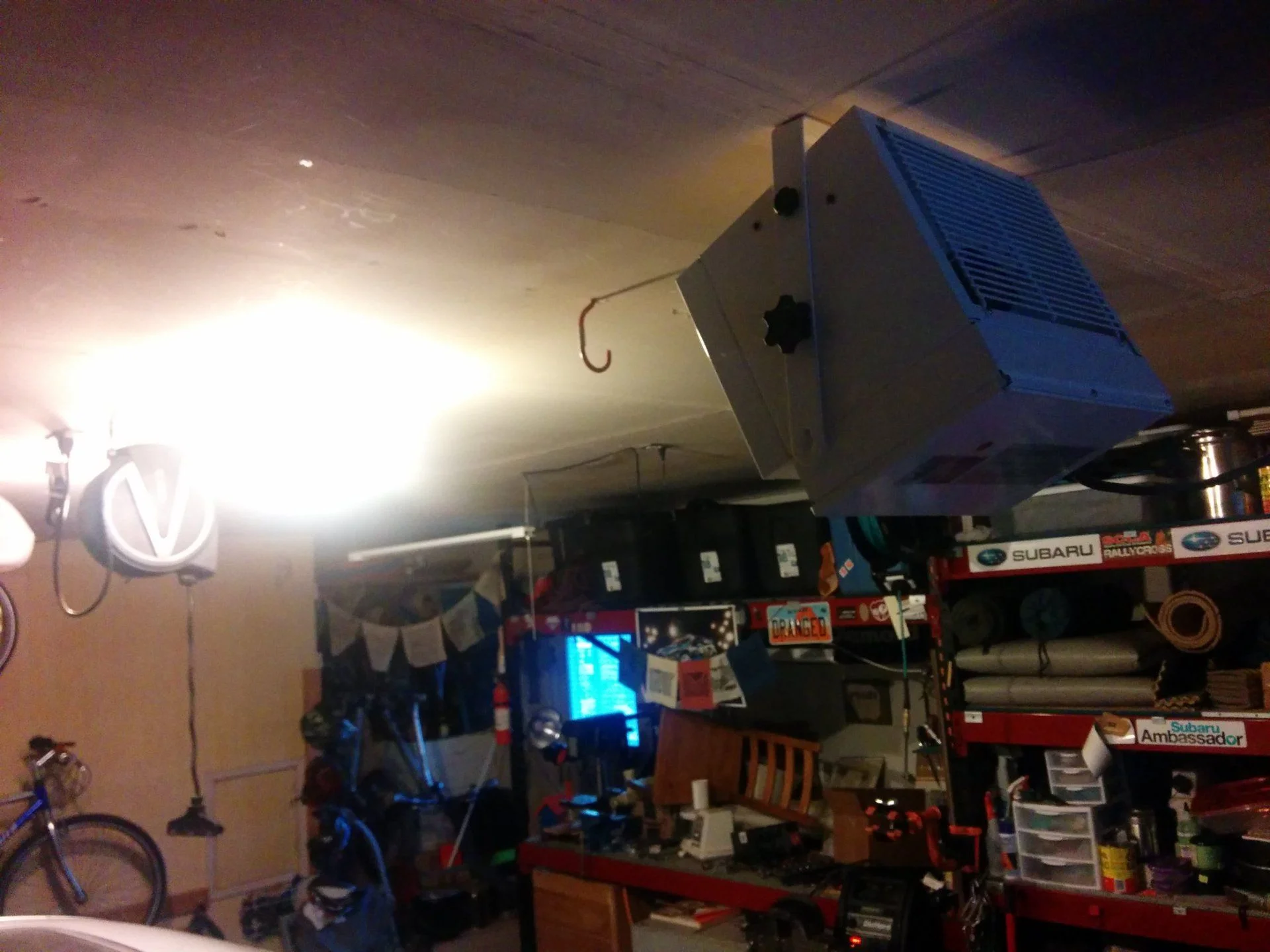

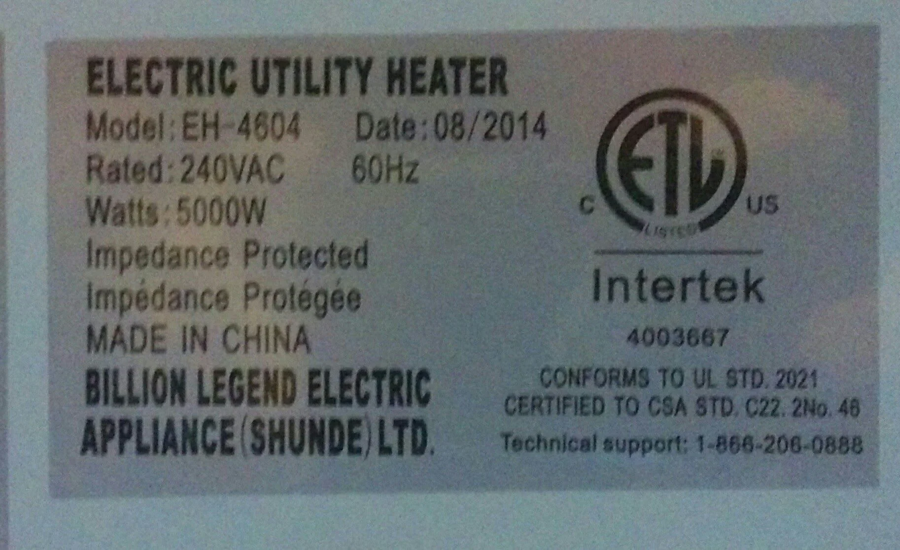

I have a similar unit, was on sale so I impulsed it. I would've rather had gas but those are not easy to come by affordably. My garage is standard 2-car, so not vaulted our high ceilings, This unit is ceiling mounted maybe 2' from outside wall and mid-point on wall. Garage is currently NOT insulated (SE UT, so not a big deal, but it does get to mid-low 30s during the seep of winter IN the garage (overnight outside teens to low 20s). It puts out a surprsing amount of heat and has warmed the garage about a degree per 10 minutes (IIRC) from a quick test last winter...
I added a 30a circuit for it, hard-wired to 240 in a new panel when I upgraded my home to 200A service a couple years ago.
So yeah, functional and good but I'm not running it to maintain temps... I'm mostly just not very productive in winter. . . .
I'll try to dump pix and specs ...

Here's mine, other comment referenced above.
wiring could be tidier, but there's a story there (there always is...)
