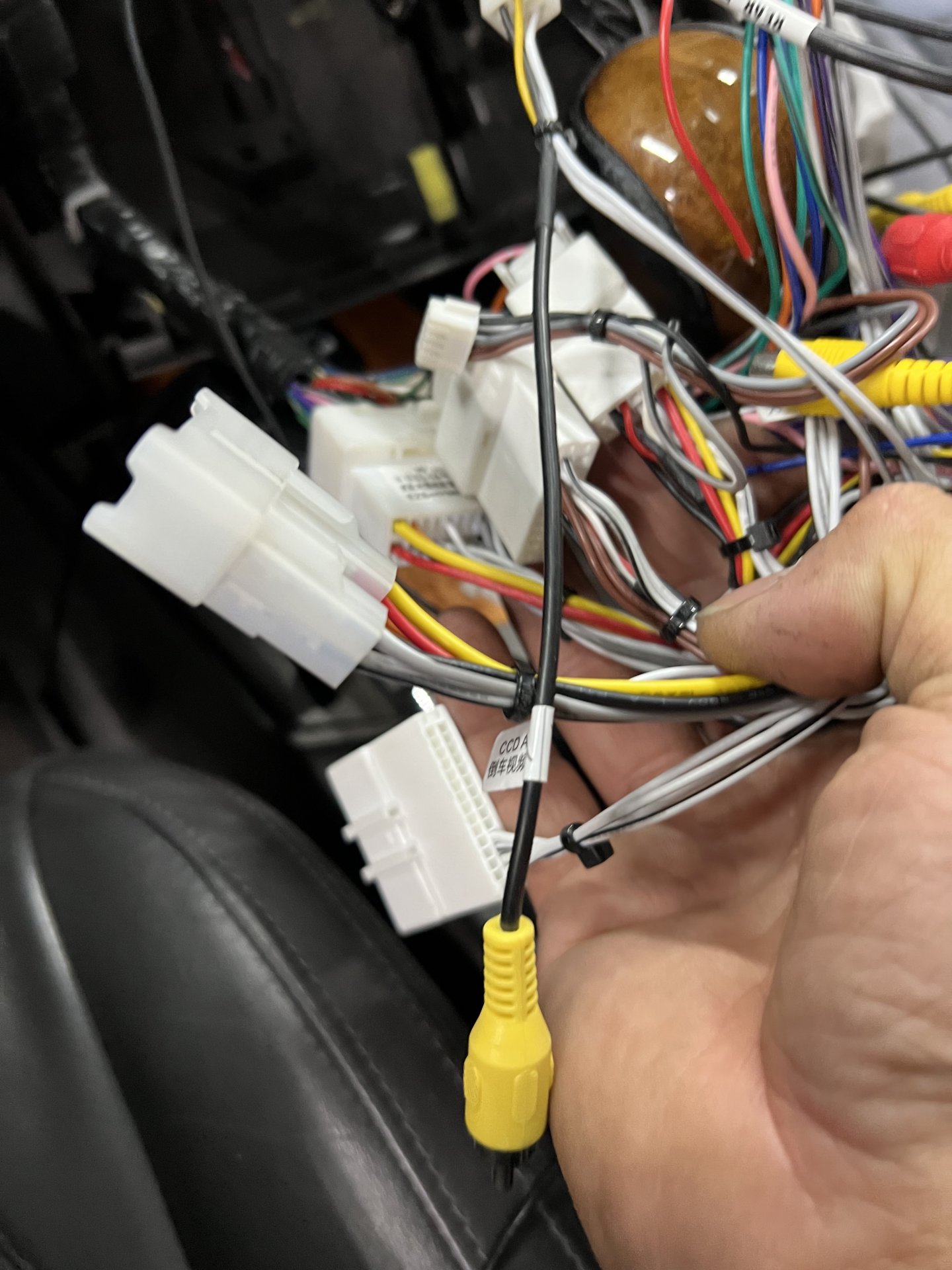

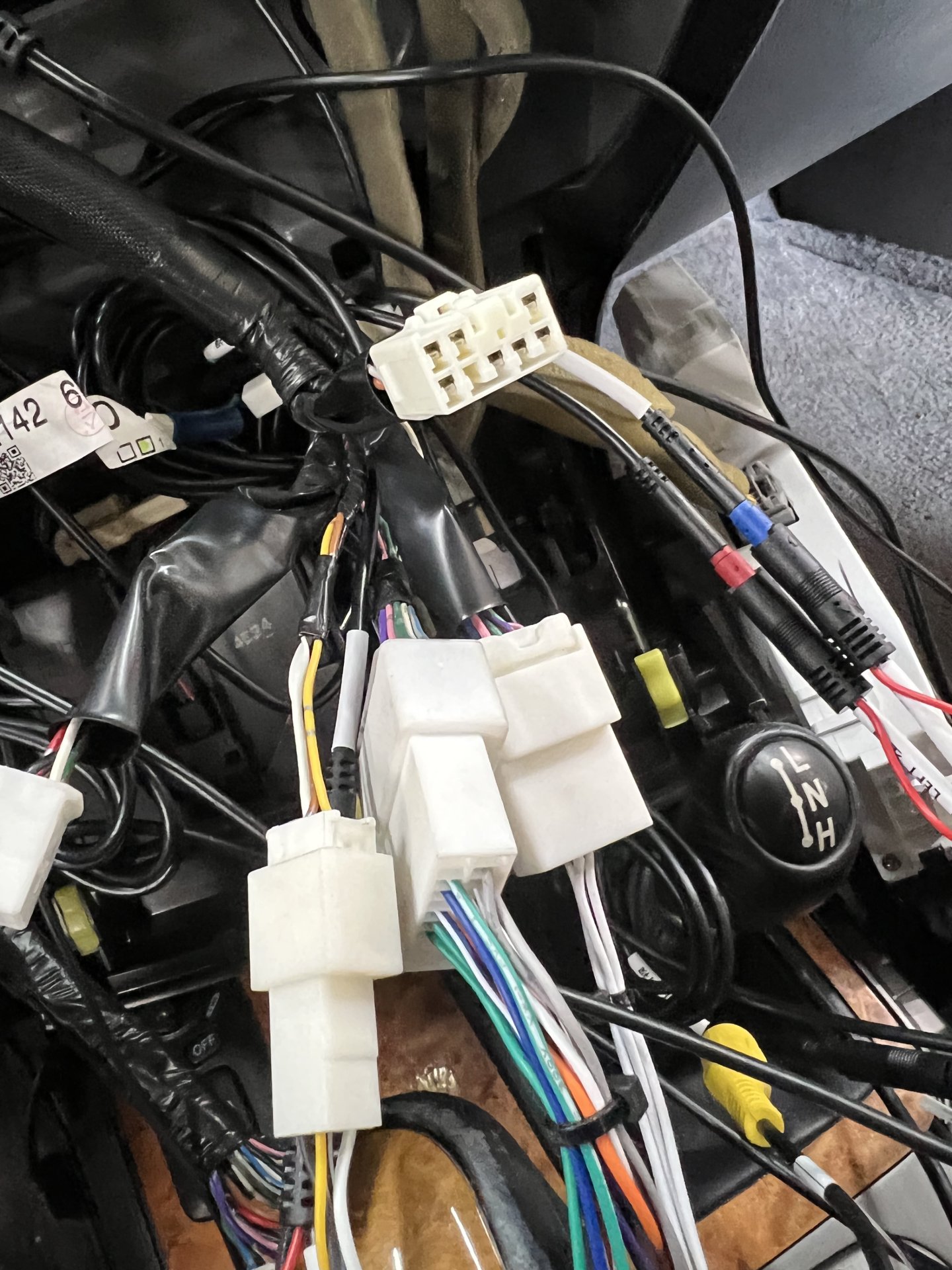

A second stereo shop checked my connections.. he couldn’t get it to work either.. here is what he saw..

You should contact Teyes customer service. I also believe there’s 2 connectors that are easily swapped and sometimes people connect the wrong one. GXOR group on Facebook will give you much better insight - a TON of guys on there have Teyes and like them. I wouldn’t rip it out just yet.

I have the same model year with the Mark Levinson navi system and the same Teyes unit and have no issues with my HVAC. Seems to work great. Did you make sure that you set your CAN settings correctly on the unit's system settings?
Have you tried contacting Teyes customer support to see if they can help you and the shop sort it out? Its possible the unit is somehow bad. Do you know if the CANbus adapter was installed? Do your steering wheel controls work?
