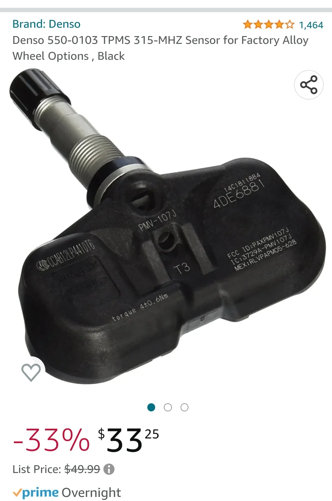

Have you tried the Denso TPMS sensors? part number 550-0103 is compatible and I have used 10 of these for my two different tire/wheel set ups. Work perfect, no issues over 3 years of use. Should get 10 plus out them. They are OEM and compatible and under $35 a sensor.
You can get 5 of these installed for less then what that dealership is charging for one.

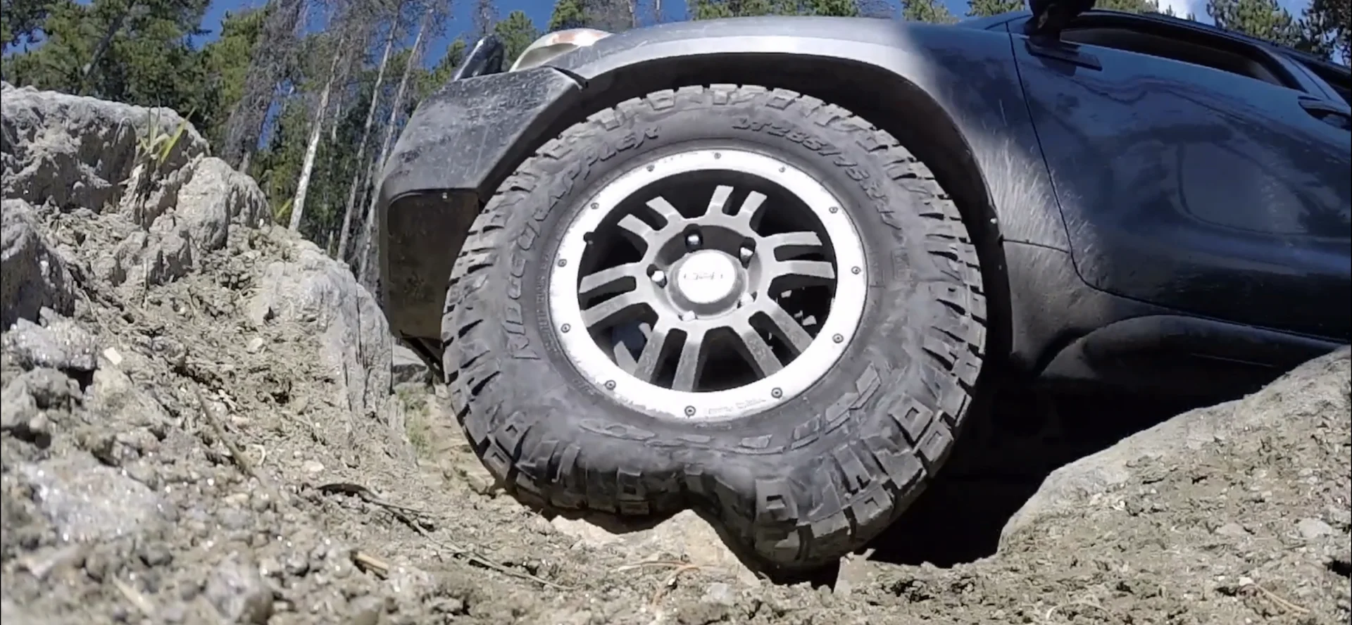

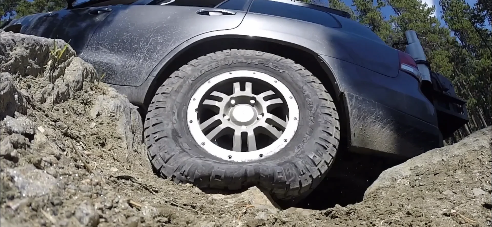

👍🏼 Always a good move for off-road, especially when aired down. Here are my 17” Rock Warriors doing something that would likely be pinch-cut tires on 20-21 wheels… (and yes, they’ll bolt right on).
