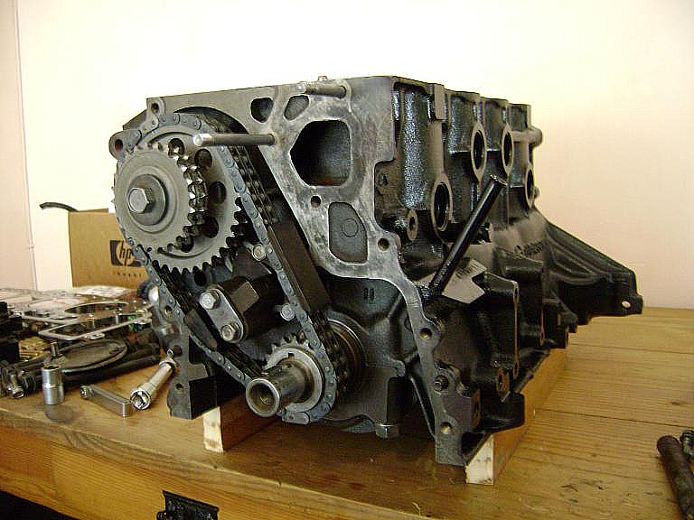

Hmm that's a good one... The head has to match the dual row timing chain as does the timing cover... so that's makes it sound like the block, head and timing cover are all early... The injectors wouldn't plug and play between 84 injectors and 88 wiring, so they probably swapped that stuff onto it? OOOOOOOOOORRR!......
21-RE? :D
22R ............+E :flipoff2:
It would make sense if it was a 83 or 84 Celica engine that they would just block off the fuel pump with a plate.... maybe was single chain OE and converted "back" to dual?
Toyota in house experiment engine? :hillbilly:
Anyway to get tell the year of the block from the casting numbers?
Jerod beat me to the reply, I've done a couple of those conversions. Both involved a Celica, my old 80 GT 5-speed special edition hatchback, and a friends 81 coupe. I didn't even get past Wristy's "..double row chain" before I had a Celica pictured in my head.

*A 2T-G block assembly..

Hey now, it's entirely :censor: possible and at least I posted a pic! He didn't!! :flipoff2:
So, Wristy, :lol: "Pics or it didn't happen?!" :lol:
