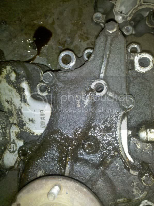

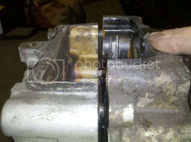

the tensioner is jacked on this thing causing the chain to make a lot of noise and there is crazy free play from the crank to the cam, cause the chain is strecthed
sounds a lot like what I was dealing with last year when I bought a 20r/22r hybrid from someone and they cracked the timing cover...that was a pita...
FYI 2T-G is a DOHC 2tc...the extra gear is for the cams and what theyre on is a dummy cam...2tc is OHV but they share a block....I hope no one ever puts a 2tg in truck..
