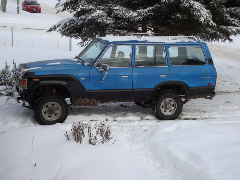

Found this not five minutes ago, its a picture of HeartCooksBrain's cruiser with black paint exactly where I want to apply my Rust Bullet.
attachment.php
Yeehaw:hillbilly:
-Carl
