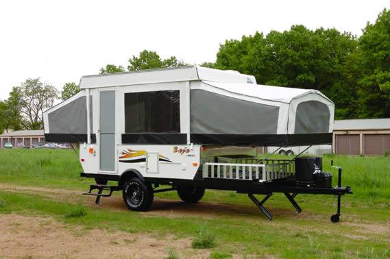

Just got this text from an old neighbor:
you know of anyone who may be interested. It's a Jayco Baja 10Y about 2008. He wants 5k but will go lower if he can get rid of it quick. It's in really good shape. Thanks.

Related question: I am not a fan of the front ATV deck, but it seems most of the manufacturers are using them. How difficult would it be to cut it off and re-weld the frame? Would it still be safe? Tow fine? What about adding a lock and roll type hitch (assuming electric brakes not surge brakes)?
I looked into doing the reverse just to add a small outside storage area for gas, generator, fire wood etc. but cost became an issue to add and strengthen an old frame. Seems easily possible since I believe they made this Model with no platform. Jacks just bolt to the frame, the poles have a hole slot that is incorporated into the frame. Seems like just cut out an entire square frame section and triangular section as one, butt weld and add a sleeve into the frame, remount the jacks, and cut and relocate the bed platform poles and mounts. Unless you can weld or have a friend who can, to assure it stays true, it may be easier and cheaper to find the BAJA shorter version.
you would have to modify the pulleys and lift system since the crank is usually located up on the tongue.
if that's 5grand, i'd scoop it up in a hurry. My Palomino like that, same year was 13K, and they are 19K now.
(granted mine is a skosh bigger ) but still...
I pulled mine behind a Tundra, it did awesome, and it rips across the dunes of pismo no worries.
My 80 hurts when I tug it, but it's 21' and way heavier than this model here.
seems a bit heavy for a swivel hitch.
