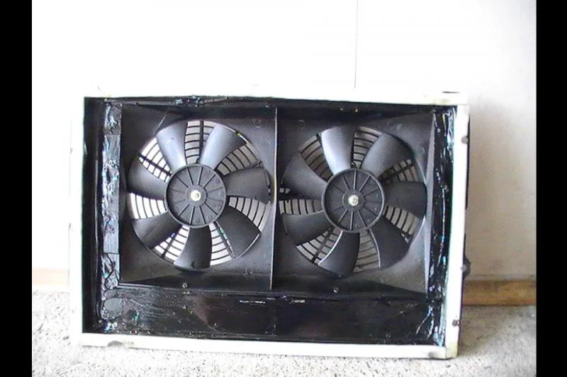

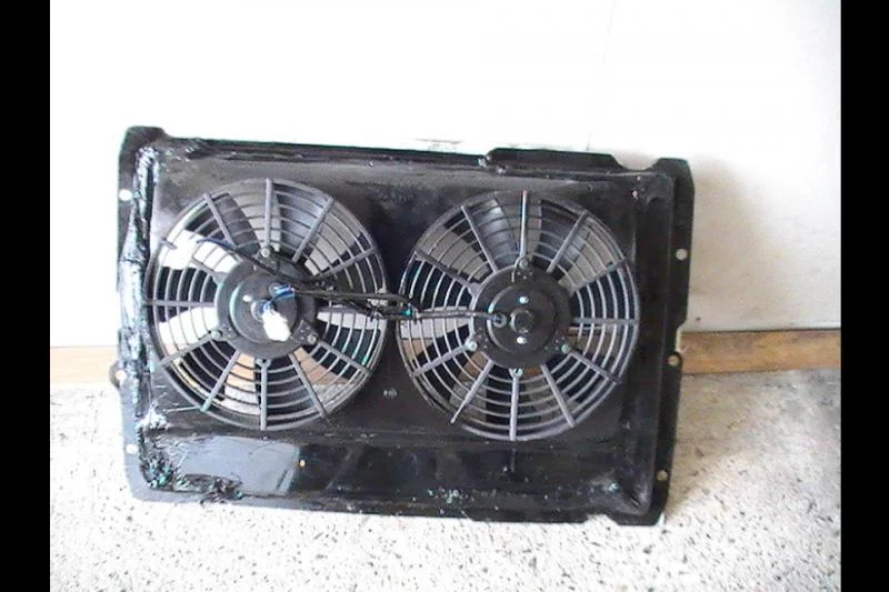

All the standard stuff is fine cause I have replaced it not long ago I just wanna see how these go and I can always put the old fan back on its an easy swap. I bought one that had been made for a hj60 I'll add a pic of it soon. It isn't the neatest looking thing but along as it does the job for a while then that's all that matters.
A few pics of it. Don't judge by the looks of it.
One of the problems with those types of fans is that they don't allow good airflow at highway speeds. so they cycle on and off even when you are cruising. I hated that about my electric fans. I also was not happy with the reliability. Mine were done pretty well and I had several small issues that caused overheats. Last thing was the noise, they were loud.
They do draw quite a bit on the alternator. especially if they move a lot of air... I think people underestimate the draw actually.
Try it and see, you may love them.
I'm thinking of running them full time when the engine is running so they always are having air flow. Im not to stressed if they are loud because there isn't a quiet thing about my 62.

Do the math and make sure your charging system is up to the task of running those fans full time.
If those things pull 20 amps you'll need a 240watt alternator to keep from starting to run batteries down.
Hell, even if they pull only 10 amps, that's 120 watts.
I really wouldn't bother with electric fans. Moby on this board lost his 62 in a fire due to the fan wiring.
The stock set-up will out-perform the electric fans. If you want more air movement from the stock fan put higher viscosity fluid in the clutch.
