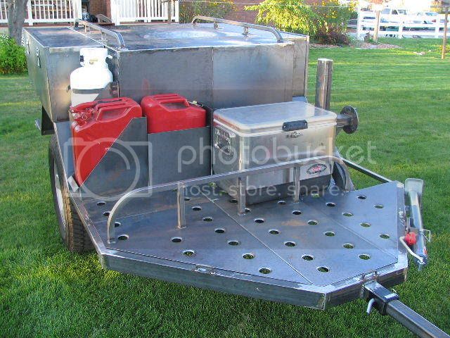

Fence for front platform, another can holder, tie downs, roof rack, and more dimples....:D
A dimple a day keeps the doctor away....she's lookin sweeeeet as hell!! Keep Mad Mike to the welding rods and let's get a coat of paint on that BAdBoy The boy has mad skilz!:bounce:

The holes are drilled all the way through the frame so they can be welded on the inside and out. Also I realize the chains are too short for the extended reciever. They were standard length. We'll get a couple extender chains for when the bar is out.
Love those dimples :D Makes me wanna get the die set.
After looking at the tongue receiver tube setup, I can see that it won't be hard to steal it. Do you have some plans to prevent this? True, finding the other half of Roll N Lock won't be easy but a longer receiver tube setup can be improvised if someone had enough motivation.
Keep up the good work. :flipoff2:
The reciever tube will only be out that long for highway travel, it will be in the shorter config while parked and for off road travel, also I will be getting locking pins.
