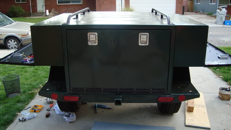

I got the trailer this morning. I got alot of it put together. I had a lot of errands to run.
So here are some teaser shots. I will have a pic heavy spread this weekend as I finish up putting the parts on, and work on the lights. I need to find some good weather seal as well.
Two questions for advice.

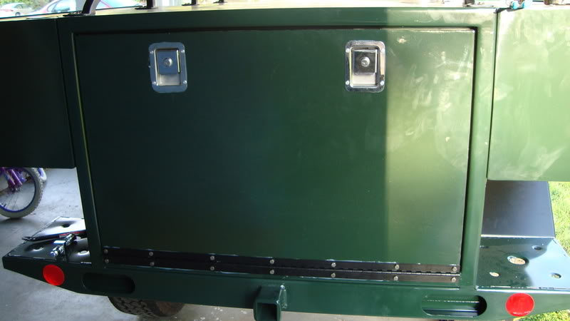

1. What dust proof weather seal should I use for the doors?

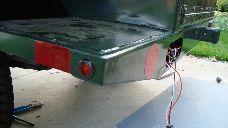

2. Where do the reflectors get placed?
On to the mini-show.
The inside.
Well..My night's complete!!..well worth the wait..very,very impressed. I'm thrilled to death for you..congratz to the build team too!!:popcorn:
Thanks pat. You crack me up. Your praise is appreciated. I can't wait to get out and jump some stumps with this thing...
As for the door seal...I would try to find a self stick,high quality, rubber "bulb" type seal. You need to determine how much space is between the door and the box (1/16"..1/8"...more?) Most important is to make sure you don't get the it, the door,"hinge bound" by putting too thick of seal in there. There is a fine line between sealed and not sealed. If you need help resourceing it let me know...I have some books at work that have some good stuff.

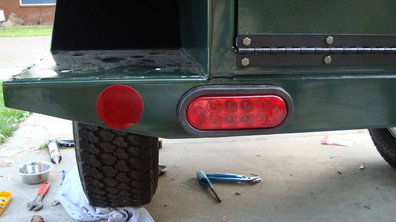

I would wire an amber LED marker in the front (kinda back from the jack holders) and put a red LED marker on the back (to clearly delineate) the side of the trailer. I guess you would light the back up (stop/turn) as you normally might. I love LED's..minimal power and maximum effect:steer:

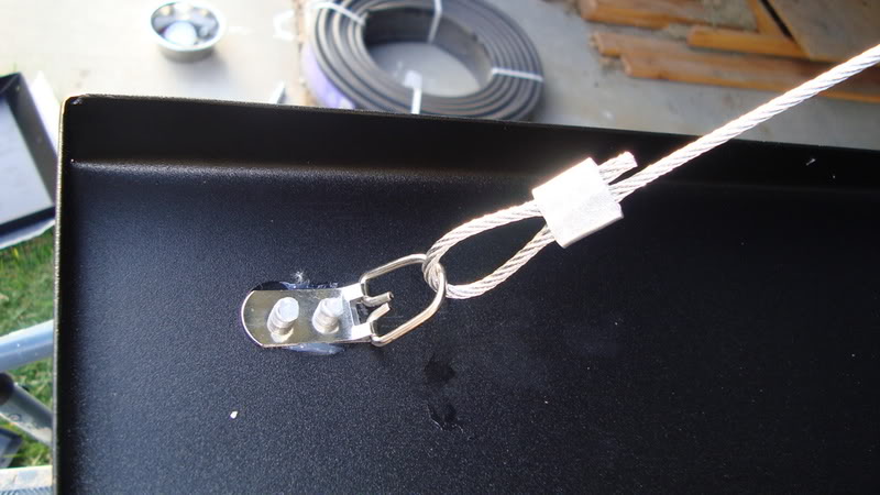

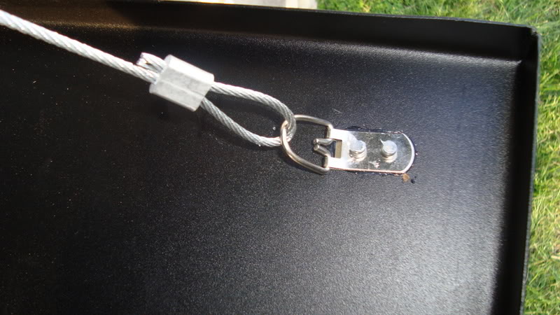

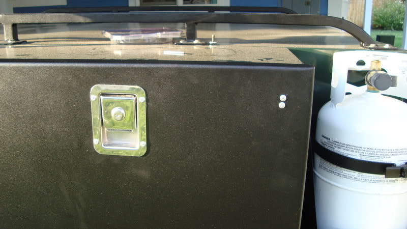

First I got some "heavy duty" picture hanging loops and riveted them to the side doors and the side boxes.
I bought some 1/8 inch cable and aluminum compression connectors. Rated at 384 lbs.
It left some extra rivets in the doors, but I think I have decided to put some flat black on all the rivets on the doors.

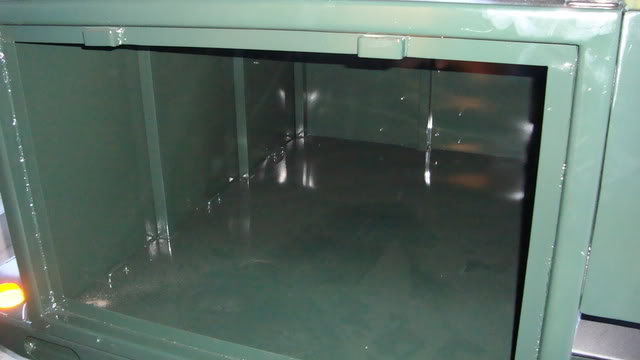

I got some "automotive" seal from HD, but its only 1/4 inch thick, as you can see on one of the photo's, and that's too thin. I need 3/8 - 1/2 inch, bulb would be great if you can source me some! Thanks.
Re. the lights...You put your MSpaint spots right where I have LED's ready to go. ;)

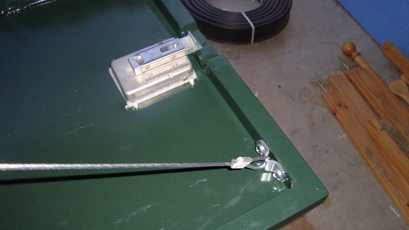

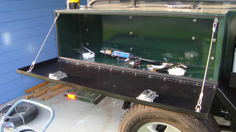

....installing the tail gate. First I got the hinge sealed and bolted on.

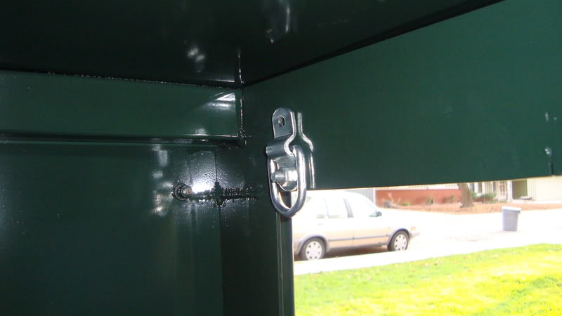

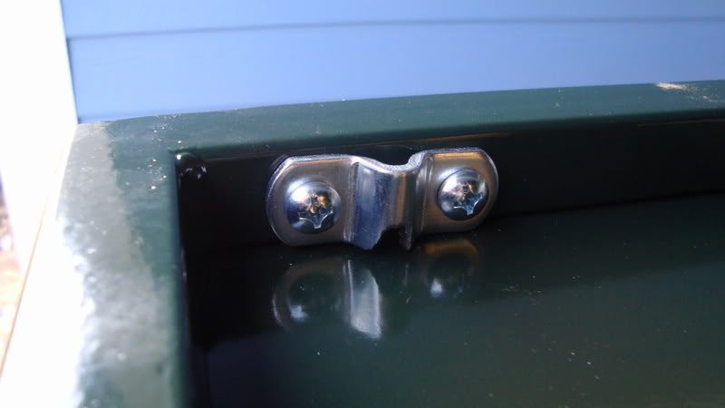

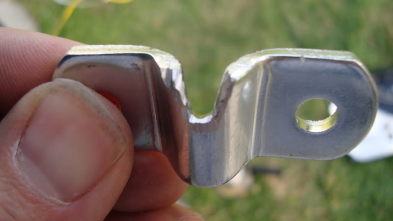

I then took my grinder to some tie down brackets so that the cable would fit between it and the inside wall of the tailgate.
Next I attatched another whole tiedown with the loops to the inside of the trailer box.
I made two identicle cable runs with the tie down loops attached.
And here's the cable attached to the tailgate...
...and the main box.
And I am pleased to show that it works as I hoped!
I have to finish up the other side box, and find some weather seal. I picked some up that you can see in the open side box picture in the last post, automotive stuff from Home Depot. But it wasn't thick enough at 1/4 inch, so looks like I need something at least 3/8-1/2inch...I will probably get some of the stuff that was suggested earlier, but I have no idea how to apply it or what parts to get...

You have done a top job on that trailer. With the side boxes, i would of went the same way that normal trade type boxes do, with the returned external lip, similar to what you have done on the tailgate. Then it would be a matter of foam seal for a push tight fit, rather than the lid overlapping the box. hope that made sense.
Cheers - Dave
Cheers - Dave
Thanks Dave. I agree. However there were budget/time constraints that were at play, and I just didn't think I could afford the time it took to make them the same way.
Hindsight being 20/20 however shows that we missed the camping season that I had hoped it would be done to enjoy, and could have made them that way....sigh.

Here is a front marker LED.
And the rear.
