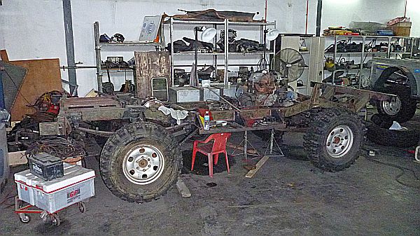

Work has started on the rear FRame see the arrow

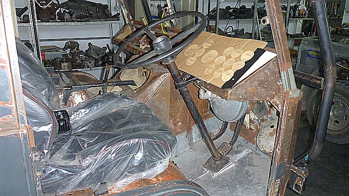

The pilot seat with the mockup dash sitting in it. It will all be lifted about 50mm and the left side about 100mm during the rear dash makeup.

1. I sat in the pilots seat and we put a seat in and sorted out the DASH position and what it will look like - next time I go up a blank new DASH will be made which will allow any control to be reached while wearing the harnessss seatbelts. sinx im 6' 2" it has to be correct for me and the SHORT friends who will drive it. as it is a small very cockpit and we are not changign thelayout at all.

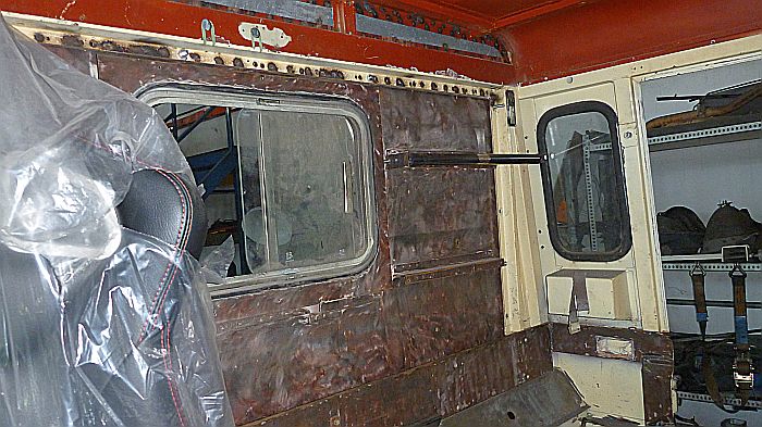

5. I cut and fitted the rear cabin panel then we looked at it and BRett said I can make it easier and nicer we use the new alloy composit material - he showed me and im hooked 3mm thick and LIGHT as and easy to work and even easier to clean and it will lighten up the CABIN - same for REAR CABIN also. The outside of the rear cabin will also be same material means I do not have to paint it - colours we are thinking of are GREEN or RED or bright PINK .

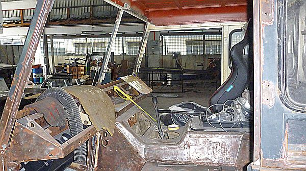

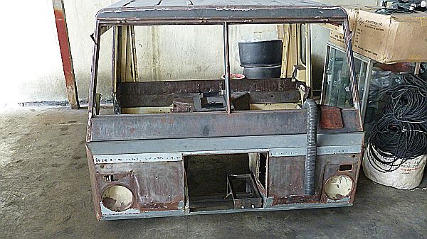

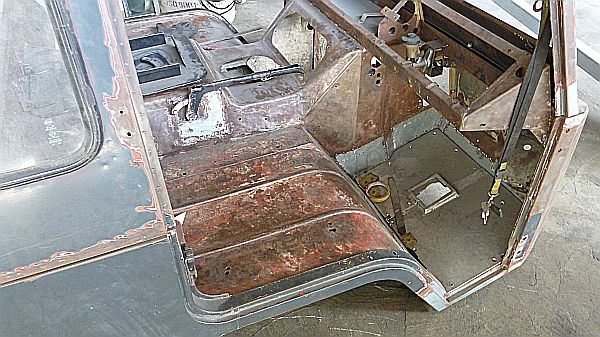

Got to visit the Volvo (C304 4x4) Saturday. It was in pieces again after 8 months of inactivity they started work on it last monday.

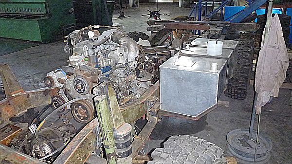

Cabin one side of the shop. The new 12v battery box sitting in the front and another to be made beside it.
Through the rear panel into the cabin.
And the chassis on the other side

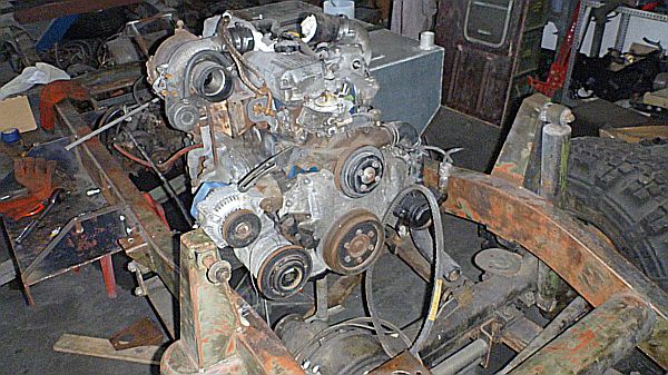

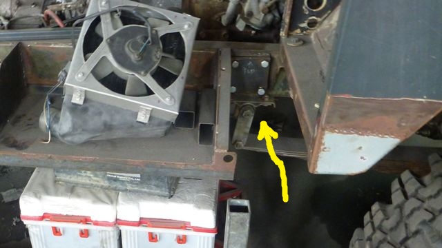

The Engines mounts redone so they can be unbolted.
The 12v Alternator is being mounted in reverse on a bracket so it faces back to the engine as there is no room for it to actually sit on the engine.

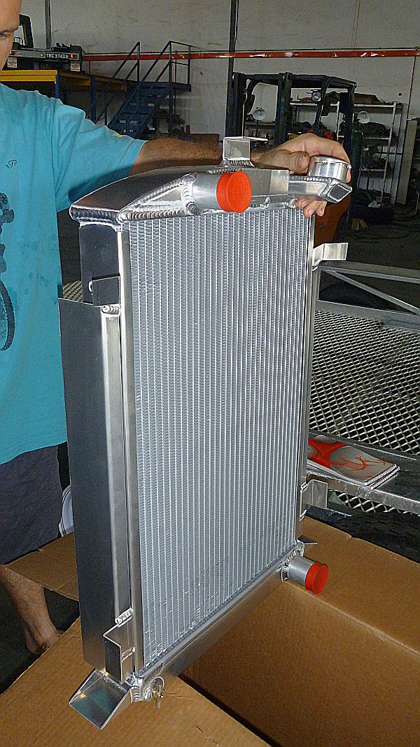

The new radiator built for a hot rod from Summit racing in the USA. If you think its big is 18" wide by 31" high

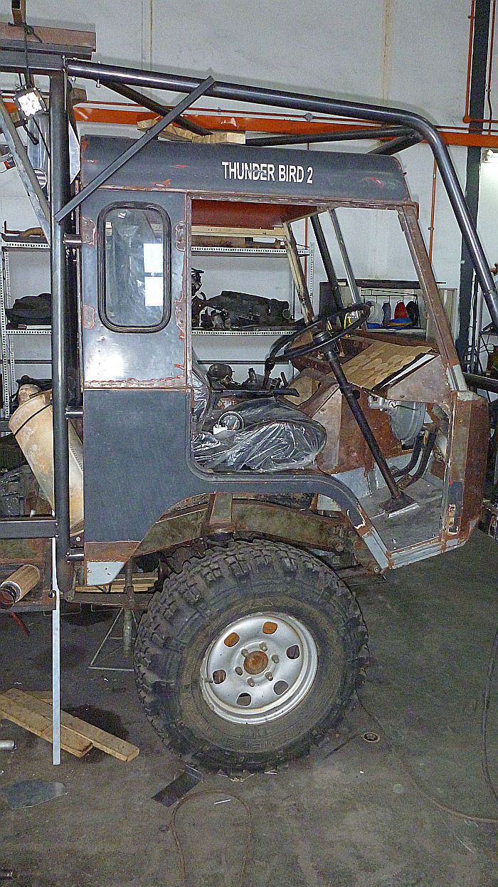

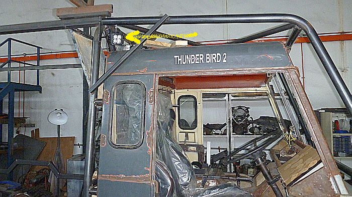

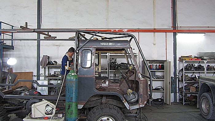

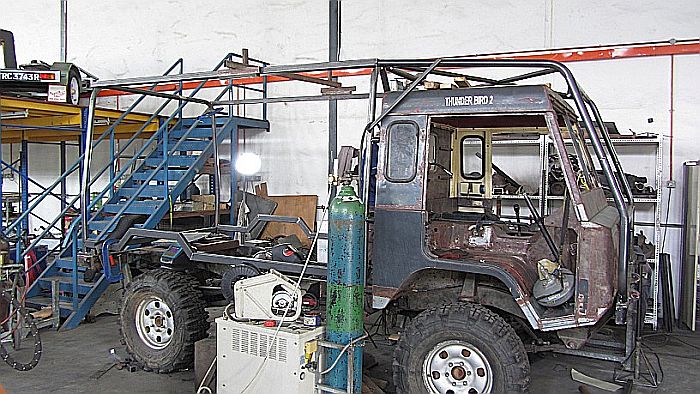

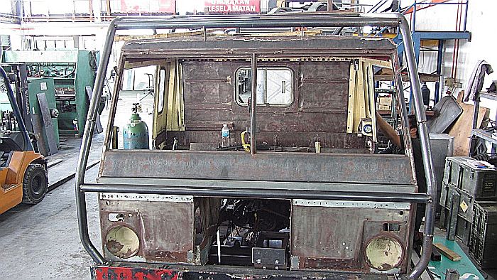

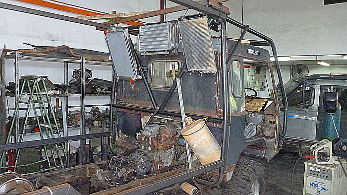

The external cage/roofrack is taking shape.
The front view still not complete.
Side view
The rear tray floor frame is also taking shape.
The Radiator on the left and the intercooler hanging in place on the right will be the exhaust.

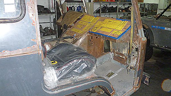

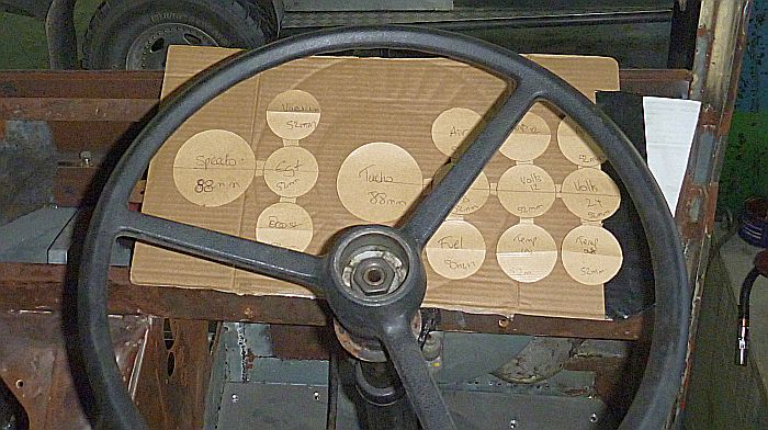

more pics soon as I get to sit in it Friday and we look at how to set the 14 gauge dash out (VDO gauges) and make it all waterproof plan to make the whole instrument cluster sealed in a box with only one wire hole or a series of holes on one side only later siliconed up.
Friday 7 September 2012 went up to see the Volvo
The dash layout with actual size of instruments and layout.
The layout and the dash and the steeering wheel

Side view the rollcage is now attached to the rear of the cabin in 3 spots per side. They started out to be removed now they realised they needed them to add rigidity to the roll cage.
