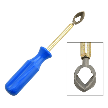

With a Key way tool Installing the Key is the EZ part I ending up cutting the Key to length + 1" and working It in with glass cleaner

That seal is common to a lot of older cars including land rovers with the fixed glass tops and so forth. Typically not molded. The seal is 1.50 per foot. It must have SUCKED with those popsicle sticks. The correct lock strip installation tool makes it a breeze:
