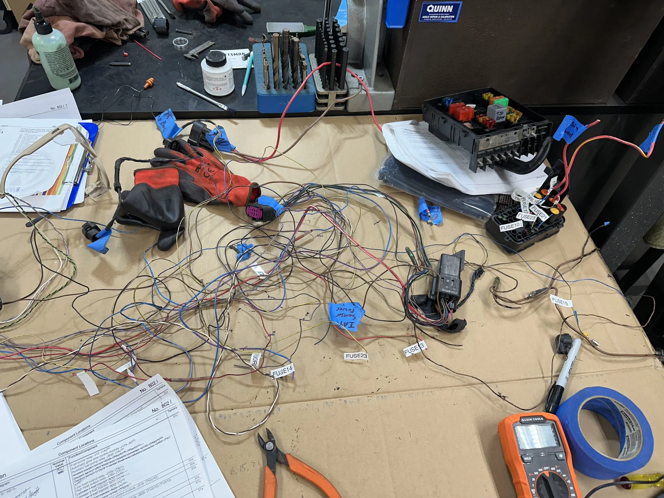

Harness is cut away from the OEM fuse panel, I think I know which fuses all the wires go to. There’s only one relay on this panel but there’s two more I’ll need to integrate from the body side of the harness that trigger the primary and auxiliary electric fuel pumps…this harness is a mess.
A braver man than I. I'm mostly a 1 circuit at a time type.
Unfortunately the way everything was loomed together this was the only practical way I could think of to get everything detangled so I could clean the goop off the wires and get the necessary stuff sorted from the unnecessary...1 wire at a time definitely sounds like the safer option though.

I think I’ve finally got a grasp on this harness. Still have some studying to do with the wiring diagrams to sort out the fuse/relay situation since the OEM setup had multiple busses embedded in the fuse box. It seems like most of the harness is necessary, first picture is stuff I think I need and the second is stuff I can remove. I count 9 fuses and 1 relay required from the original harness. The ECM provided the trigger for the primary and auxiliary electric fuel pump relays in the body harness, I think I’ll combine those to 1 relay triggered by the ignition in the “ON” position to help with bleeding the fuel system after filter changes and maintenance so that’ll bring the relay count up to 2…these common rail diesels have a lot going on to make them run.

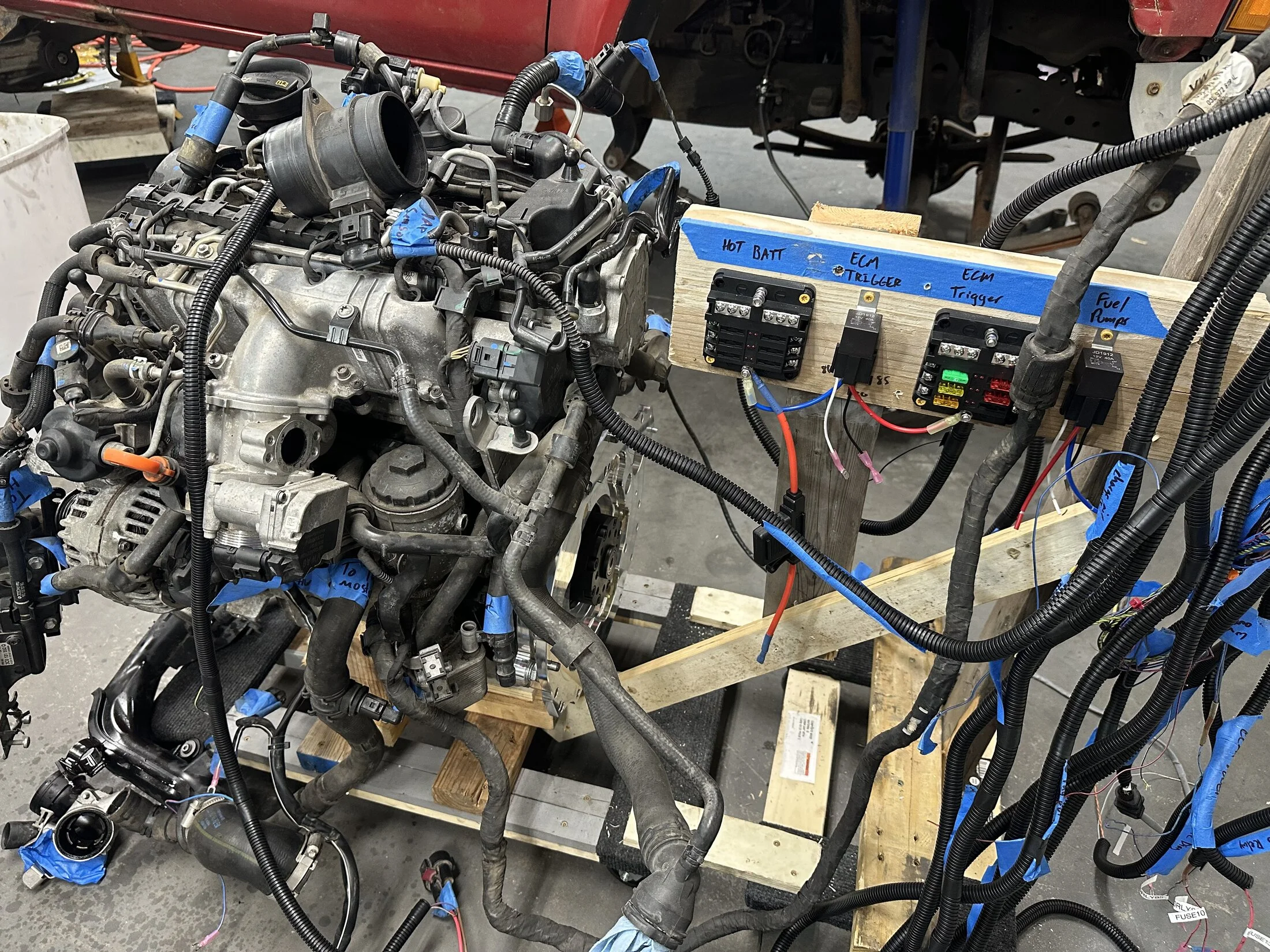

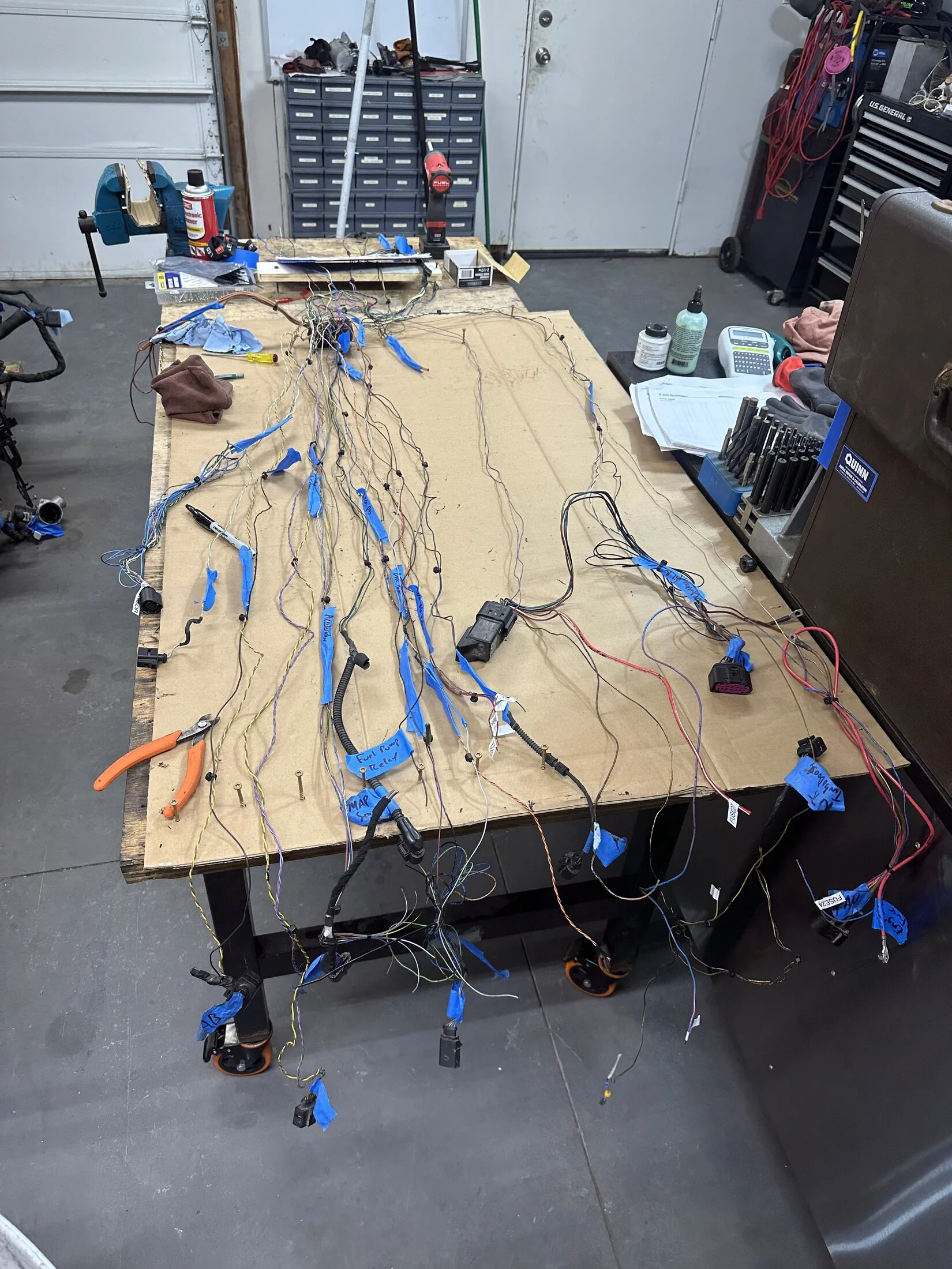

I wanted to have the wiring prototype done by Thursday but we had some severe weather that knocked a bunch of trees down (101mph recorded at the airport) and killed my power for 36 hours so I’m just now getting started on it. Changed the plan a bit, I’ve got two cheap blue sea style boxes, one is hot battery and one is triggered by a ECM via a relay. This “should” mimic the VW setup. Also got an inline MAXI type fuse holder for the 50A glowplug fuse…it’s in the right side of the picture by a normal inline holder. It’s comically large in person.

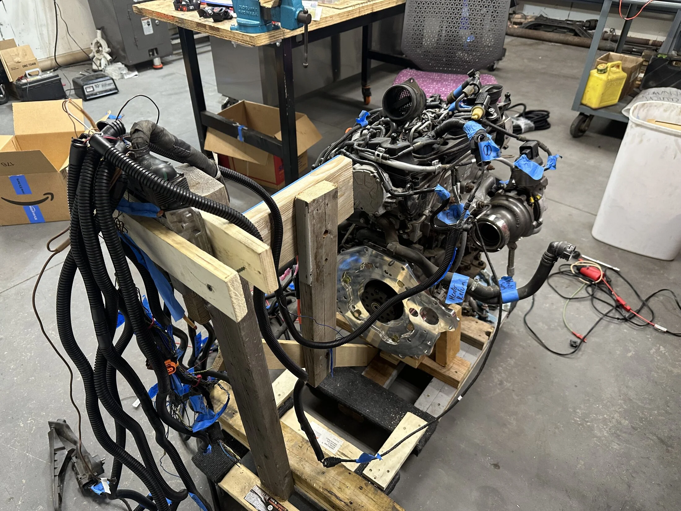

One day and about 75’ of the cheapest split loom I could find I’ve turned a spaghetti mess of wires into more of an octopus. I still have to sort out power for a couple sensors, fuel pumps, and connections to a battery but the wiring prototype is probably 80% complete…assuming I’ve got the wires sorted right.
I’ve always disliked working with corrugated split loom but I resent it now…
Nice work on the wiring. I wouldnt have wrapped it until you tested it out first. Just in case you needed to move stuff around or add a wire to a leg.
You're getting there. Wiring like this kinda sucks but you know ya gotta do it. And you'll be happy you did when it's over.
Definitely not fun, although I imagine it’ll be very satisfying when it’s all done EXACTLY how it needs to be for my particular application.
This is all temporary, even after I sorted it was still a tangled and sticky mess from whatever adhesive they used in the loom. It should be pretty easy to deloom a section to modify it if I need to while I work on getting it running. Once it’s running and in the truck my plan is to spend some time deciding on optimal routing, then I’ll redo it all shortening/extending wires as needed and consolidating each branch of wires where it makes sense. For now though I think having each circuit isolated like this will simplify testing and its definitely helping me understand the wiring process…this is my first attempt doing any major electrical work so hopefully that time investment to understand stuff is time well spent long term.
Test stand is mostly setup, sheathing each individual circuit definitely made this much easier. Still need to dig through the wiring diagram and sort out those last few sensor power leads that went to the fuse panel inside the car and also setup some sort of temporary fuel tank.

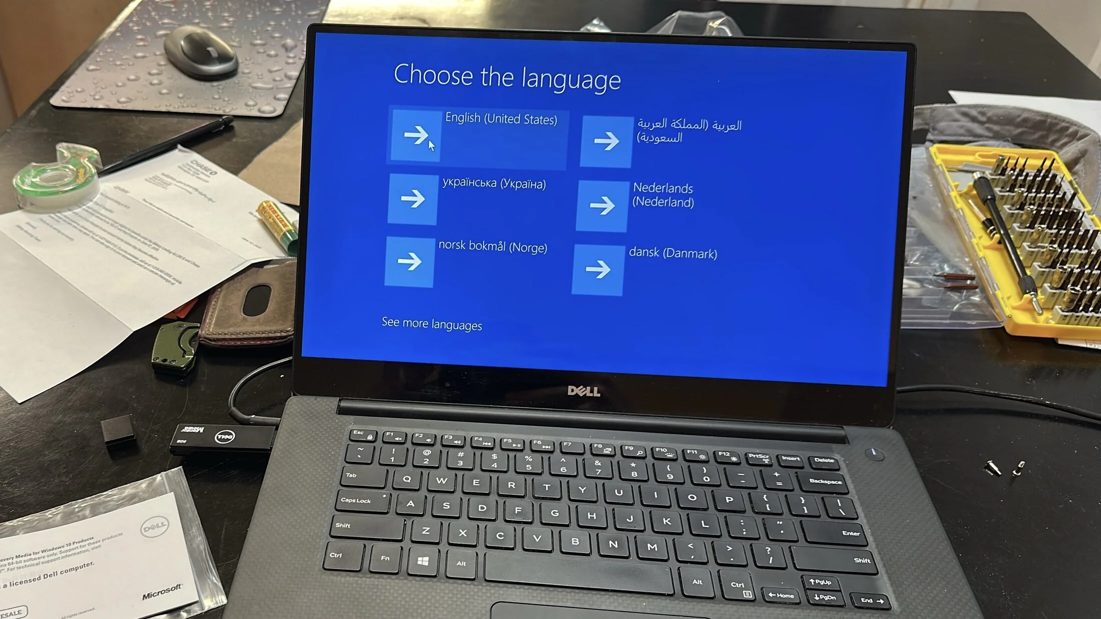

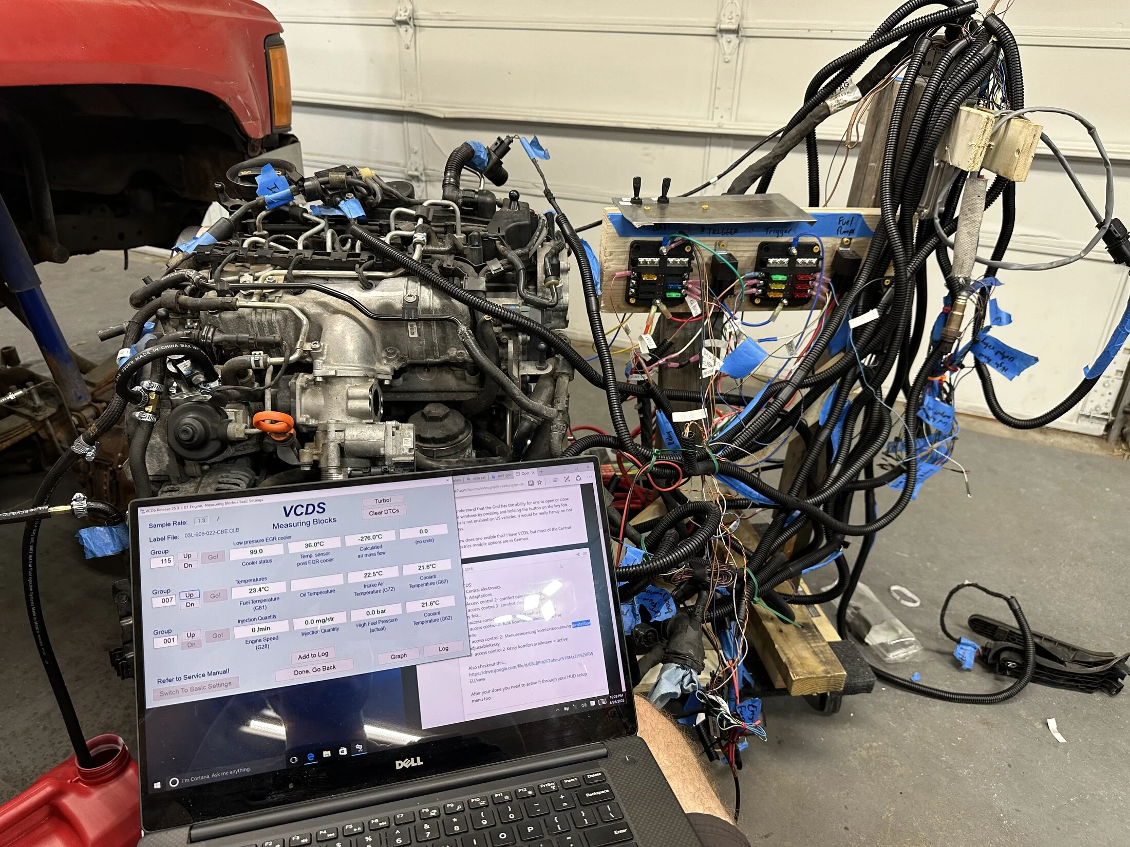

Also revived an old laptop with a fresh windows install and ordered Ross-Tech VCDS which is the most common software to interface with these engines. Most of the sensors won’t be providing accurate data to the ECM since I don’t have any of the intake/exhaust mocked up but for a quick test run to test the harness it should be ok? I’ve only used VCDS a couple times but I’m pretty sure I can individually check each sensor as long as they have power and make sure everything is within spec before I try starting it.
I’ll also probably put some outriggers on my dolly contraption so it doesn’t tip over when I try to start it.

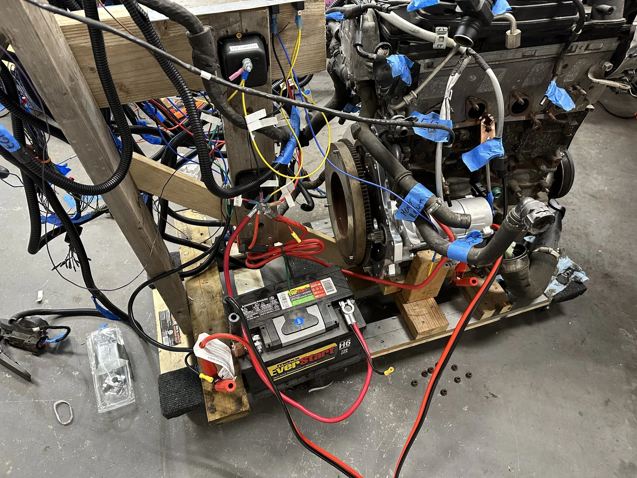

Rear passenger view, I’ve got the ECM clamped onto that upright at the rear.
Driver side view, still need to reconnect the fuses.
Really old windows install (2015) to run VCDS. It runs on modern windows too but this is what I’ve got and I don’t feel like going through the whole upgrade process for a offline shop tool.

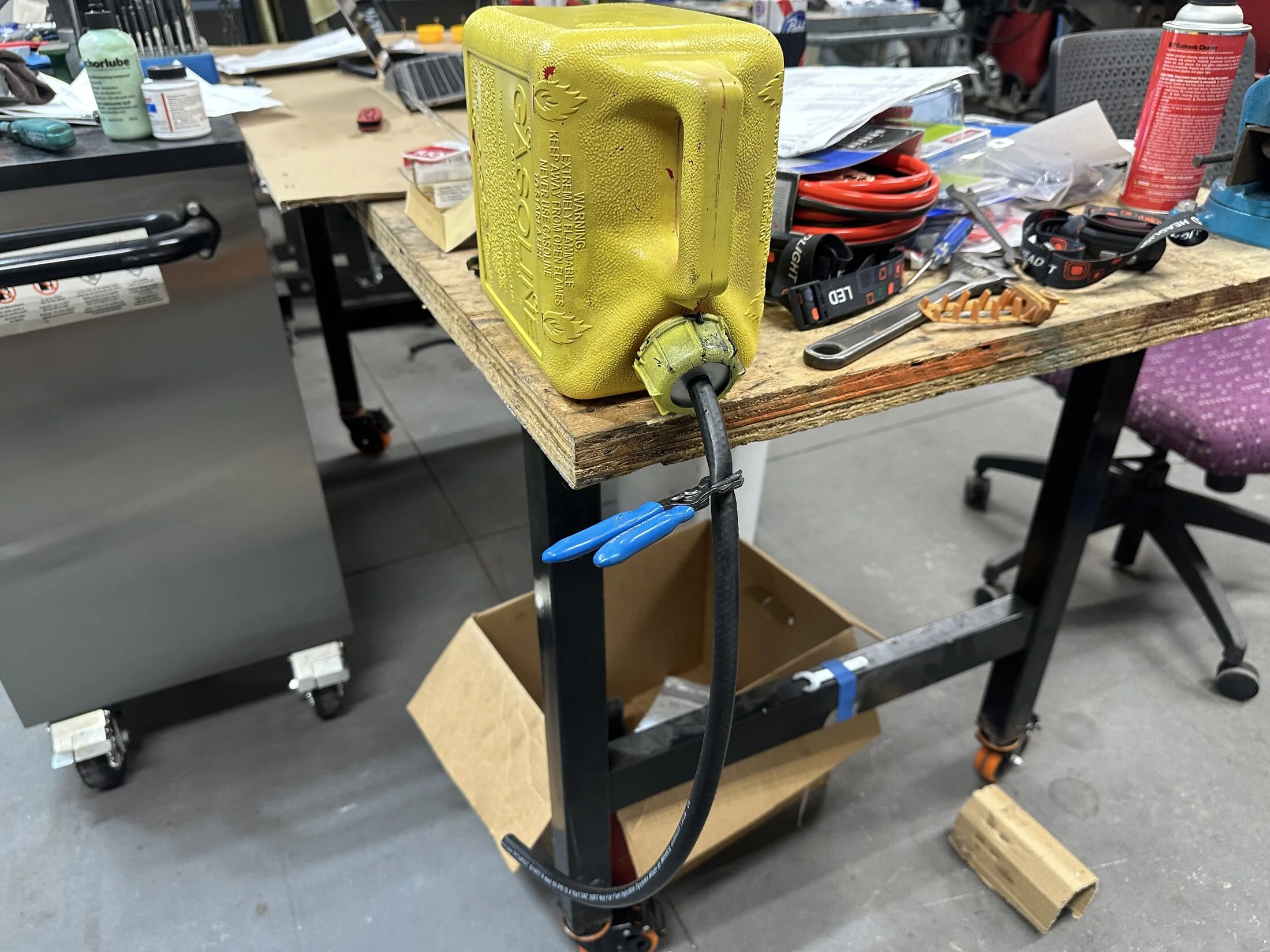

Probably 90% of the way to a test run. Wires are all terminated, just need to get a battery charged and hook it up. I don’t have a fuel pump handy to act as a lift pump so I made a little adapter for a small “diesel” can…I think gravity should be a decent lift pump for a test.

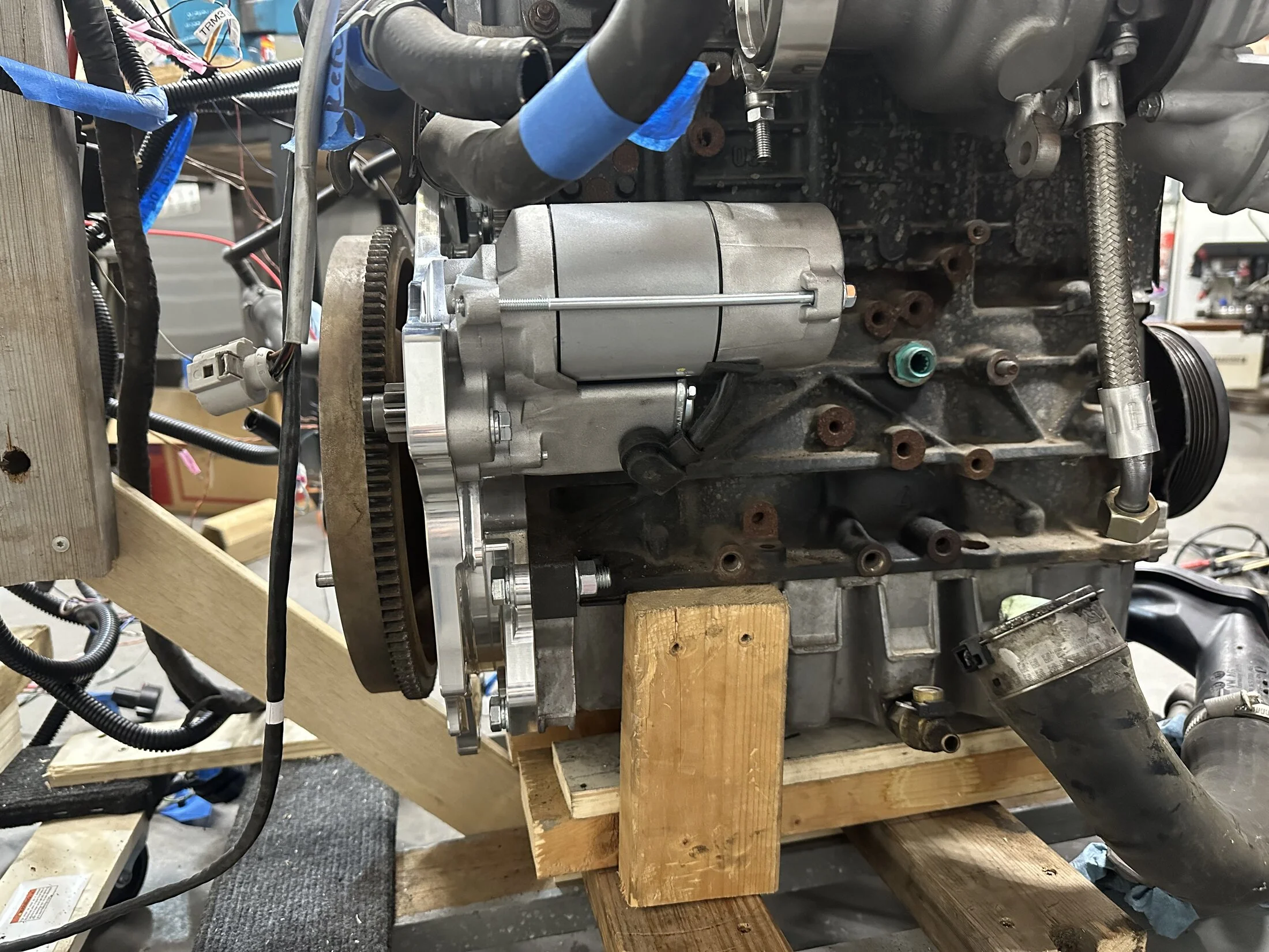

Adapter, flywheel, and starter are mounted and torqued enough to test with. My adapter kit is made by TD Conversions, it seems pretty high quality except all the adapter specific hardware is all standard which really annoys me. However, it uses a 2UZ starter so that’s nice. Also got my turbo feed/drain lines sorted out. I’m sure there’s a couple things I’m still missing but I’ll go through it all a couple more times while I wait on my software to show up.

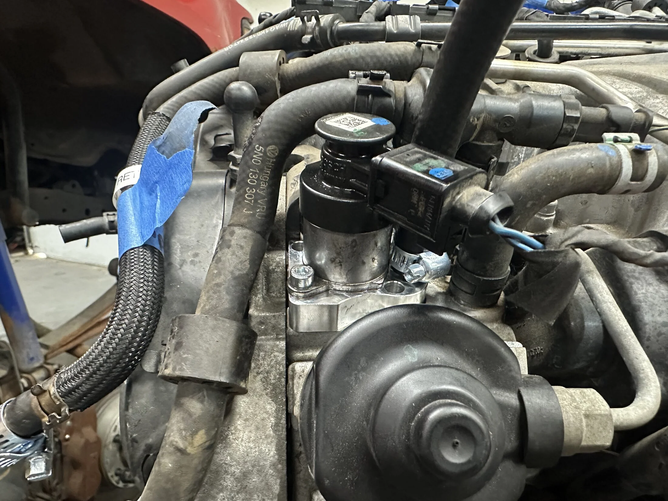

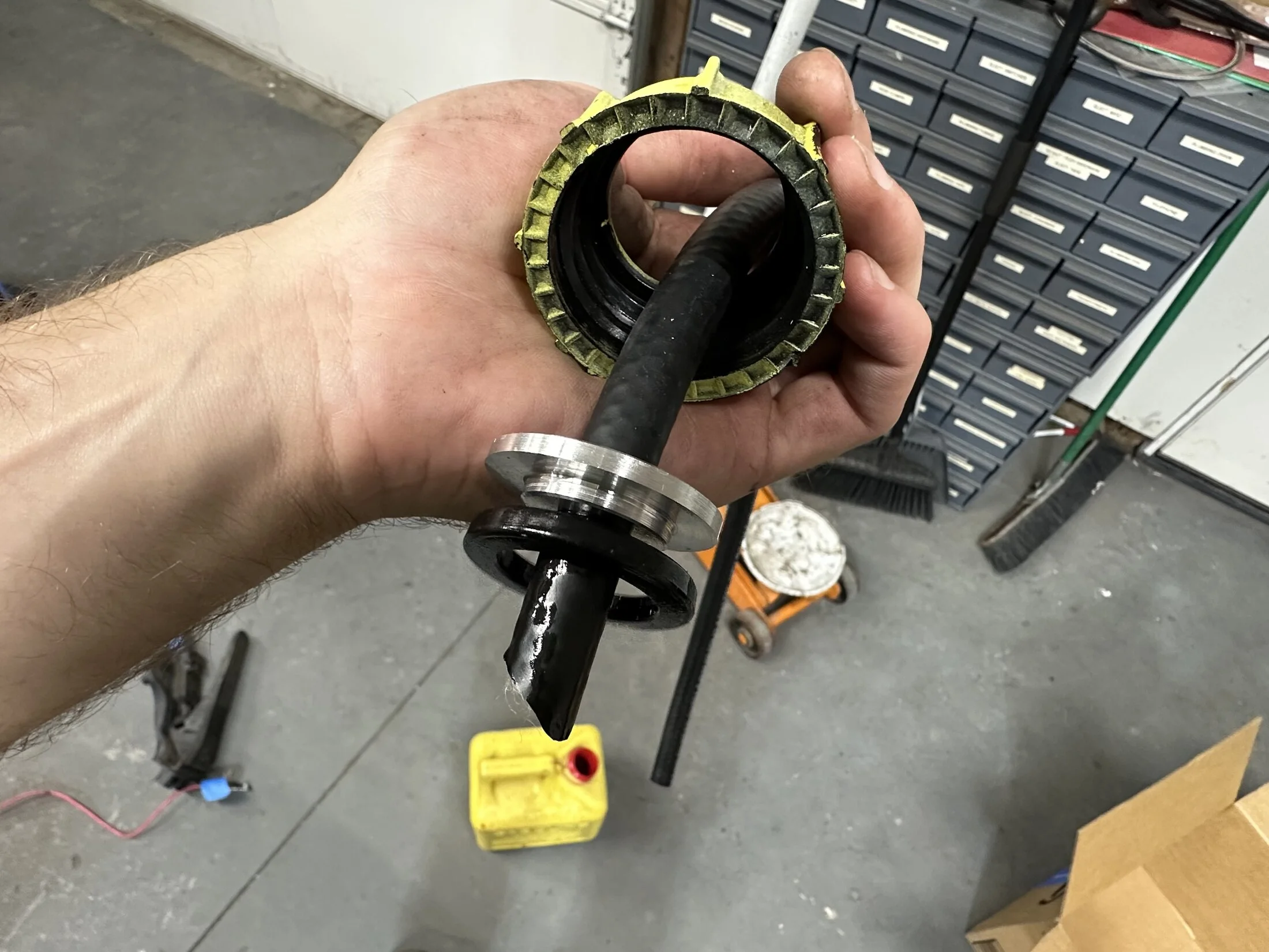

Also installed a modification to the CP4 fuel pump. The original design uses diesel to lubricate the pump and it will fail almost immediately if fuel flow is lost which sends shrapnel through the whole fuel system resulting in the entire thing needing replacement. This little aluminum part from Whitbread Performance isolates the lubrication feed from the fuel rail feed so if it fails the expensive stuff is all safe. It shouldn’t ever be an issue as long as the fuel system is primed before starting but it’s cheap and easy insurance. Kinda hard to see but it’s the shiny new aluminum block in this picture.
Additives shouldn’t be necessary, this engine has 112k on it without any additives and it was healthy when I took it out. Most of the problems seem to have been shortly after they started using the CP4 since this system doesn’t prime with the ignition “on” like older vehicles did…you need software (VCDS) to trigger priming cycles in the pumps. After a fuel filter service people would start the car and destroy the pump since the lines weren’t bled. Once people figured that out the failure rate seems to have gone down significantly. Hopefully I never frag a pump but this’ll protect the very expensive high pressure fuel system parts if I do. I’ll also probably put a small inline filter on the return line to catch any debris before it reaches the tank just in case I destroy a pump so I won’t have to drain and clean the tank too.
