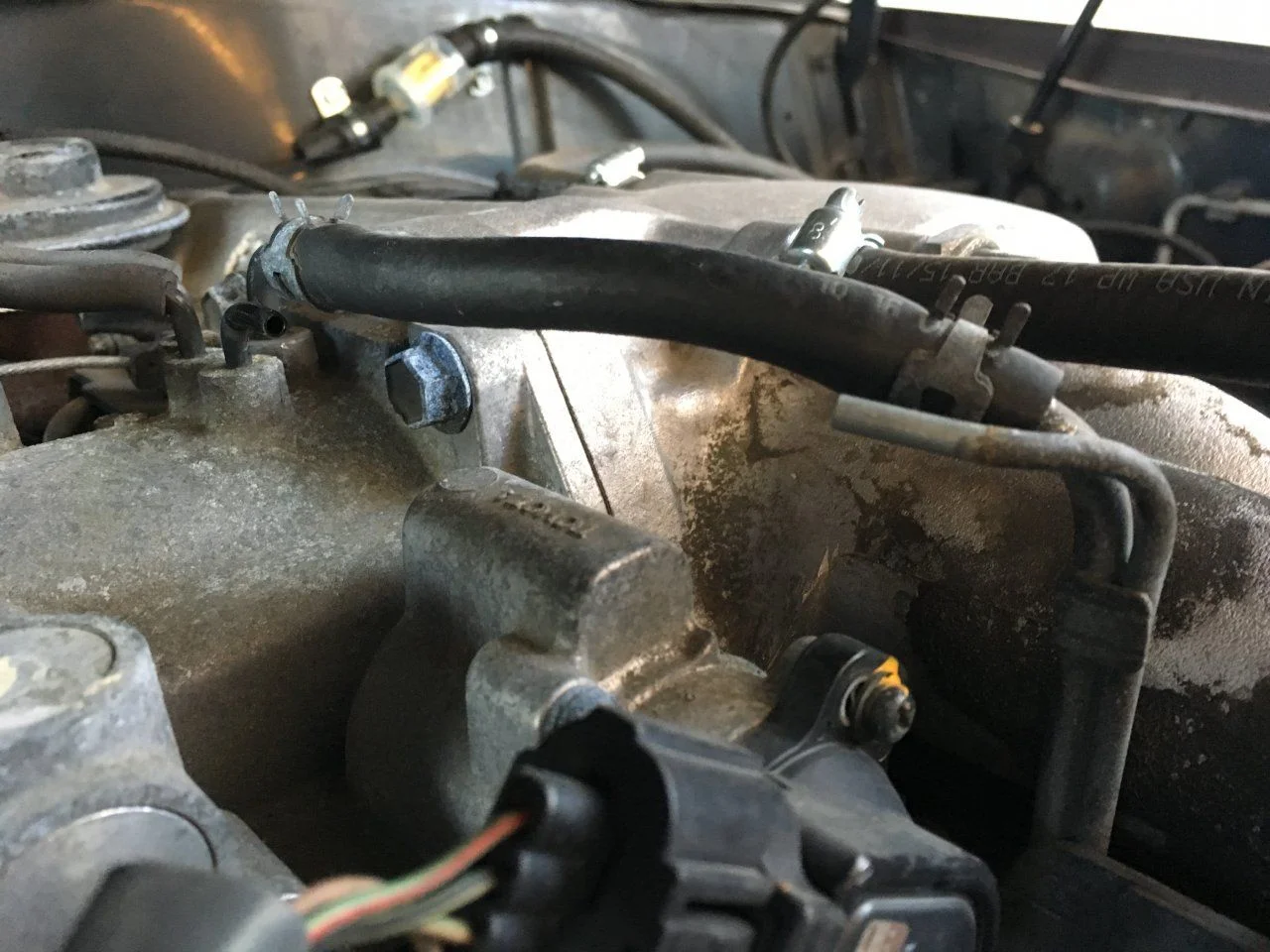

Time for a little maintenance.
Had a crack in a vacuum hose...
The plastic covers over the plugs is pretty lame. But it hid a bunch of oil. And a hornets nest. Literally.
I'd like to point out that the 1FZ-FE is poorly designed. I don't particularly care for the design of it. The plugs and wires take 30 minutes (with two step 6s) to change. The concept of having the plugs recessed in where you need an actual 16mm plug socket to remove them is ridiculous.
This is what the plugs looked like. It's been a long time since they've been changed. Don't know how long exactly but each one
New plugs, wires, plug seals, valve cover gasket, distributor cap, rotor, PAIR and EGR Delete.
Should've inspected and wrapped the wiring harness by the EGR while I had it all apart! Ugh.

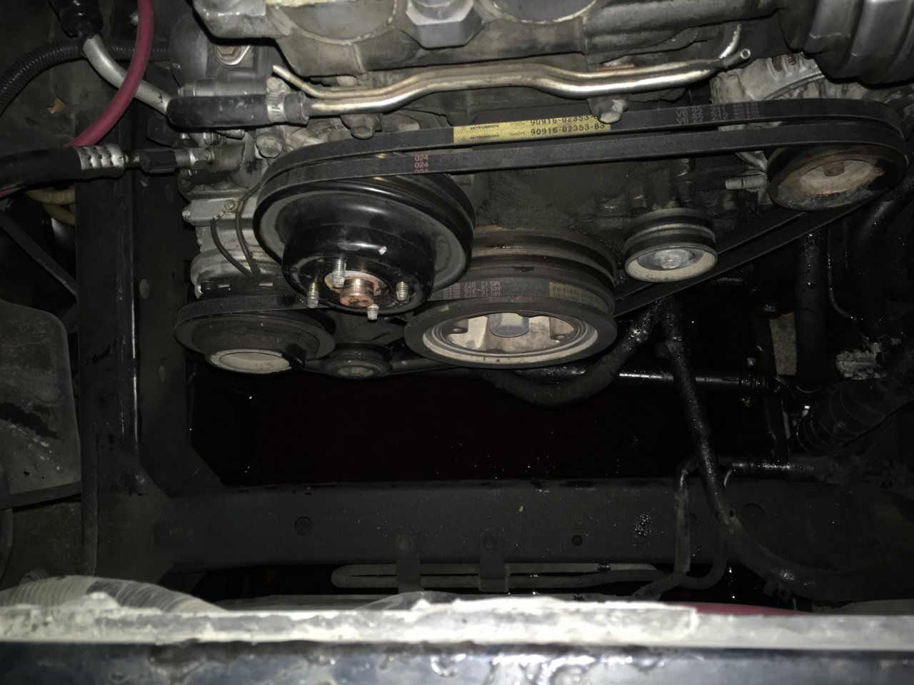

Started on the oil pump cover seal and crank shaft seal. Got the radiator, shroud, and fan clutch/fan out. Got distracted flushing the coolant. And checking my diffs. Front diff had nasty bird soup puking out the overflow. Clearly pulling in a ton of moly. I thought it was all puking out the knuckles but clearly not. Going to check the breather to make sure it isn't plugged.
