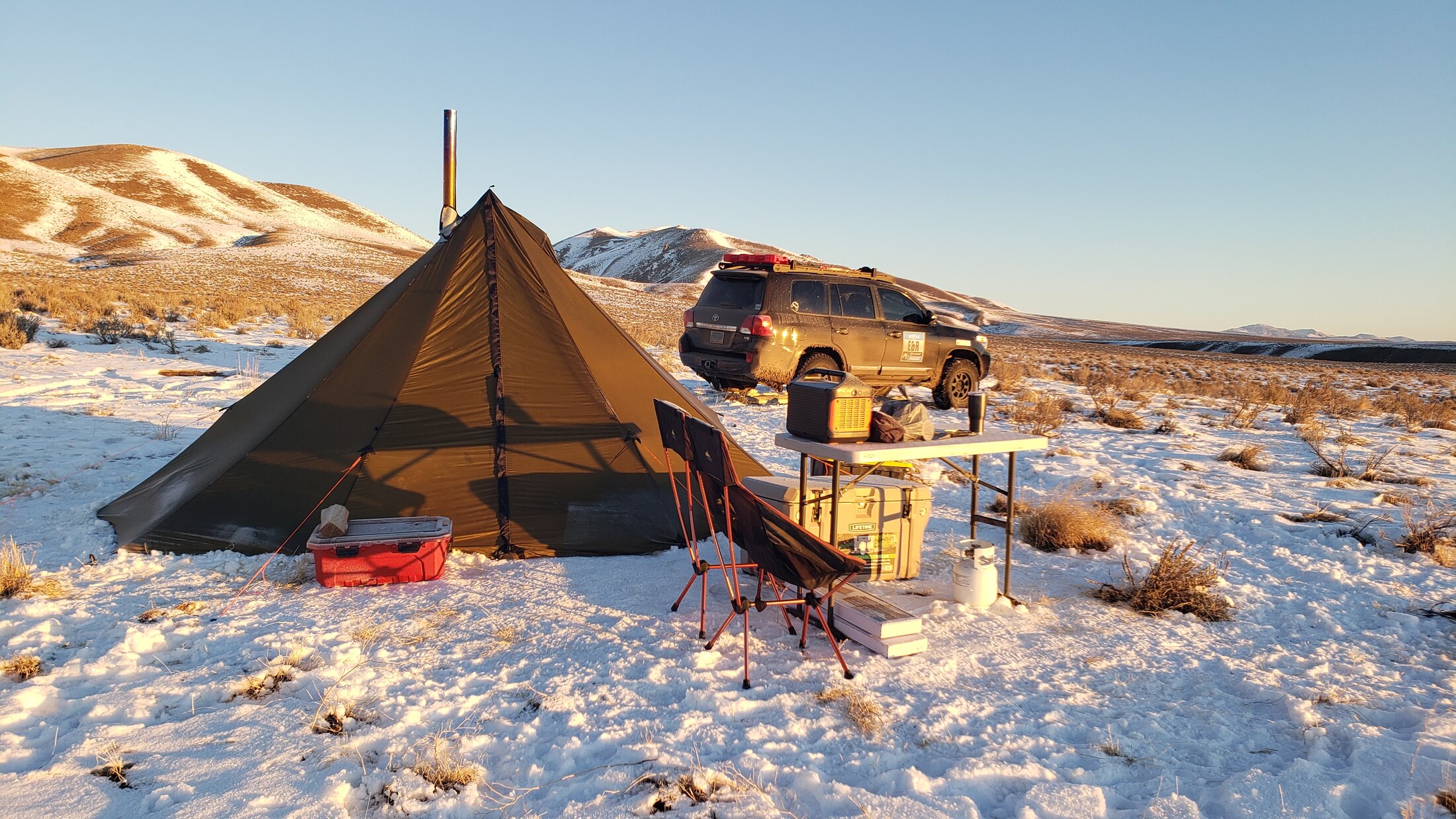

After elk season, we took Tatanka out for late season deer. It was the first time having it out in the snow and in temps below 0f. The driving portion was uneventful, which was exactly what I want out of it.

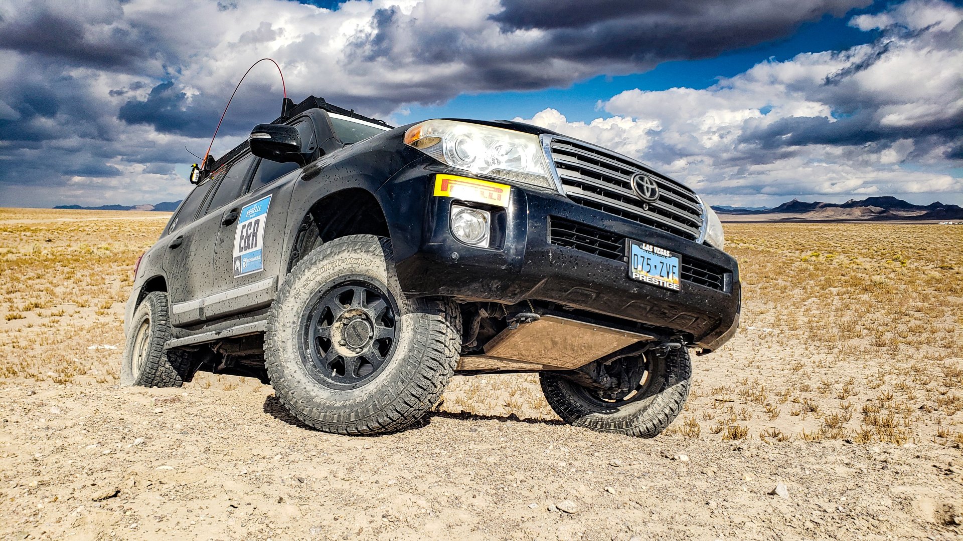

The other day, I decided I wanted to get some video footage of the Icons going through a short section of desert so I could compare how it looks and feels on the new shocks. I got a nice run in at about 21mph which felt comfortable, so I decided I wanted to get closer to the limit of the Icons where things would get a little out of shape. I bumped the speed to 25-26 hoping for a little more drama. I found the drama. I found way more drama than I wanted. I went over a small whoop that was followed by a small dip, but instead of the tires hitting the ground, the skid plate found it first. Thankfully we were filming it because it looked awesome.
Initial impact:
The truck landed and then hit the next whoop and got launched pretty good. The subsequent landing was actually quite soft.
Luckily the skid plate did it's job and I haven't found any other damage. This was straight...
