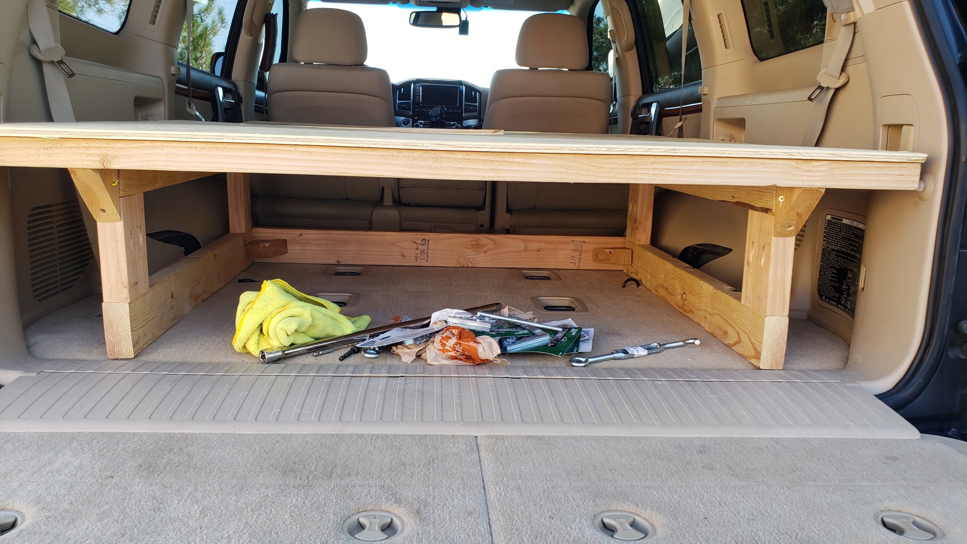

Here's some photos of the bed platform in progress. One of the problems I encountered is that the with between the wheel wells positions the hatch side of the frame right on top of the anchors I was planning to use to hold it down. Luckily, I was able to use a router to notch the 2x4s to allow the anchors to work with the turnbuckles I bought. I decided to go with a 60/40 split to allow one seat to be up should I desire.
I mentioned modularity in the previous post. Given that I need this setup functional by the end of tomorrow, I'll just be keeping it simple and sliding the front sections to the rear. After returning from this trip, I'll get a little more creative and add some piano hinges to the deck so that it folds up instead.
I got the platform finished enough for this trip last night and got the Total Chaos skidplate and belly pan on. I also wired in a button to open the rear hatch from the inside. I'm pretty happy with how it all came out.
One of my goals for the platform was to keep it as light as possible without getting too crazy. I wanted to build it out of aluminum, but I don't currently have a tig welder and metal prices are pretty insane right now. For that reason, the rear frame is built from 2x4s, the deck is half inch plywood and then I added some 1x2s underneath to reinforce the plywood. By feel, the result is that I definitely saved some weight compared to if I had gone with 3/4" plywood. I'm considering taking a hole saw to some of the 2x4s in non structural areas to remove a little more weight, though right now, I would say the whole system is probably pretty close in weight to the 3rd row seats I removed.

Good call on building that platform in lightweight fashion. From what I can tell, it looks up to the job. Are you going to put edge protectors on the boards to protect the interior as things move and shift?

I carpeted the areas that had potential for contact. Hopefully the turnbuckles keep it in place. I suspect they may loosen up.

Depending on whether you decide to stick with the current 2x4 base or not, 8020 style extrusions could be used instead, would be extremely rugged, bolt together, most likely save some weight, and give you all sorts of options for mounting things, including drawer sliders, underneath. I've been contemplating taking this approach to building something similar for my LC, but haven't had a real need for it yet. I had built something along these lines for the G-wagons I had prior to the LC and found it to be extremely handy having 2 levels of storage for stuff on long trips.
Was already looking at this, just wasn't gonna happen in time for the upcoming trips. I agree though, I think it would be great to have the modularity for mounting things. Long term, the plan is to build it out with a wedge tent as well so that I can sleep two in the car and two on the roof while keeping it organized enough for gear for four people for a five day trip. So far the biggest challenge as I try to figure this out is where to mount a fridge or ice chest.
If I had to
If I had to guess, I would say it all currently weighs right around 55-60lbs.
If I had to
Yeah, just getting extrusions from 8020 would take time (it took several months to get some for a project I've been working on recently). That current weight really isn't too bad.
Lead time on everything is insane now. I think the biggest thing I would stand to gain with aluminum extrusions is cargo space. The wood is a little bulky in comparison.
