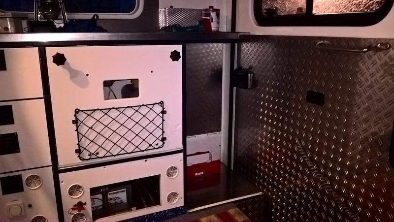

Some more useful things recently added.
Action Packers fit pretty exact under the part that finds use as a third of the sleeping platform.
