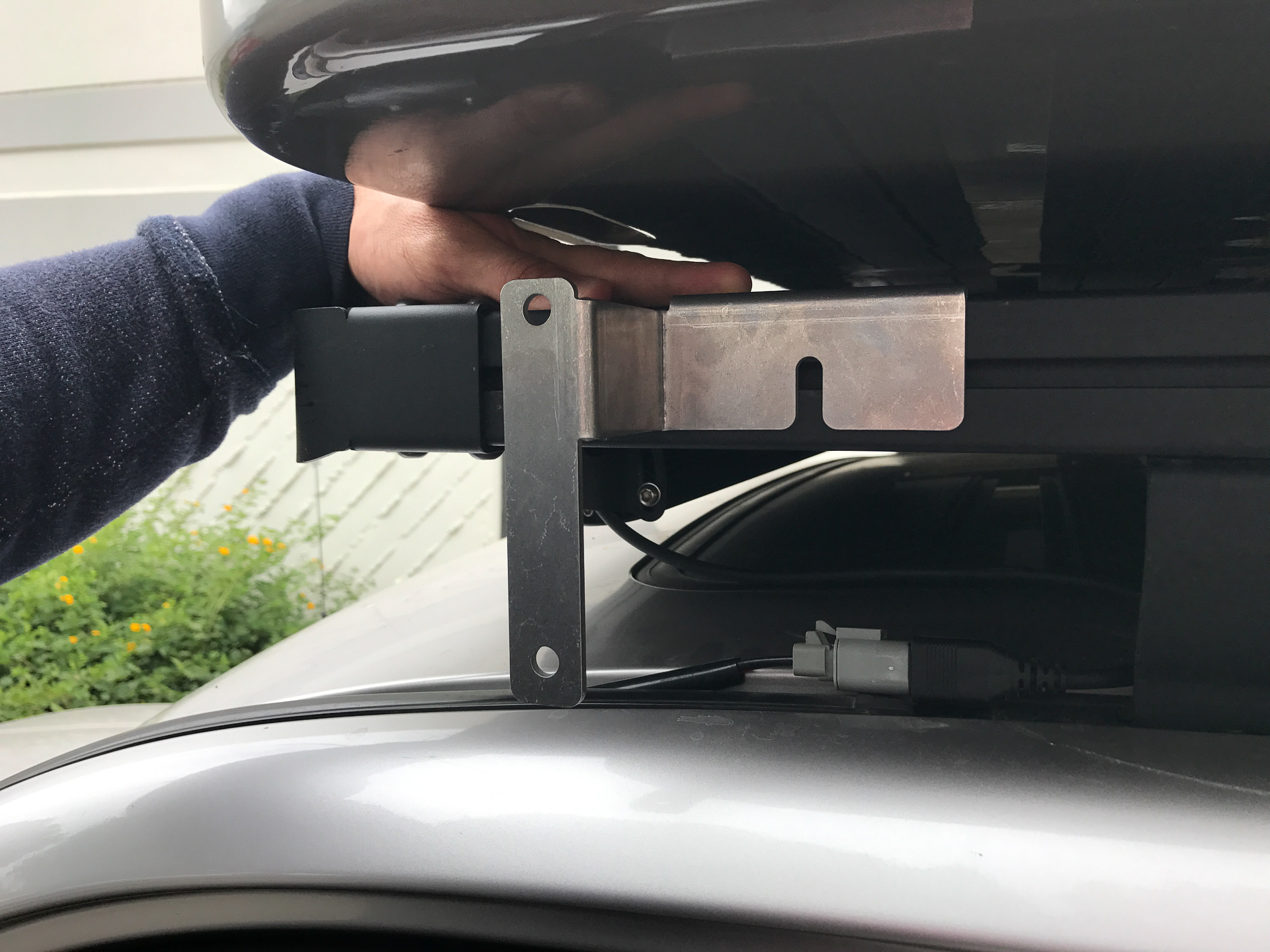

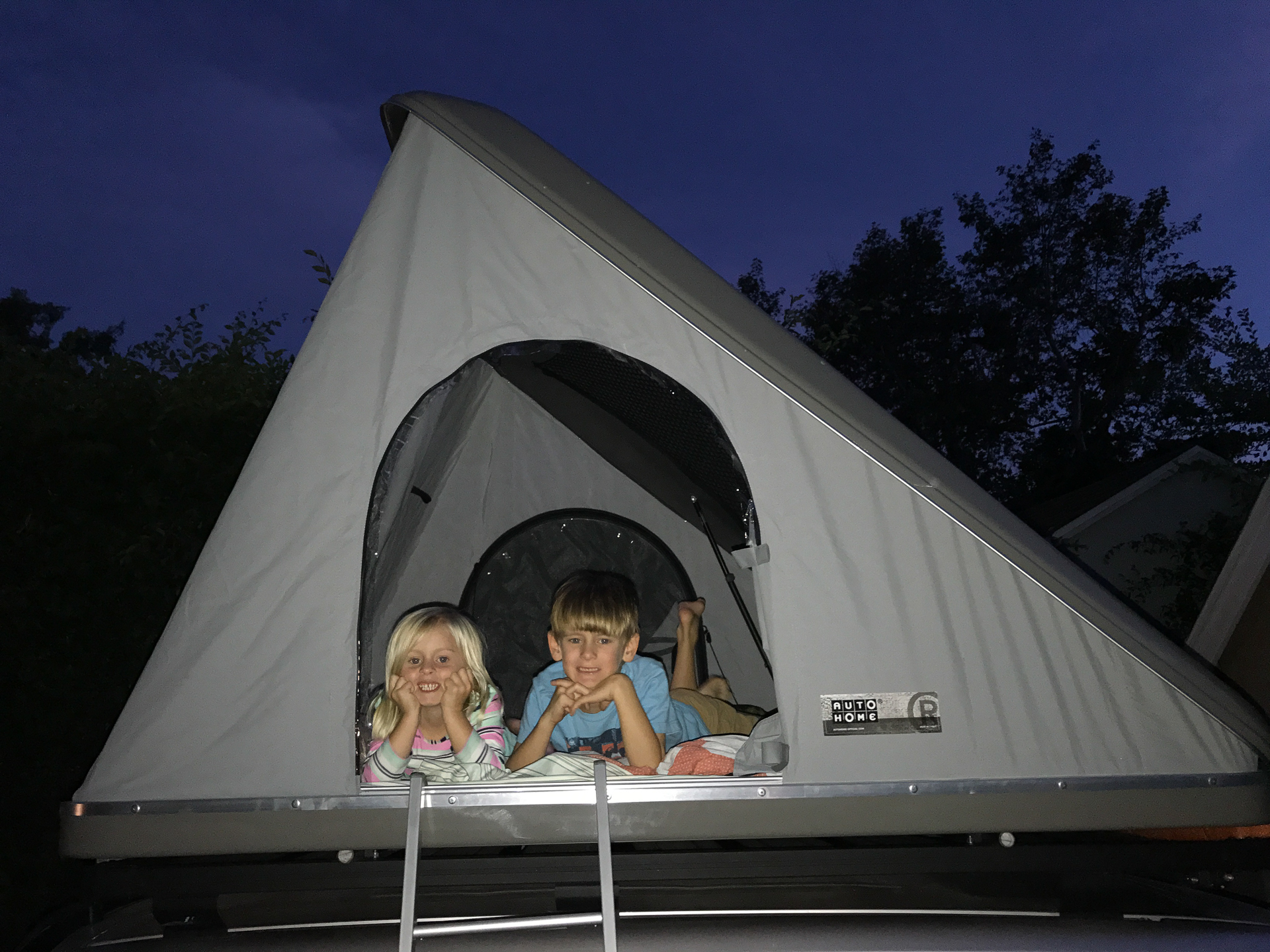

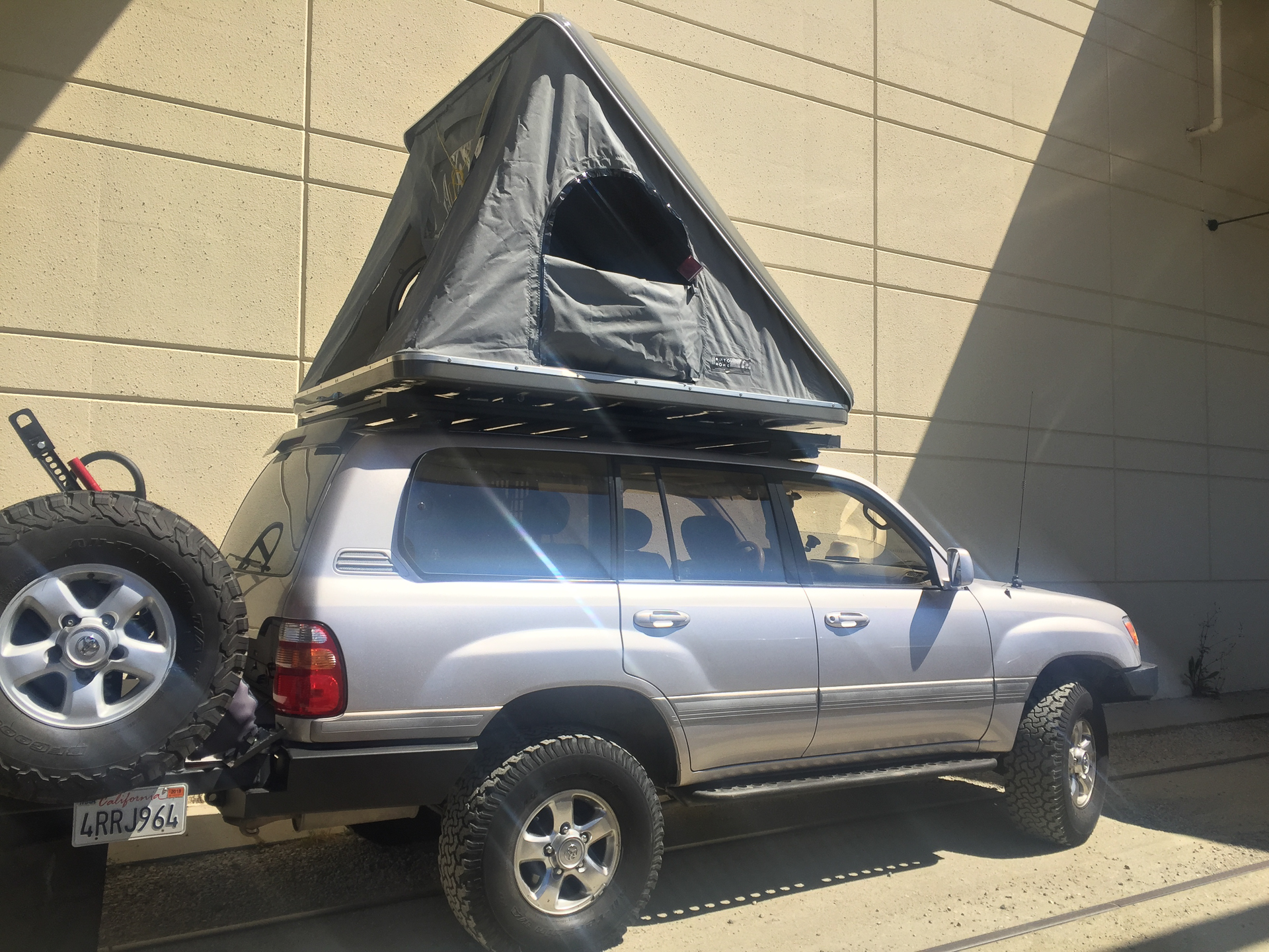

The latest addition to the truck has been an Autohome Columbus Variant Large RTT and some custom brackets for mounting the awning with the RTT.

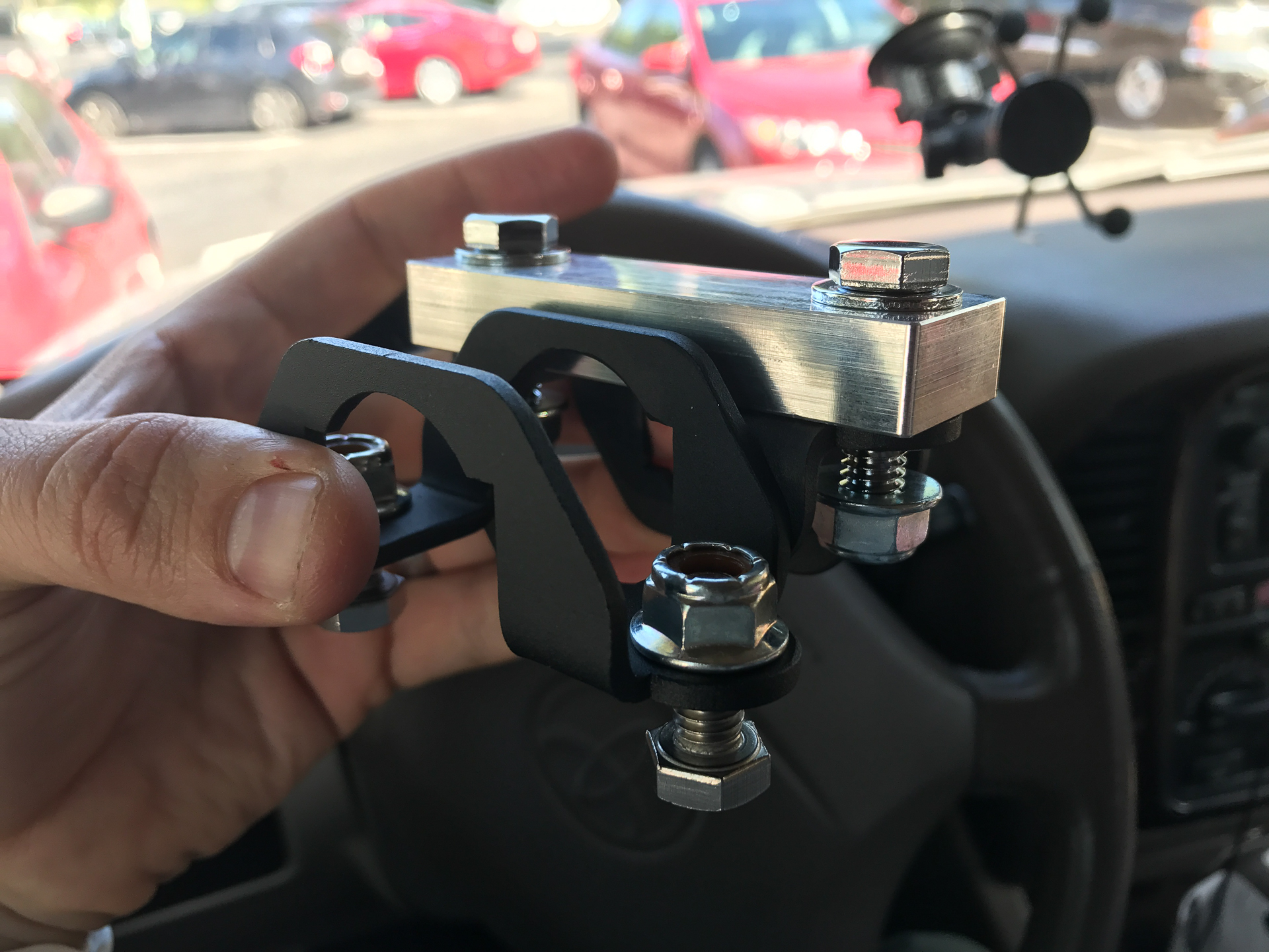

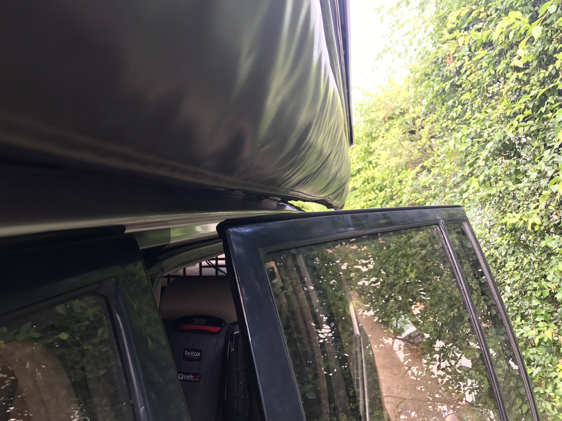

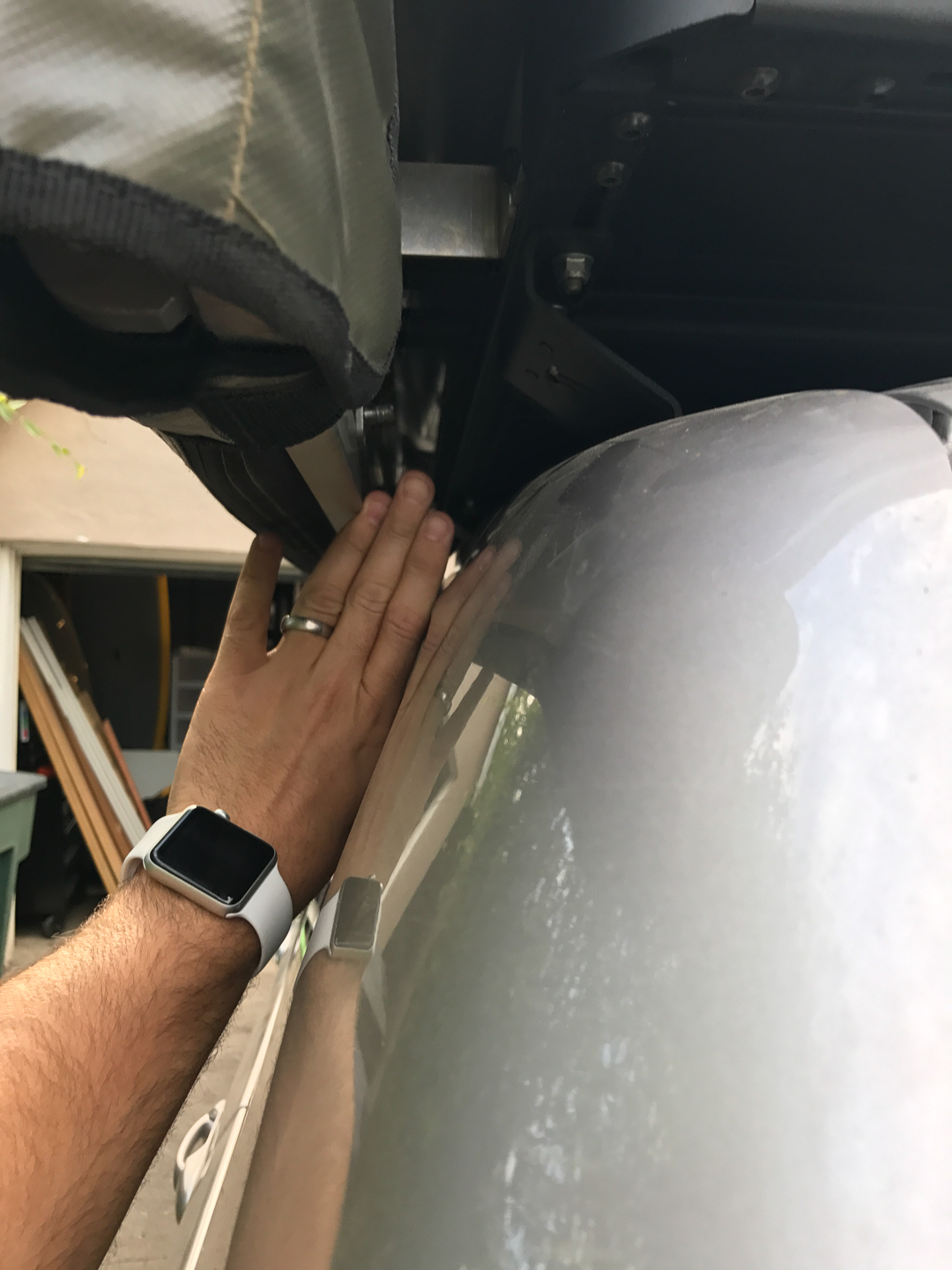

I wasn't able to get the correct standoffs for the tent to mount slightly above the roof rack and leave the right amount of room for the awning so I had to use Yakima crossbars with the labrack crossbar bracket and then machine a custom spacer to lift the tent a bit higher. It is not ideal but it works. It has a bit more flex than I would like to have in the setup.
The Columbus Variant Large is big enough to sleep all four us. it is not spacious but it gets the job done. The RTT got us out significantly more in 2017 than any other year. I was particularly able to go camping with just me and the two kids super last minute many times.

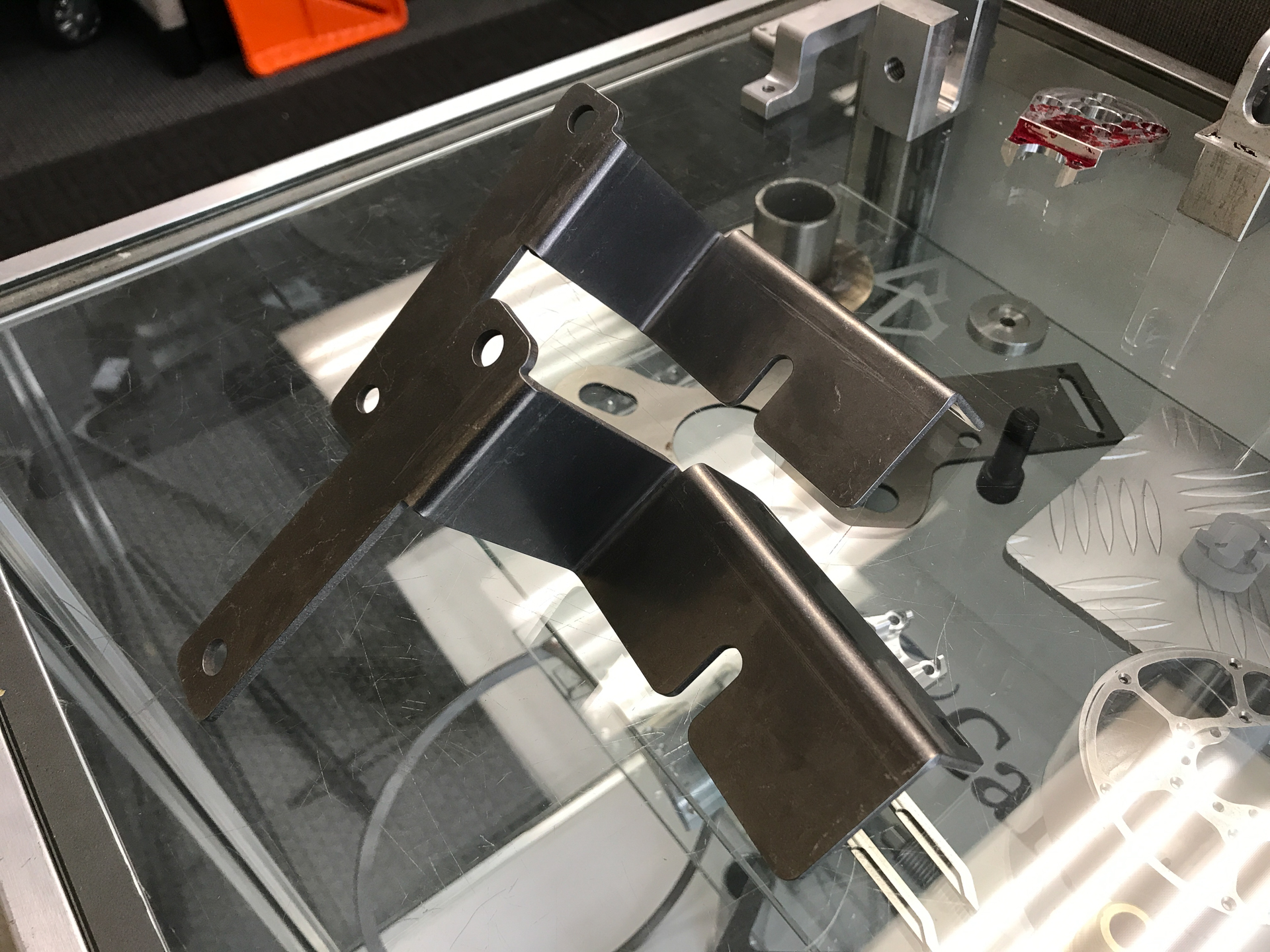

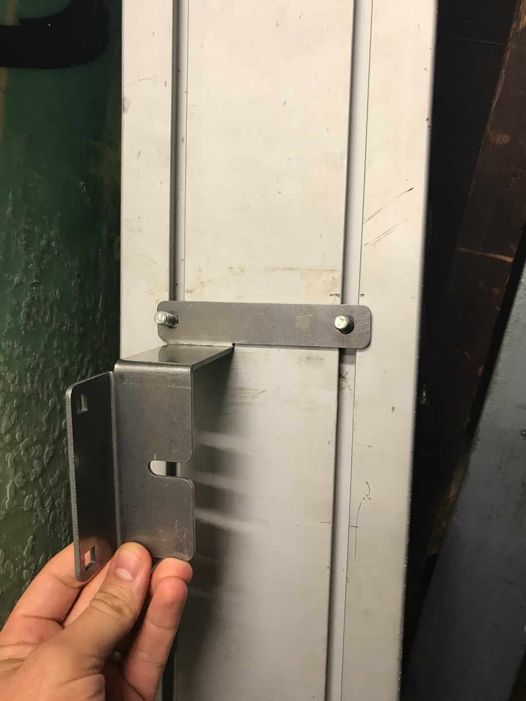

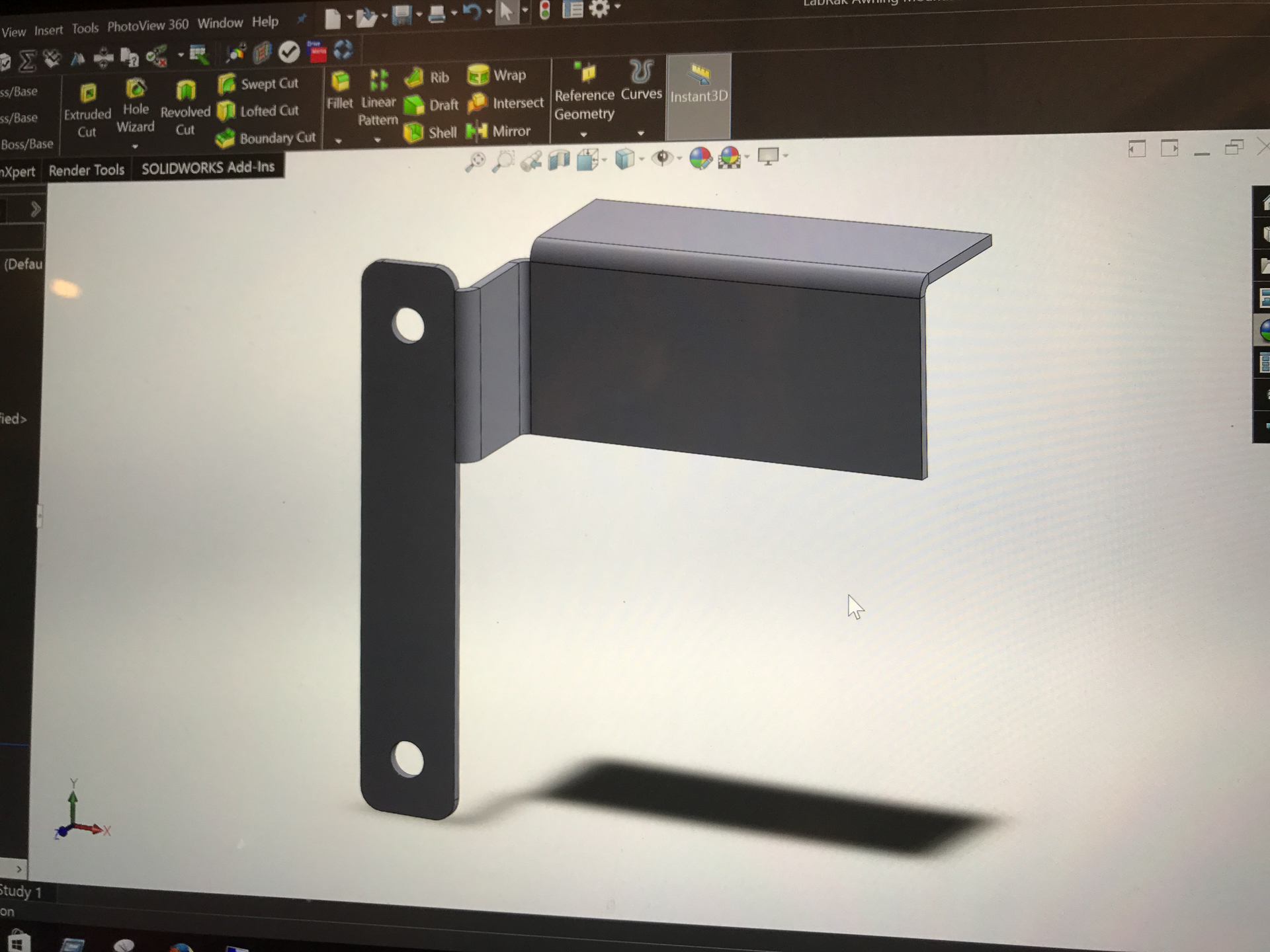

Give the tent is super ridiculously wide I had to re-think how to attach the awning. I had to space the tent high enough to give me room between the bottom of the tent and an open rear door for the awning to live and deploy. Thankfully I have solidworks and a sheet metal shop down the street. Some quick measurements got me to a custom bracket in a few minutes.

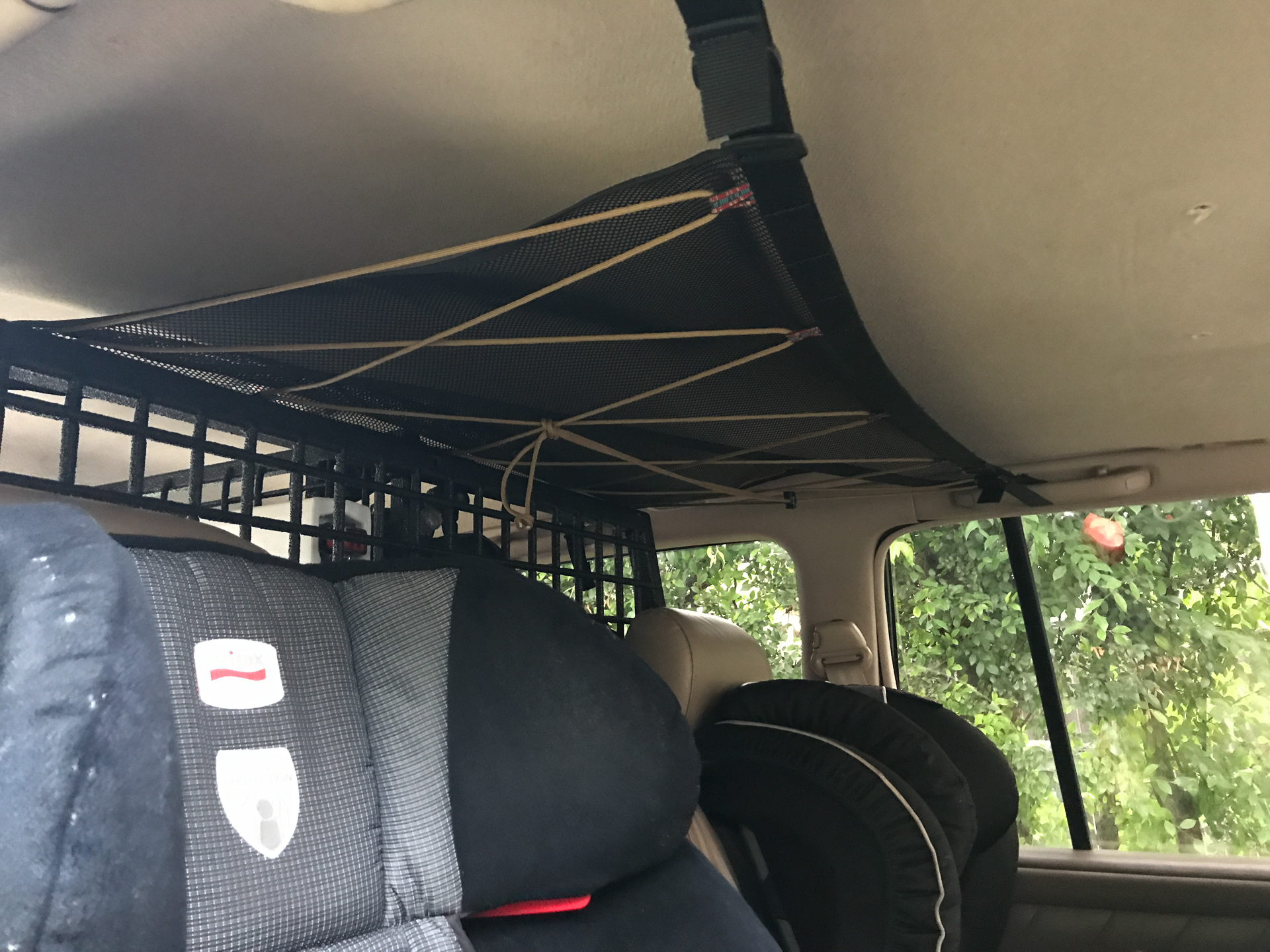

The blueridge overland loft was an AMAZING addition. This one thing revolutionized the interior storage. It got all the kids jackets and blankets in cold weather up off the floor.
