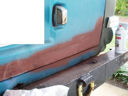

Got about four hours in today. I was able to patch up one big hole (4 inches x 16 inches) and welded together a big 'spider-web' crack on the rear tailgate that measured about 6 inches across and had about six cracks radiating out. My camera battery is dead right now so I'll have to upload some pics tomorrow.
Found only one pic on my camera from last weeks wheeling and camping before my camera battery died.
Here are some pics.
Pic 1) Left side w/ rust cut out. Right side (pic 2) looked like this.

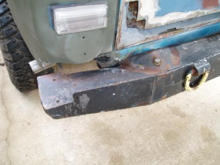

Pic 2) Right side w/ rust cut out and metal replaced.

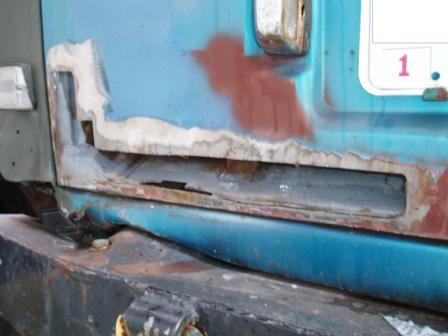

Pic 3) Spider-web crack welded shut. There was also a ~ half inch hole here I guess from the PPPPO's tire carrier. It was welded shut.
