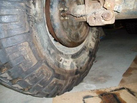

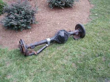

Pic 1 - donor axle from FJ40-40, Thanks!

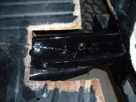

Pic 2 - IPOR body mount installed w/ two coats of POR15...ooooo shiney! Trollhole did most of the installation of the mount with some help from VTcruiser. During final assembly of the mount Trollhole left some drain openings in the mount so any water that finds its way into the mount can drain past the bolt X and through a hole near the slider.

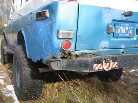

Pic 3 - 'the hole'

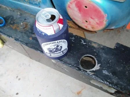

Pic 4 - driver's rear quarter - I'll have to look and see if I can find a before picture but it was basically crushed in and had bondo flaking off. I still have more work to do but its getting there.

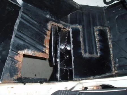

Pic 5 - Its what you don't see - brake fluid puking everywhere

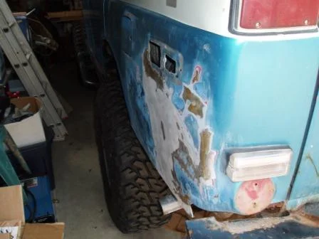

Pic 6 - floor board patch I installed last night above IPOR body mount. This patch has been one piece that would cover the entire hole but the bend got tricky so I hacked the piece into two which made the entire process MUCH easier. I didn't get the last lower 1/2 patch installed. I called it a night and spent some time w/ the wife. This last little patch is the last one I need to install to finish my floor patches! I still have to clean the floors, do a light sand/scuff, clean again, and put down one more layer of POR15.

Here is a pic of the rear driver's quarter just before purchase for comparison. Dent at light has been popped out (it came out pretty easily) rust cut out, sanding/shaping started. I've started work on the passenger's side but the big dent on that side doesn't want to come out. We even put a 2 in square piece of metal in and beat on it with a BFH with little results.

What are you gonna do with that axle?
Rear quarter looks good!
My own photos come back to haunt me! :doh: IH8BONDO! :mad: That's old bondo I'm pretty sure, from before TJK...

The axle was used for the drums. I thought I was going to use some of the wheel cylinders but I ended up purchasing new Toyota cylinders. I need to pull the gears for the PO.
That bondo is pretty old but it appears to have been applied VERY well. I'm not removing all of it - only gring off what needs. Its looking pretty good using that methodology.
