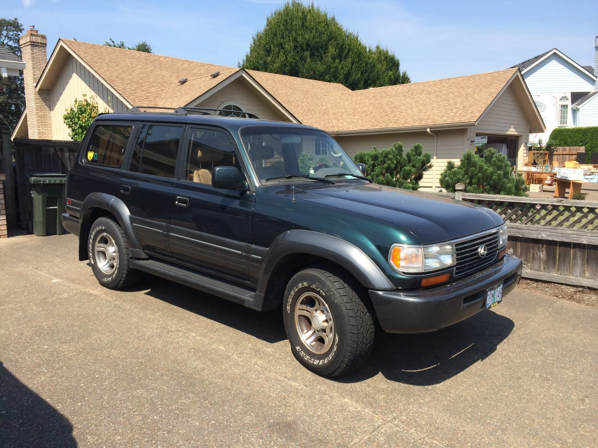

Enter the 1997 LX450

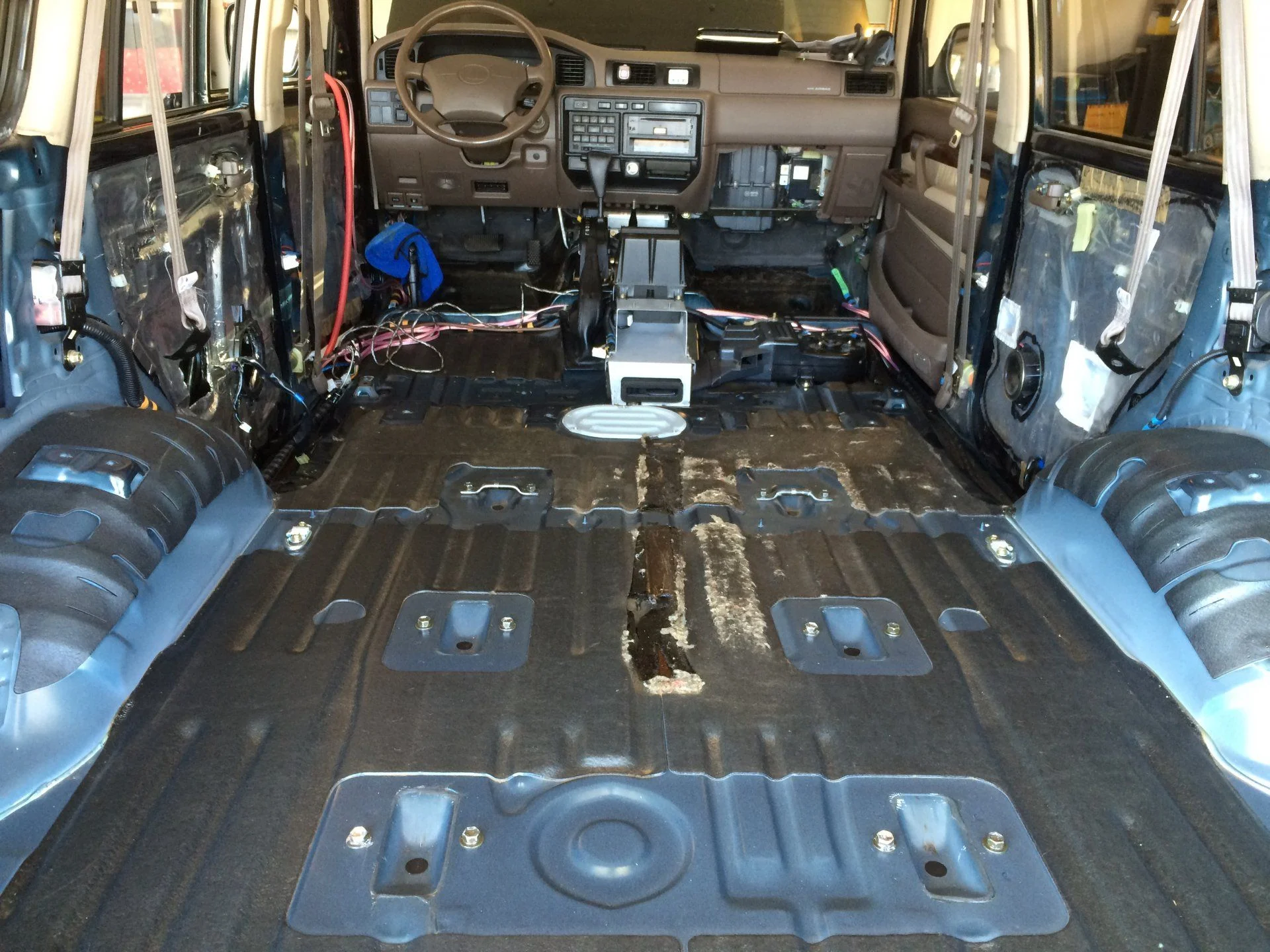

Day 1. Rip out the interior as it smelled like crap. Once I got in there, found out the front windshield had been replaced and was leaking. Had my local window guy fix it for $50 bucks. Pressure washed the carpet and removed the jute foaming. Added new auto carpet padding to replace the foam. Carpet is better then new now.

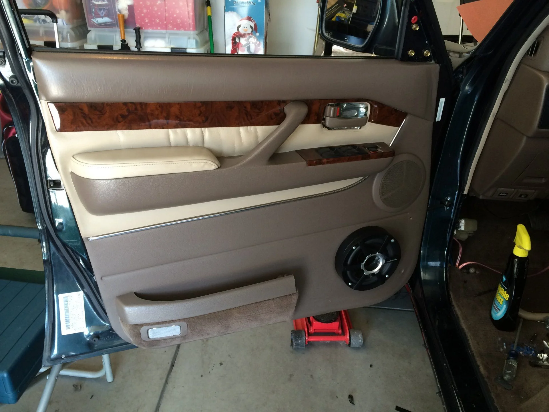

Day 3. Cruiser Crap

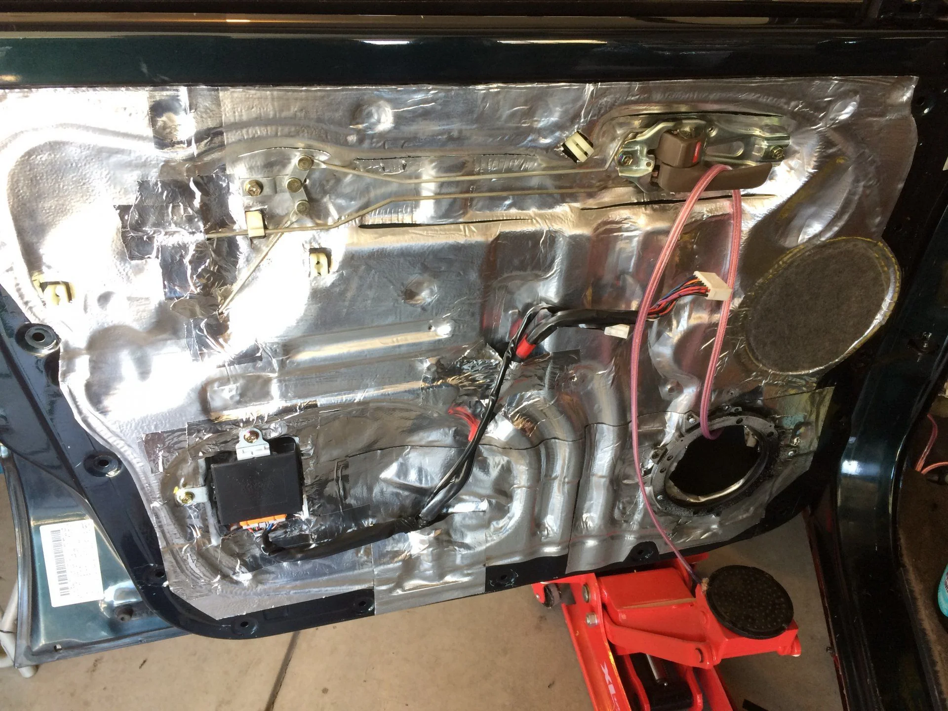

Since the whole interior was out, thought I would try Cruiser Crap for my doors. With the need to relocate speakers, this would allow me to plug no longer needed holes.

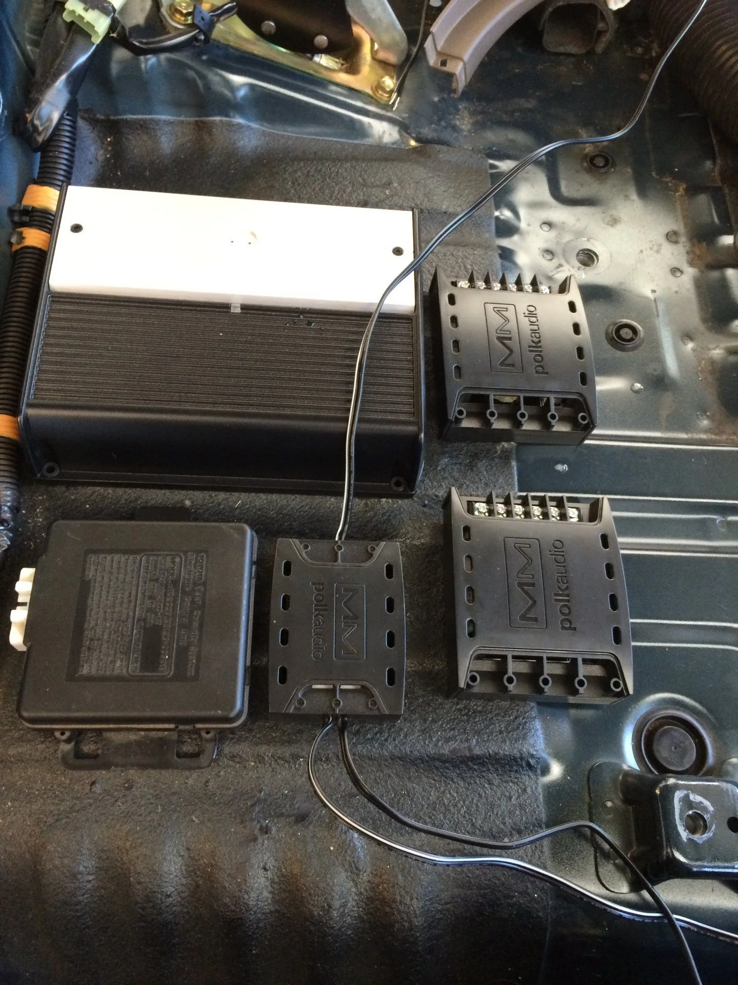

Day 4. Stereo Install
The poor stock audio had seen better days, now its time to crank it it up. Polk MM6501 in the front with Polk MM651 in the rear door. Powered by a JL Audio XD400/4v2 with the signal from an Alpine CDE-164BT

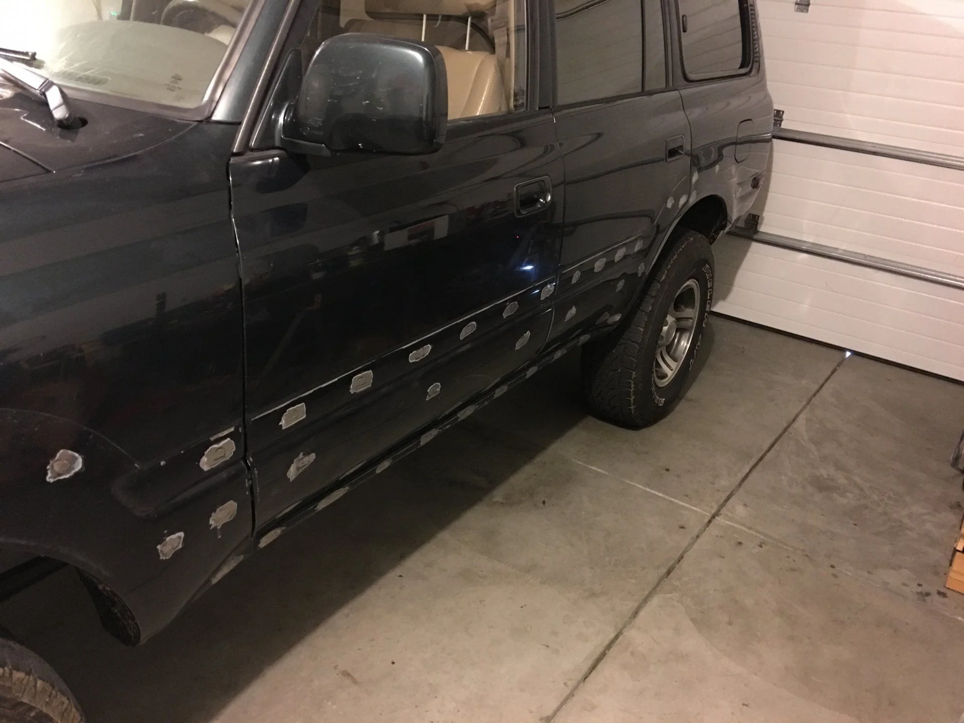

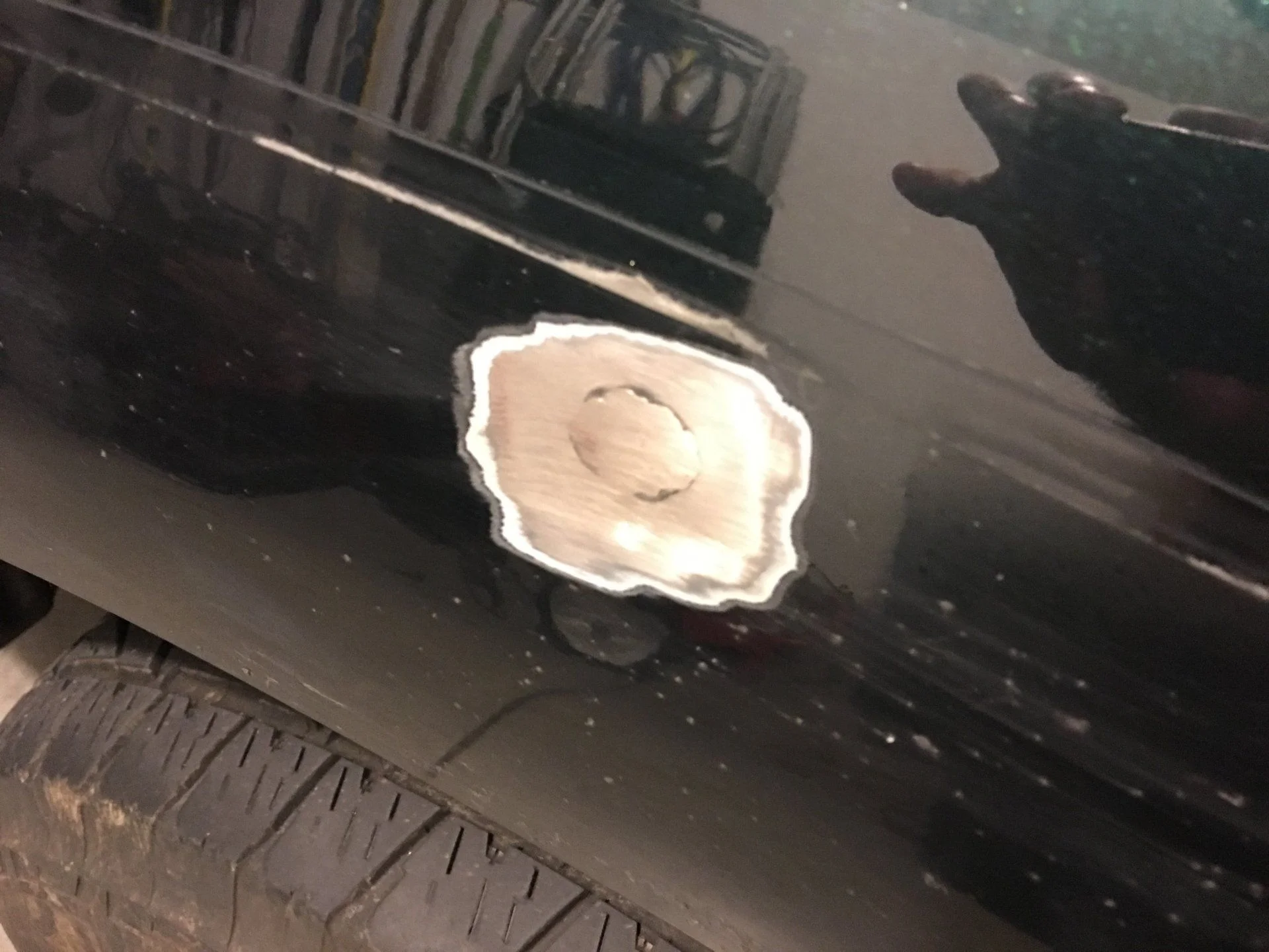

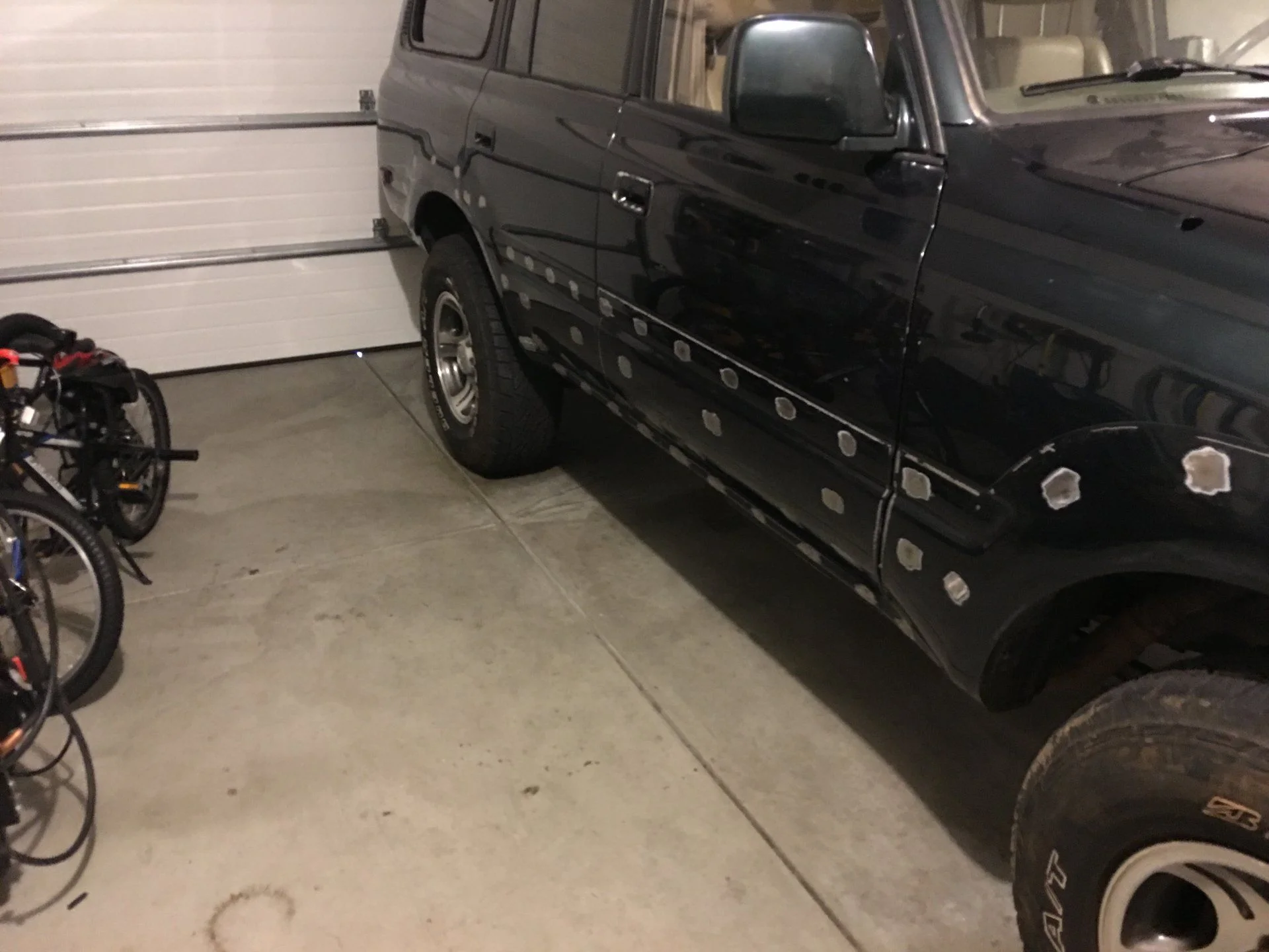

Day 5. Welding :-(

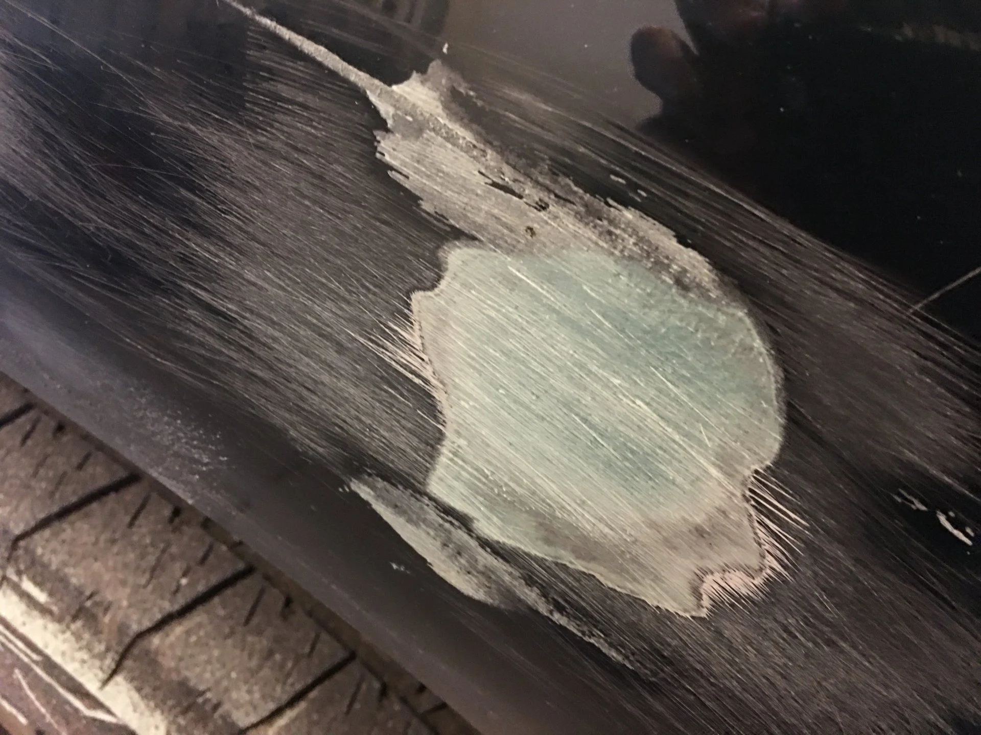

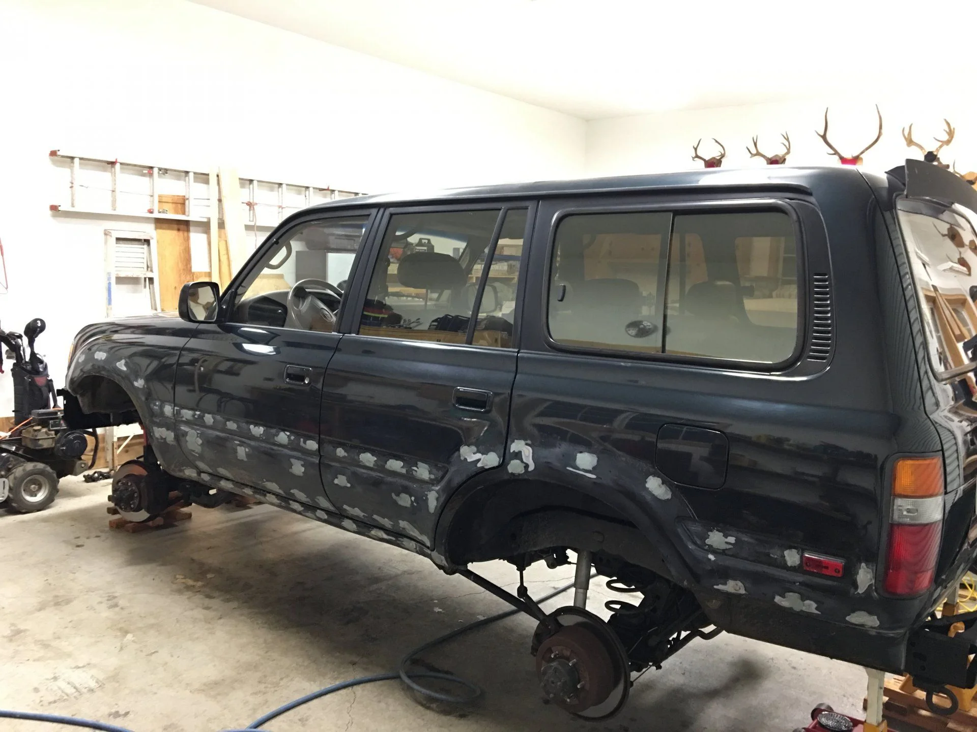

So, had my friend come over and together we learned body work. He welded the many holes left from the body molding and the roof rack. In the end, he welded, I ground them down and did the fiberglass fill body work.
Before
After

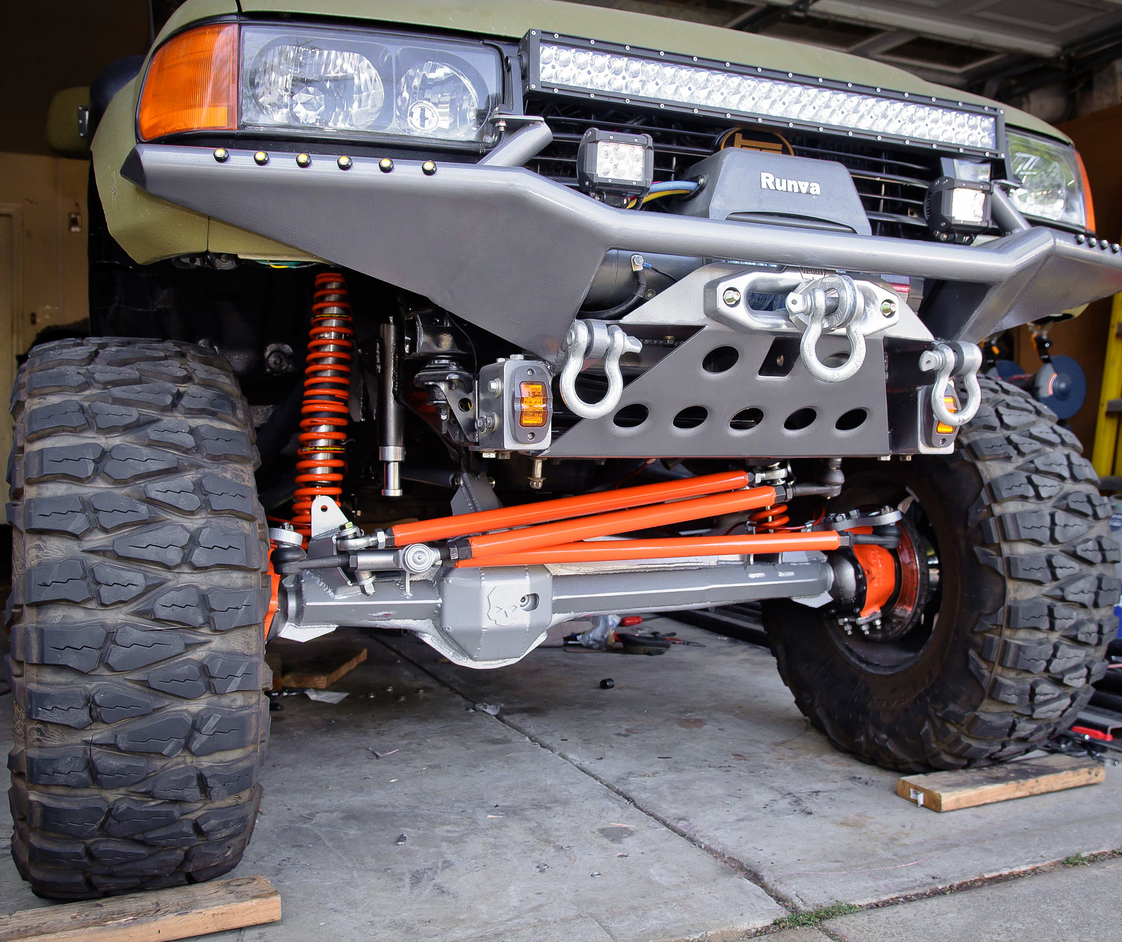

Now, On the 6th day, we begin "The Rebirth: FJZilla 2.0"
This is the day where we take this hidden beast and let her out!
This is the day where we add

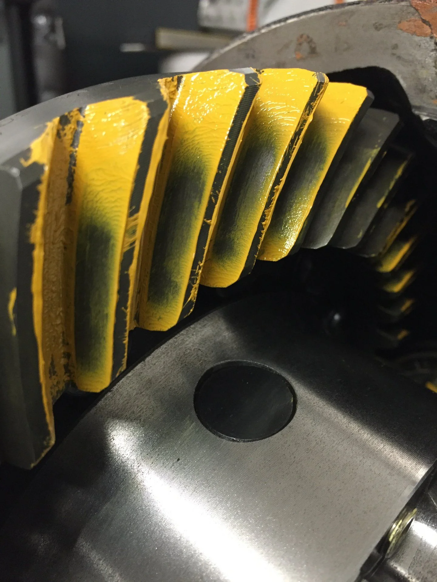

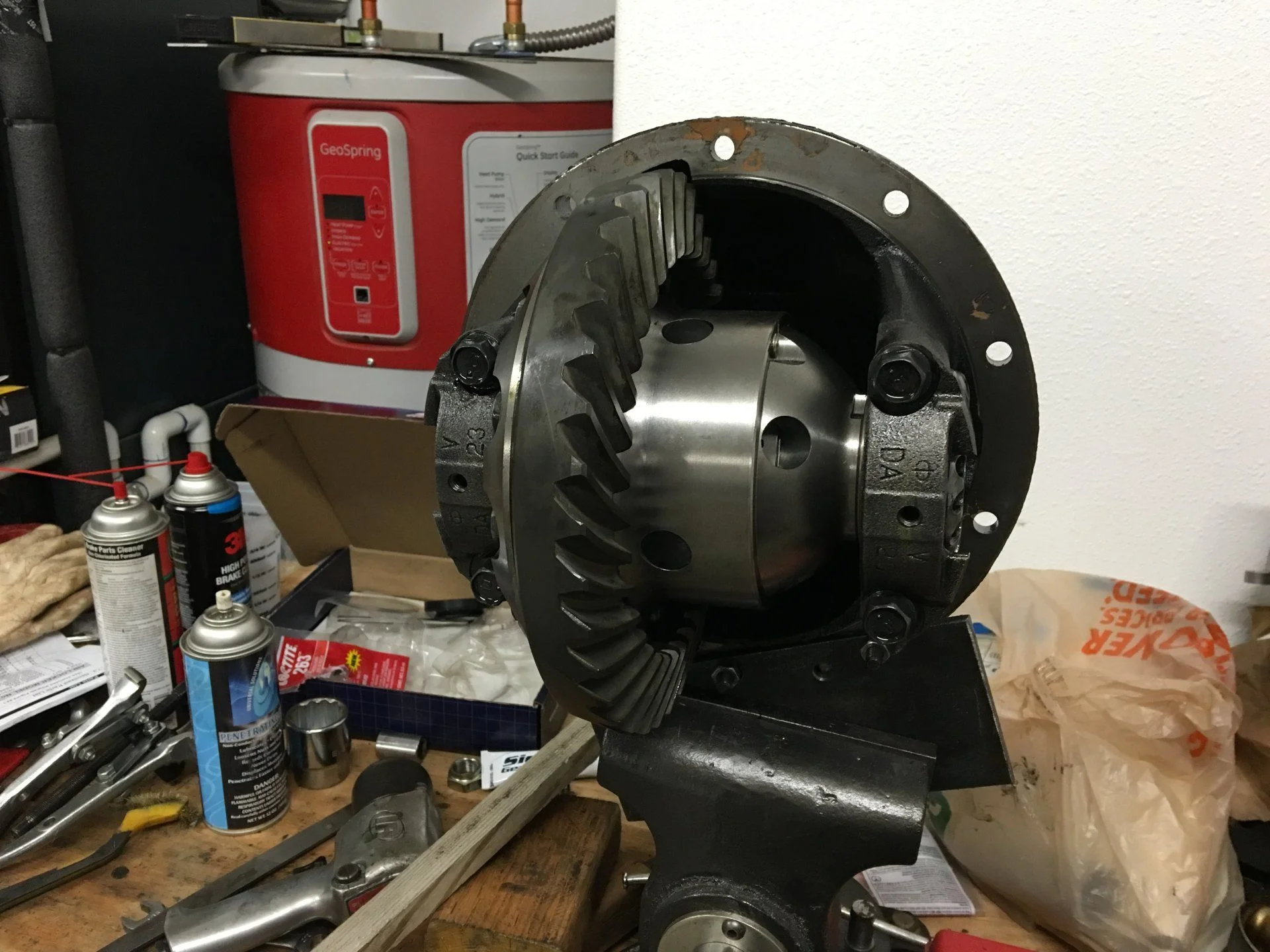

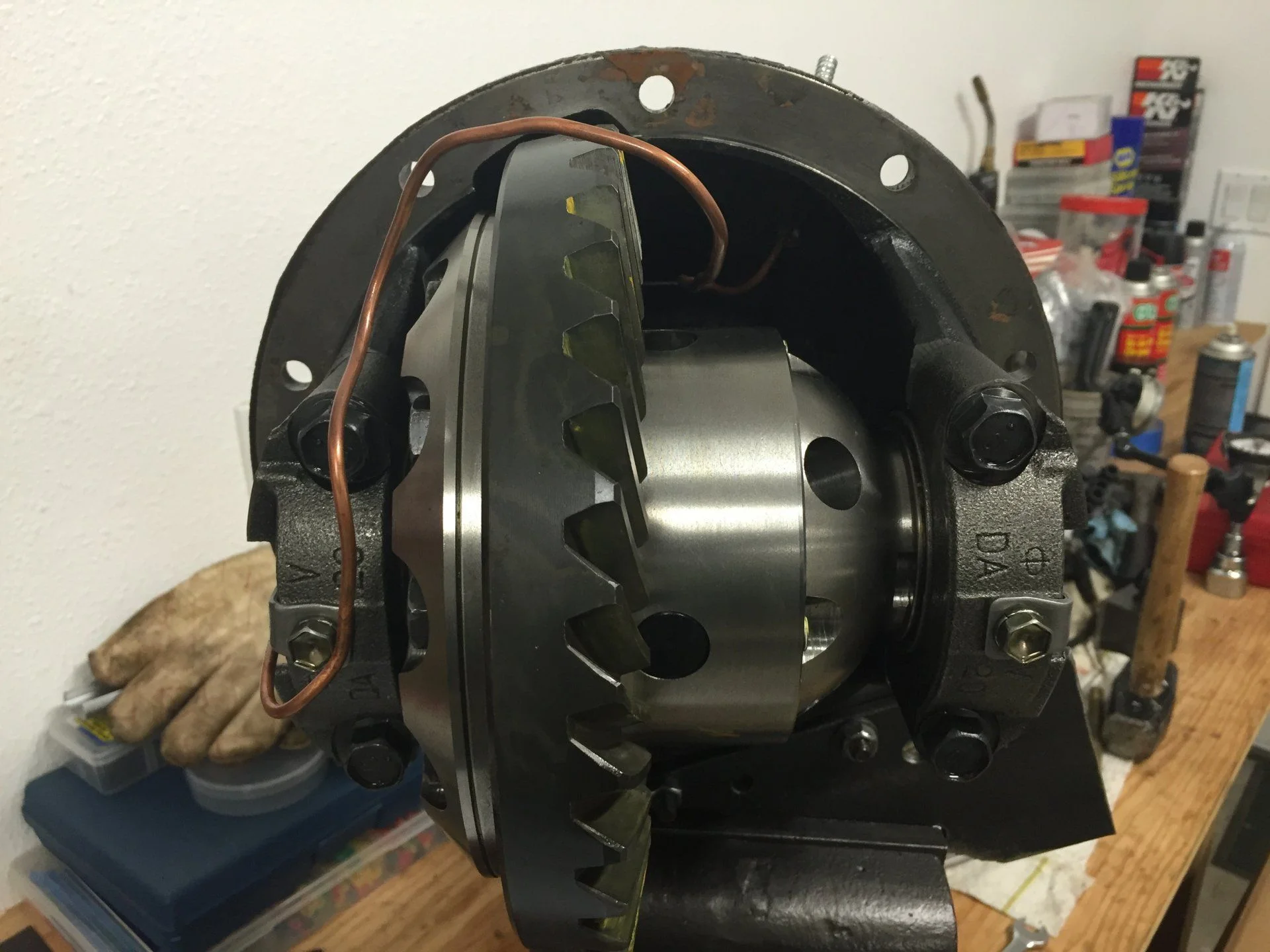

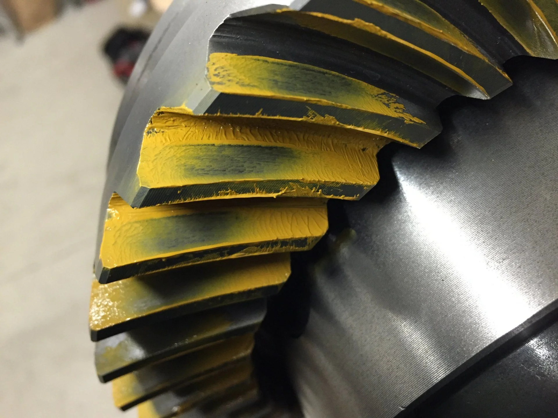

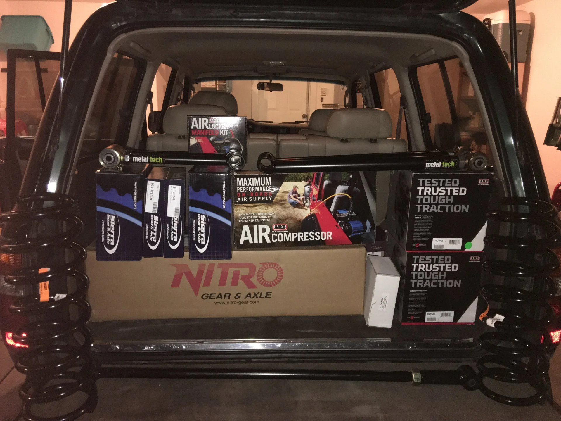

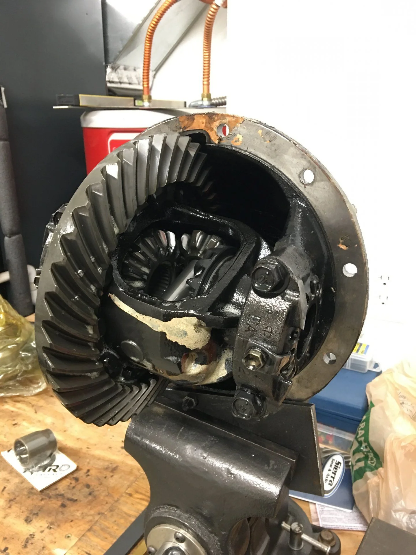

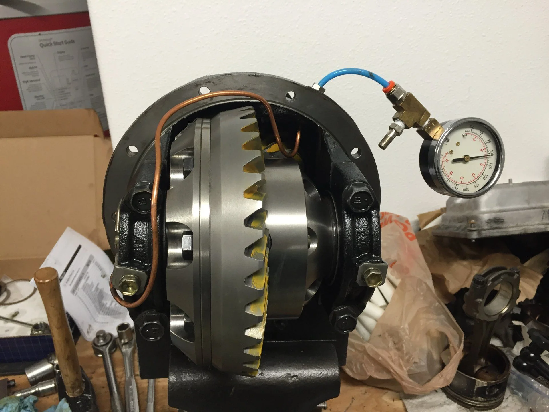

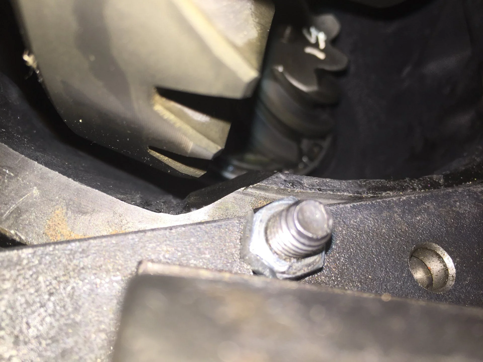

Front and Rear ARB Lockers matted up with 5.29 Sierra Gears.
New ARB 5" Comp Coils
OME Rear Adjustable Panhard

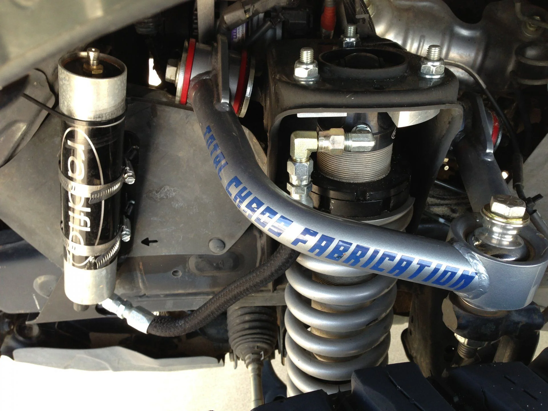

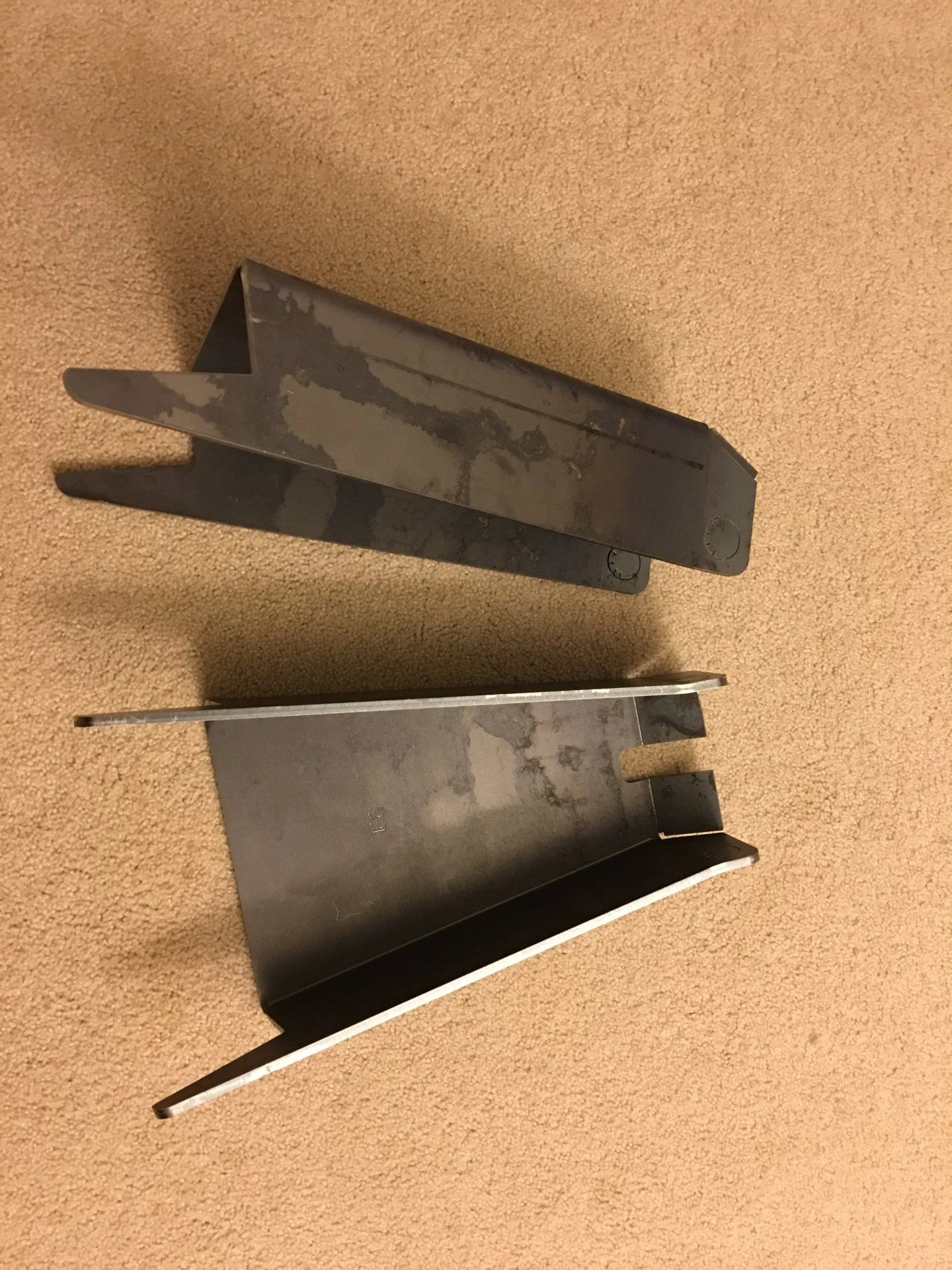

New Rear Upper & Lower adjustable control arms from Metal Tech

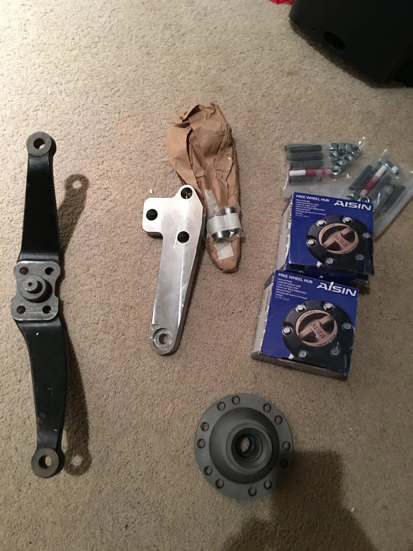

Nitro/RCV 30 Spline Front Axles
Knuckle Rebuild Kit W/Koyo
ARB Twin Compressor

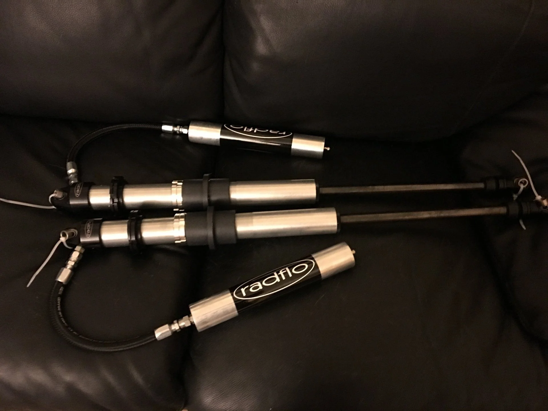

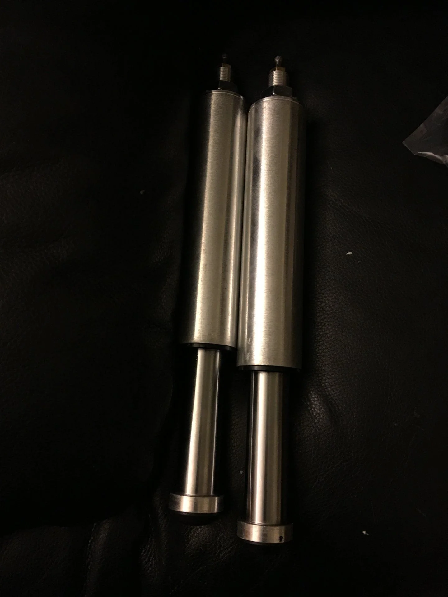

Radflo Shocks with remote Resi
37x13.50 Toyo MT

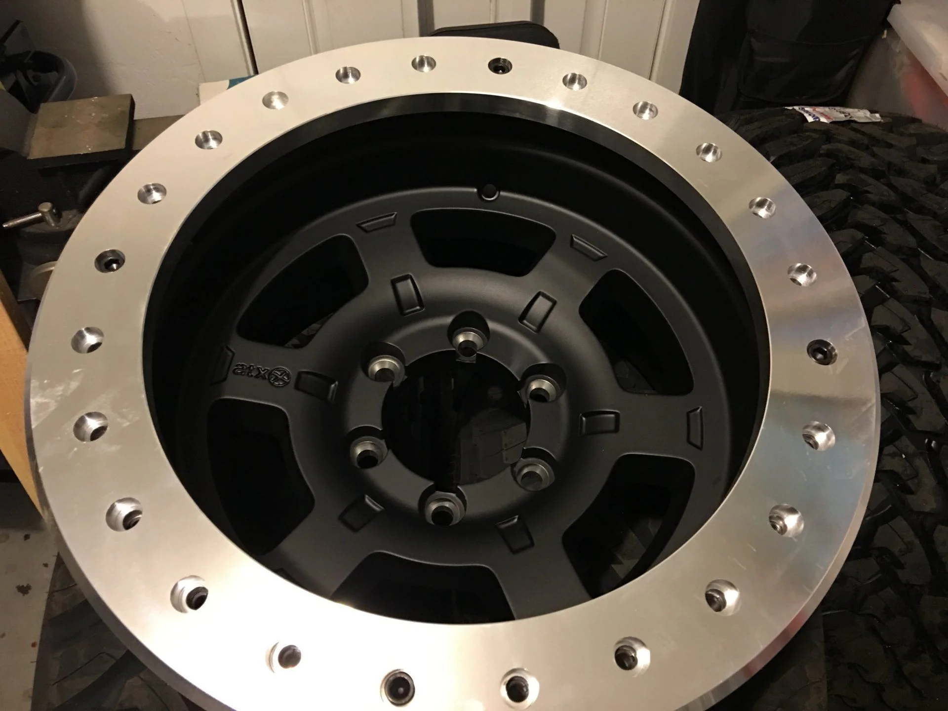

Black AX757 CHAMBER PRO II Beadlocks
and lastly, @4WheelUnderground Stage 3 3-link for the front.

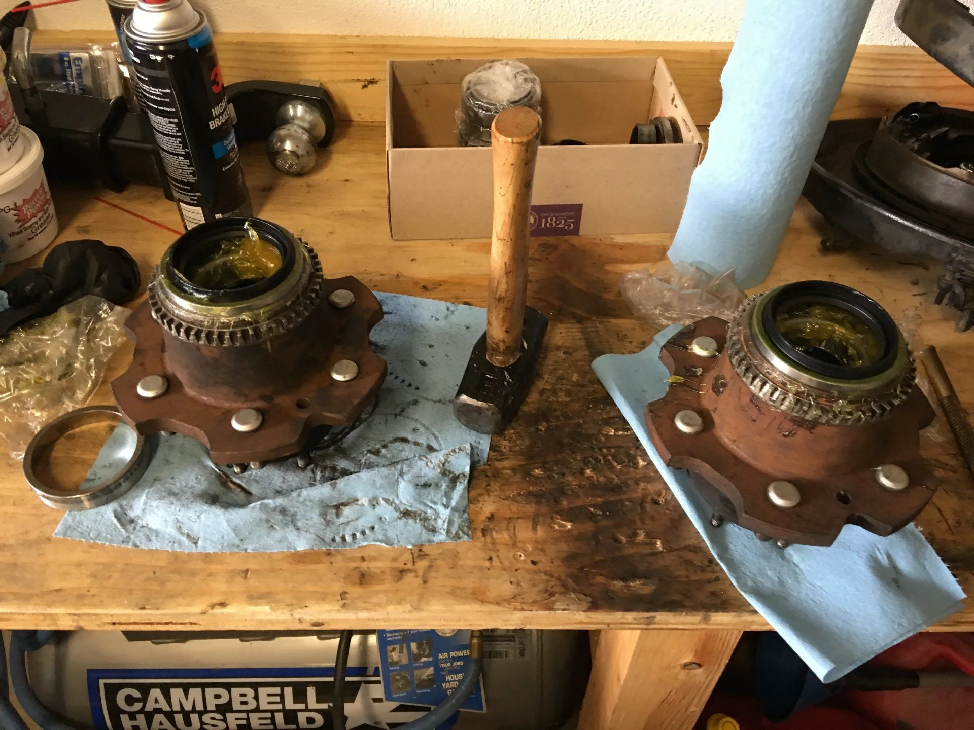

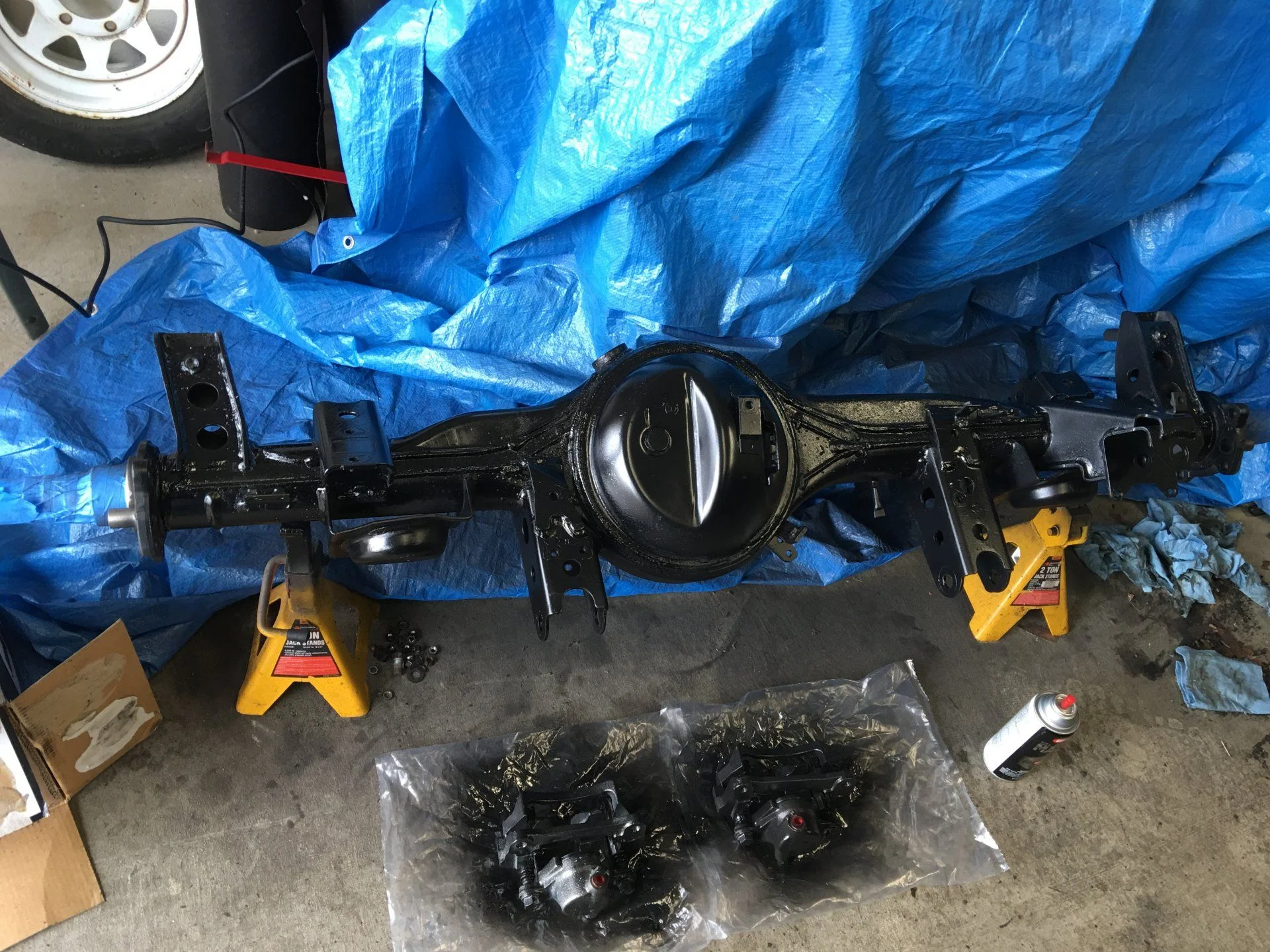

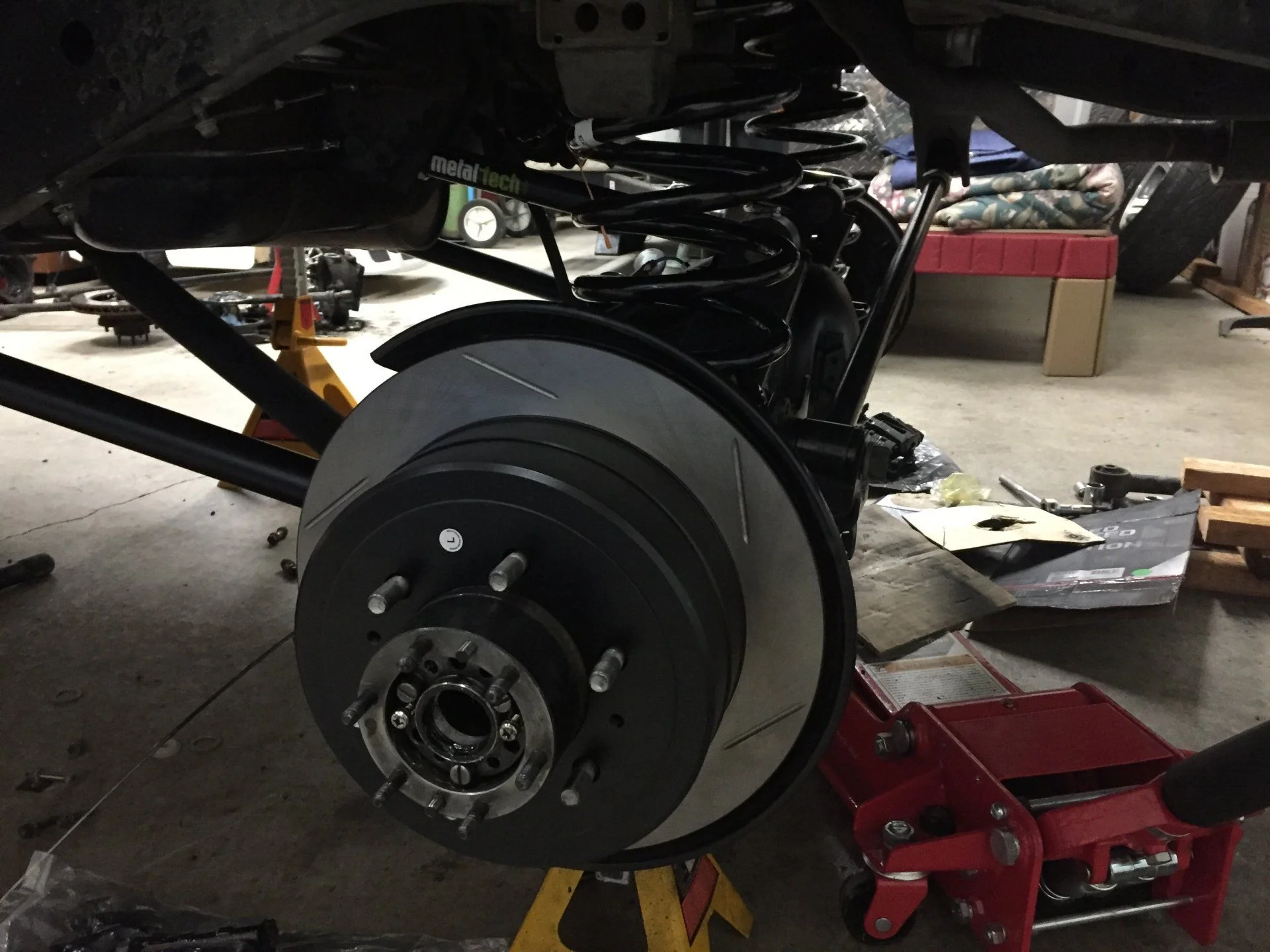

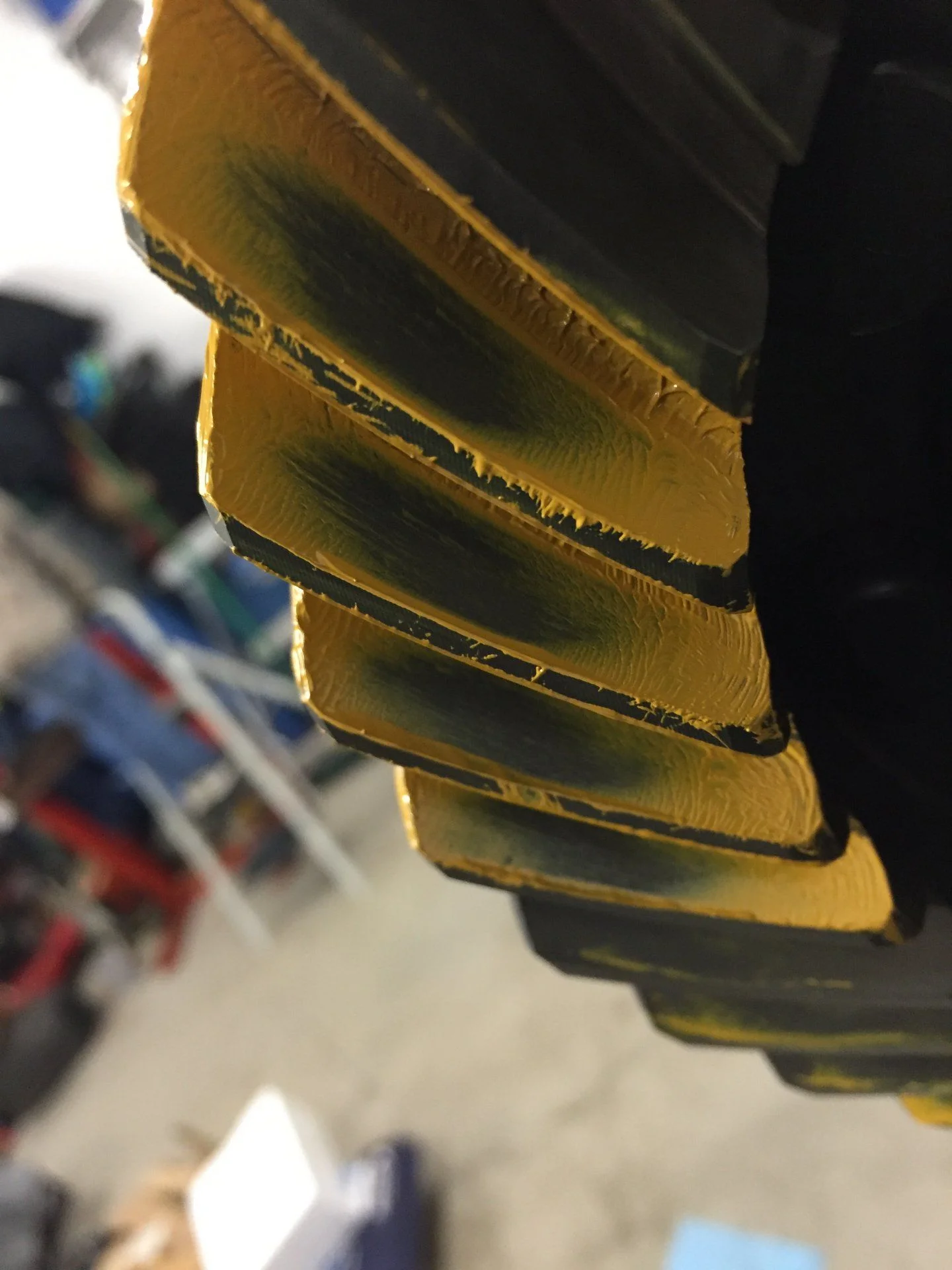

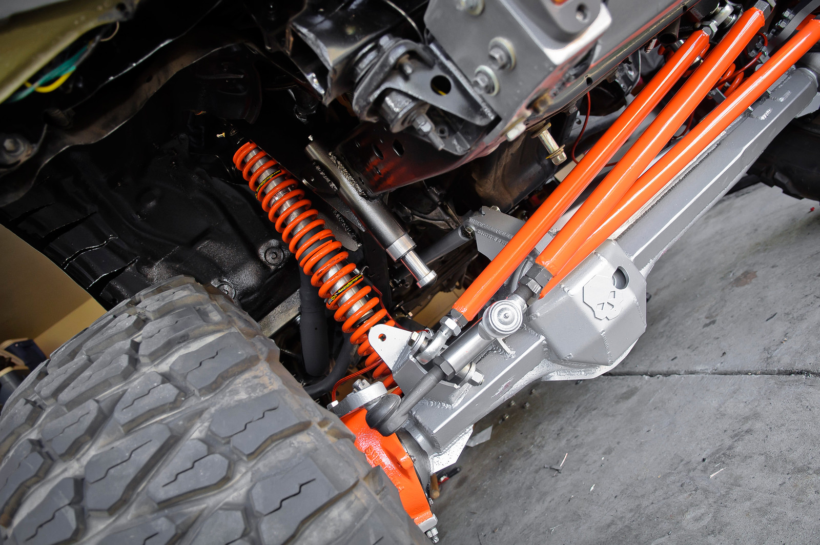

Slowly removing front and rear axles for rebuild/cleanup
Out with the old and busted
In with the new hotness

Day 3. Cruiser Crap

Day 5. Welding :-(
Before
After
