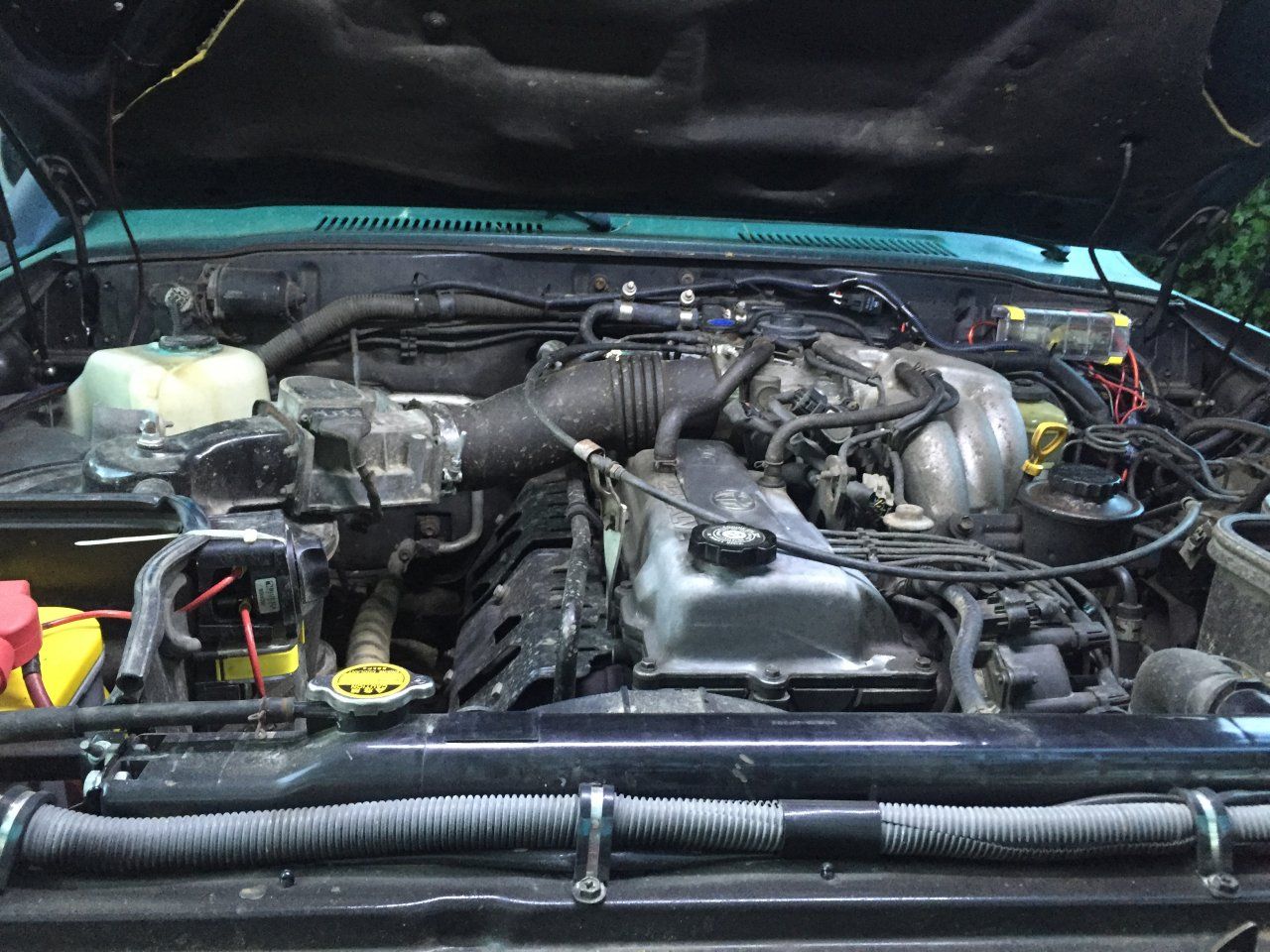

Cleaning up my wiring abit when i changed the radiator imoved the dual battery wiring from under the radiator crossmember to on top also switching out to military leads on all 4 terminals
Still need to add a bus bar for grounds and one for ignition hot for relays i would like to pull a clean power line where is a good spot to do that? Alternator?

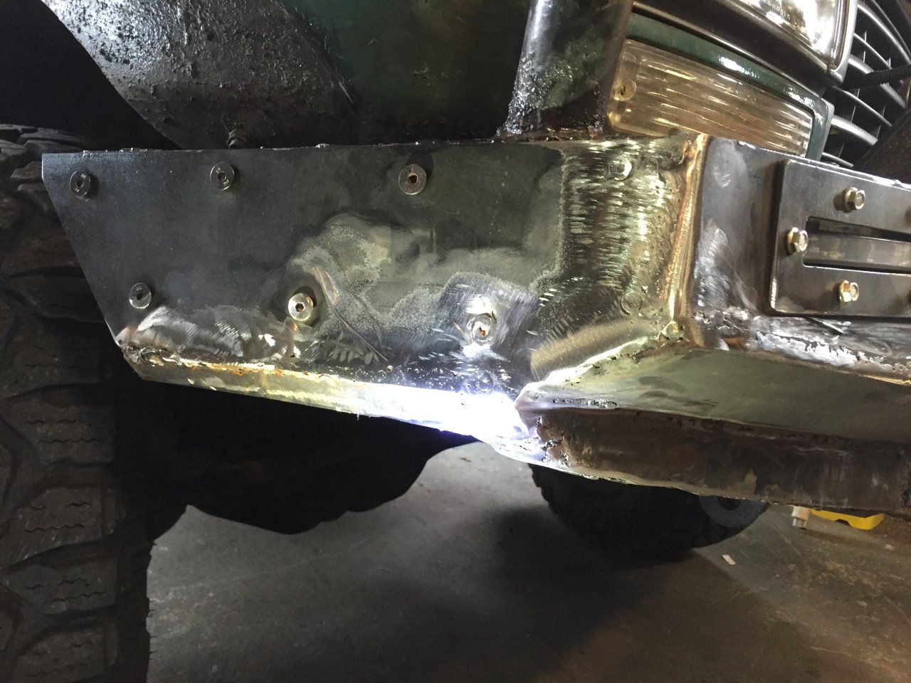

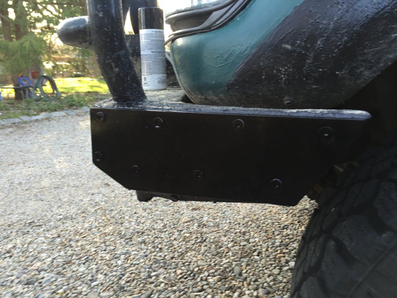

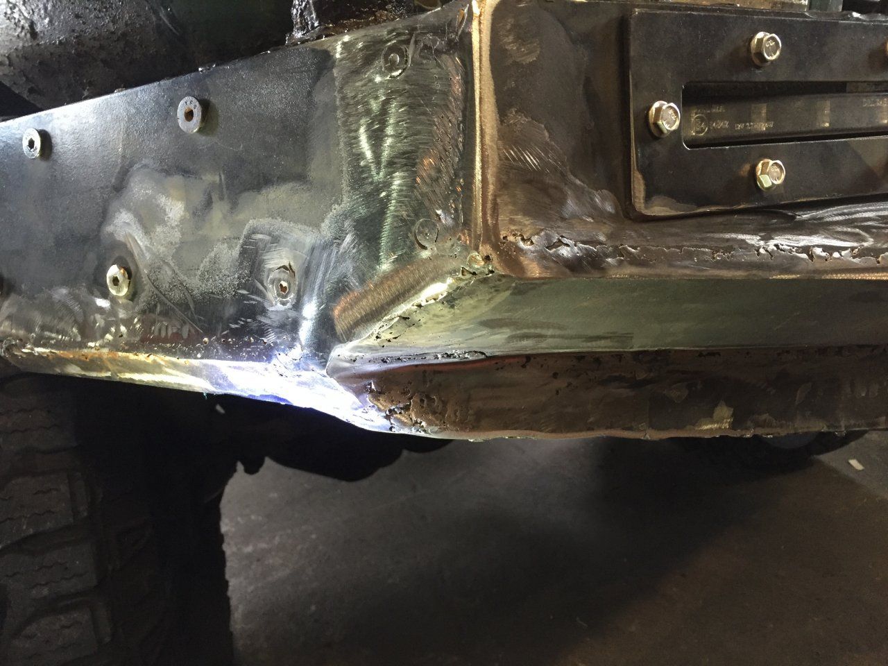

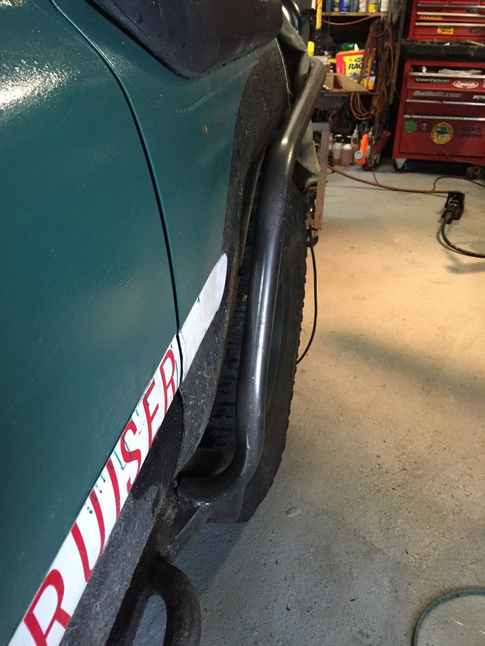

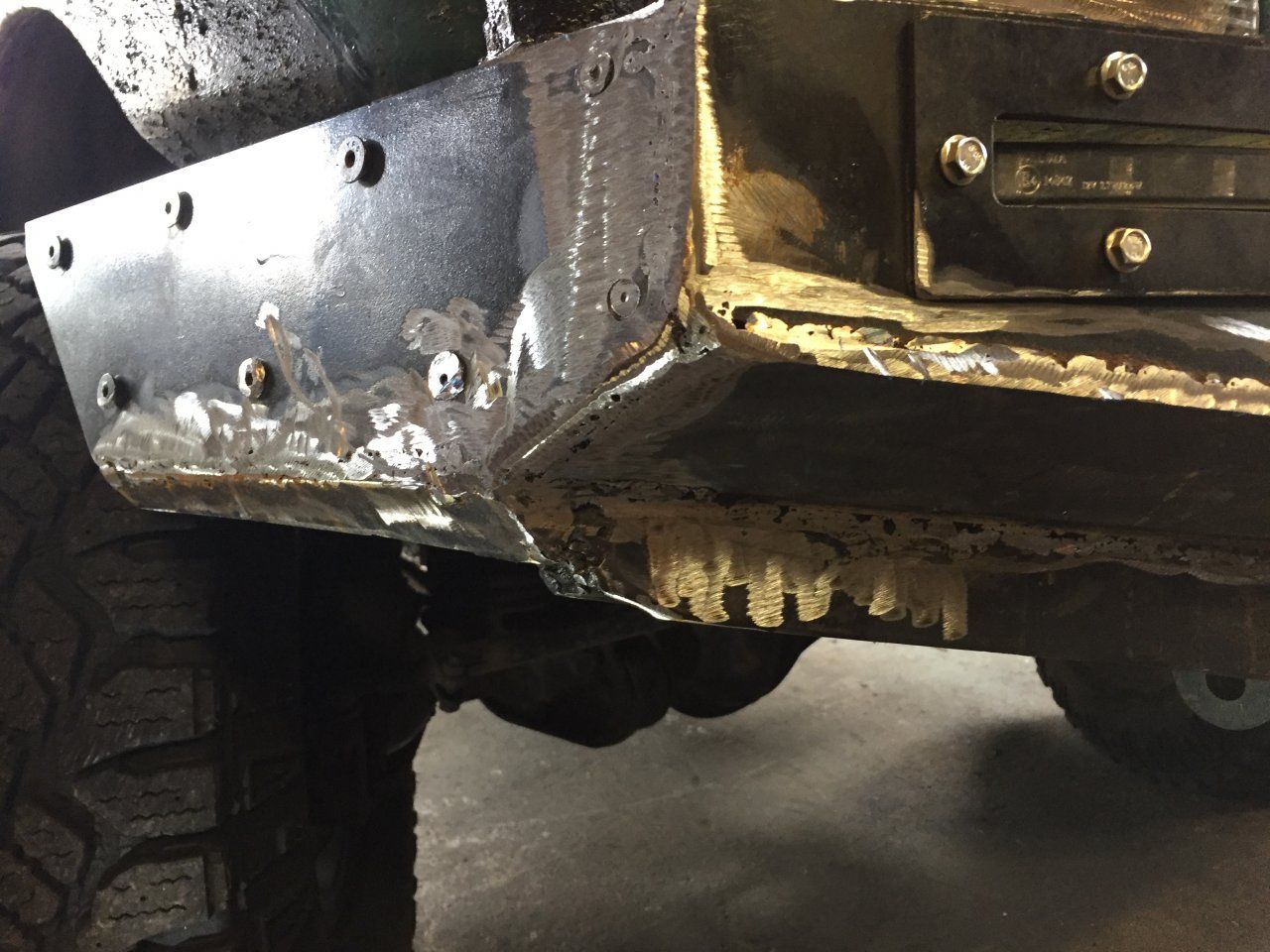

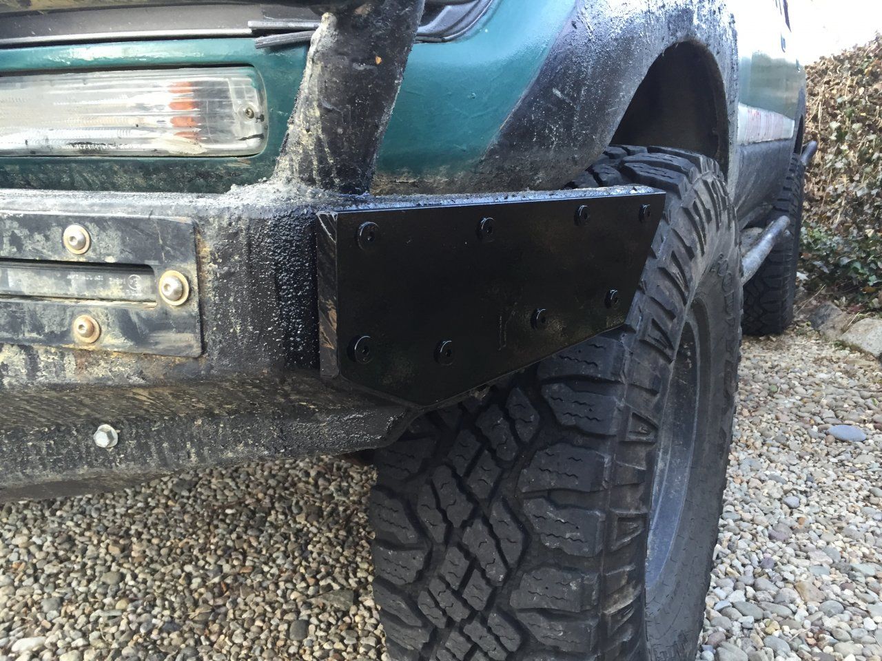

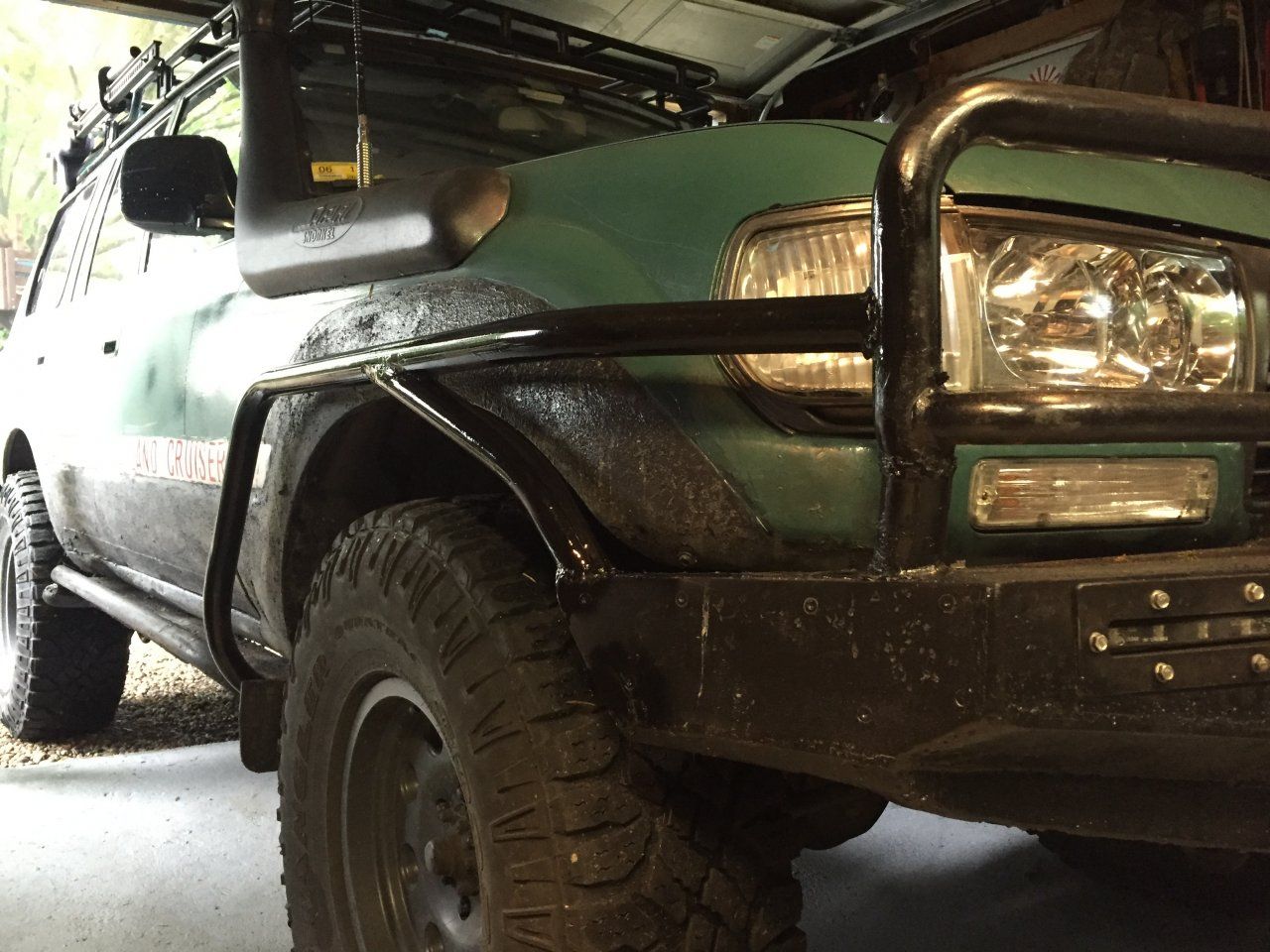

So i went wheeling with another 80 (foxfab) on some tight atv trails close to home and my arb front bumper took a beating seems its rusting out from the inside so what started as some 3/8" wing protection has turned into a complete reskin of the hole bumper with 1/4" and 3/8" plate plus some side bars and tree slow ders for the rear quarters

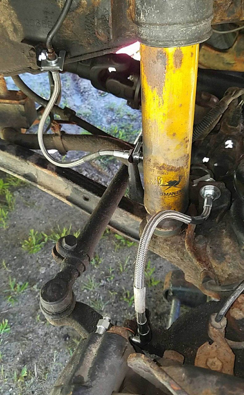

Changed the brake lines out and rebuilt the ebrake with all new parts nice to have a working ebrake.

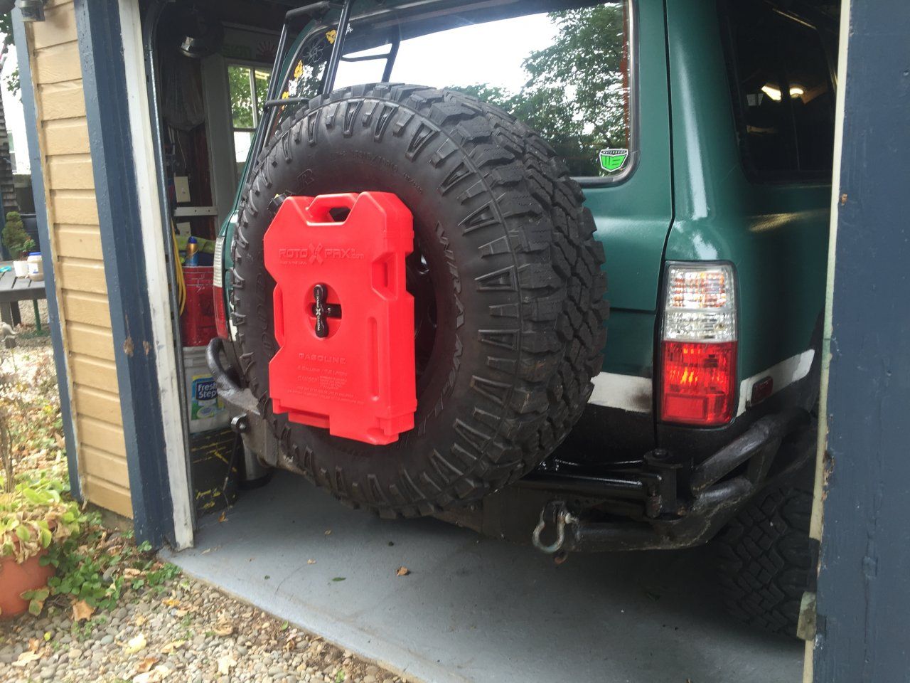

Also added a rotopac gas can to the spare tire might build something fir underneath too

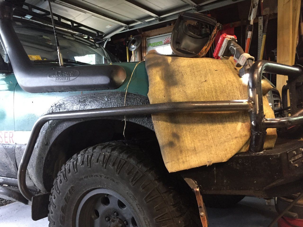

So i added a shovela nd axe mount that fits them behind the spare tire out of sight also started rear quarter protection that will get tied to the frame on the inside its pretty stout but its rear just meant to be a tree slider
I had my spare mounted on a wheel spacer nothing like not having the SAE socket to take the spare off :) so i rebuilt the carrier to use an old fj40 hub i had now i have spare cone washers and parts as well as some wheel studs i can use in a pinch

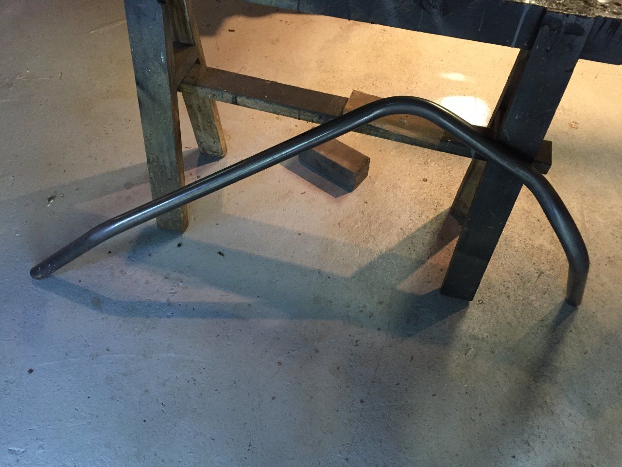

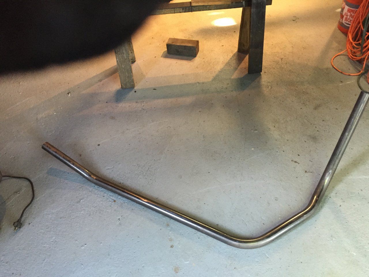

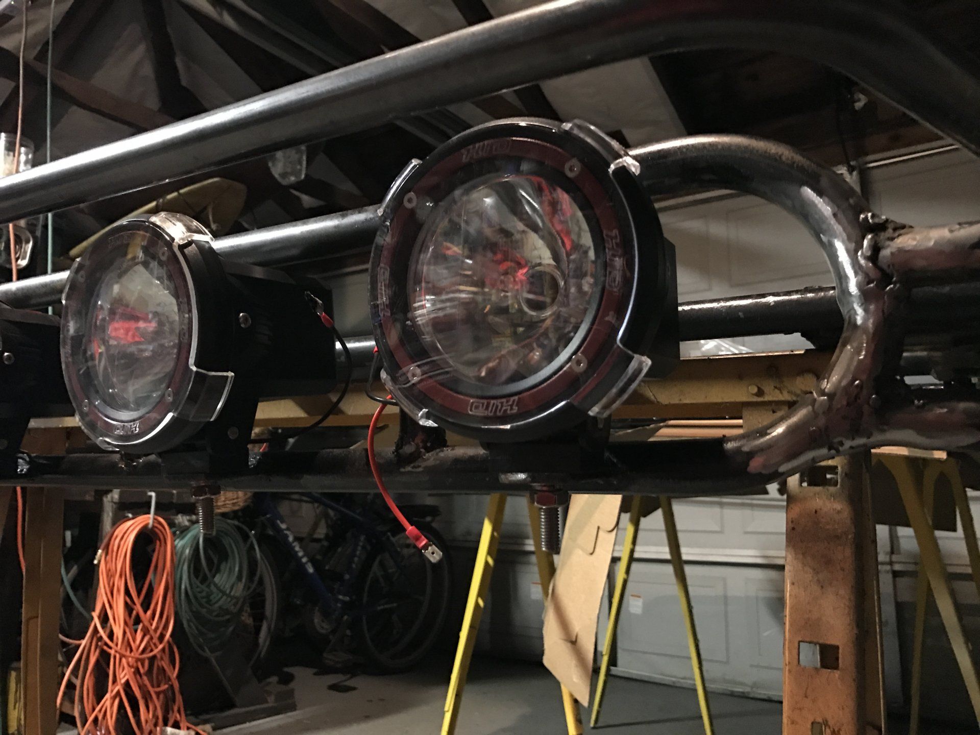

Started modufing my rook rack to have a set of 4 4" HID lights mounted as low profile as possible . I got the main hoop bent and cut in and welded was going to just tack it in but got carried away and just welded it up :)
Worked a bit more on my forward facing rack lights.... cause everyone needs roof rack lights right??? Cut the front off my rack and welded in a hoop then supports and started on the forward protection when i ran out of gas :(
