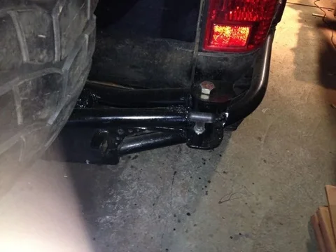

Anyway finished up the lower basket bars of the roof rack i like how the rack turned out
Next up is the rear bumper first took off the stock and got the body ready for the wings before i realized that all the after market bumpers require you to cut your rear cross member off I had re-enforced the stock one and mounted a 100 series hitch receiver and i like how that turned out
... So its wings for me. took the stock ones off and made the mounting brackets for each side
I also durebeked the lower body and redid the fenders
