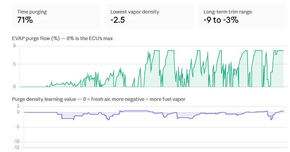

What is your evap purge learn value? (ECM data list)
I haven't filled up since so it's the same tank.
I did a few drives the last 2 days and nothing looks abnormal. I am thinking this is happening when I have a full tank. I don't top off and always stop at first shut off.
I need to go fill up and log all this again.

Get your tank full and check again. If the fuel trims swing far into the negative, pinch off that hose between the charcoal canister and the purge valve. If your trim rises to your typical baseline then you probably have raw fuel in the canister. Do you top off the tank? Does the pump ever click off during fueling even though it isn’t full?
I don't know if the previous owner did but I never top off. I don't think it shuts off before it's full.
Will post an updated log after I go fill up. be back.

EDIT: decided to chase the air side of this and not just the fuel..
ended up replacing the MAF sensor and the trims relearned to +3%. Gonna monitor for a little bit and adjust the fueling in the tune.
The old sensor was reading higher than actual airflow and I guess ECU was trimming LTFT to compensate.
