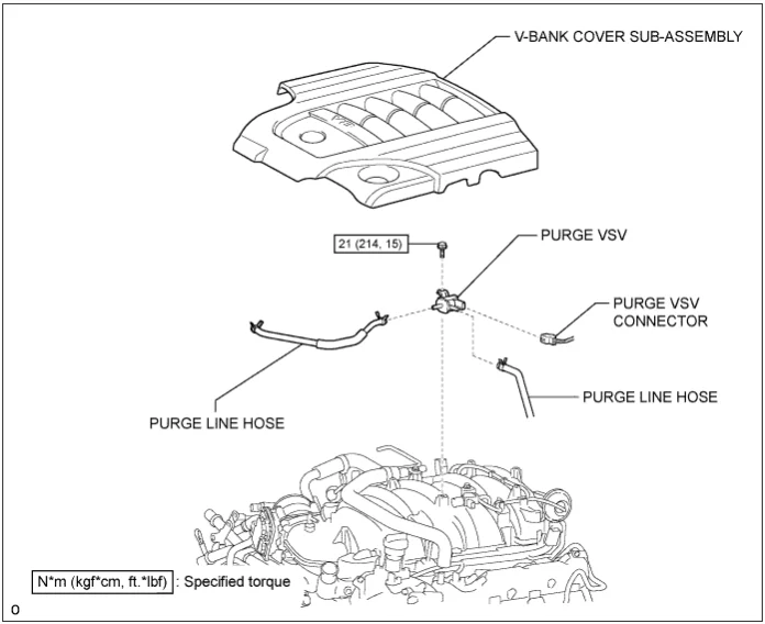

If it is the purge VSV, it's at the top of the engine and easy to reach. I doubt it's that however.
