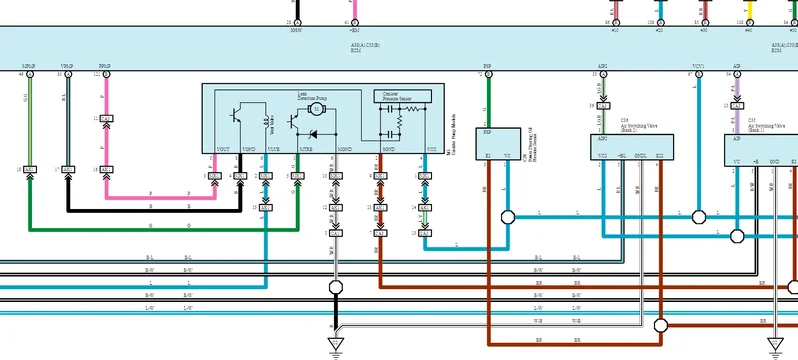

Started to pull the charcoal canister apart. My canister and the replacement felt about the same weight. No water or mud or any evidence of infiltration with just the hoses off. Air flows normally through it as the FSM says to test so it's not clogged. I haven't cut my canister open yet though I did pull the pump off and take it apart to test. The pump comes off pretty easily (just 3 bolts) and it has a Toyota and Denso part # on it.
Canister with the pump removed. The tiny bit of dirt on the white filter in the canister was from my finger.
There's a metal retaining ring around the pump housing that I pried apart as I didn't really see a way to separate it otherwise. The wiring harness really just seems to activate the plunger which seals the canister and the pump motor which I assume is what evacuates the canister to purge it. I took out my DC power supply to test this. Tried it at 5V and the motor had a slight hum but didn't seem to do anything. Cranked it to 12V and same thing. The plunger on the right definitely opens and closes when I apply voltage. Went back to the motor and after I left it connected for maybe 10 seconds I hear it click in and spin like it's supposed to.
Note that I don't know what the voltage to this should be. The FSM doesn't saw, and the Electrical Wiring Diagram only indicates it's receiving voltage from the ECM.

If anyone has a fouled charcoal canister and wants to try mine, I have a strong suspicion my canister was fine but the pump was bad. I’d be happy to send my canister (sans pump) to someone for the cost of postage if you wanted to swap your pump into it.
If you’re not sure if the canister or the pump is bad, you can run the evap tests in techstream, and there are options to activate the pump. Activate it and climb under the truck and listen for it - if you can hear the pump motor purging but you’re still getting codes then the pump is ok and the canister is bad. If you can’t hear the pump then my canister probably won’t help.
I am questioning how the pump died in less than a year though. I mean I do off-road and I’m sure it got dunked briefly at some point, but there’s size to signs of water infiltration in this unit, despite what the dealer claimed. I may try to crack it apart further just for pics for the forum to analyze. New replacements seem to be about $200 on eBay, $300 through a dealer, and since you can’t get a charcoal canister without one unless you’re sure only your pump is bad it seems unwise to just swap that if you have a CC that’s many years old anyway.
