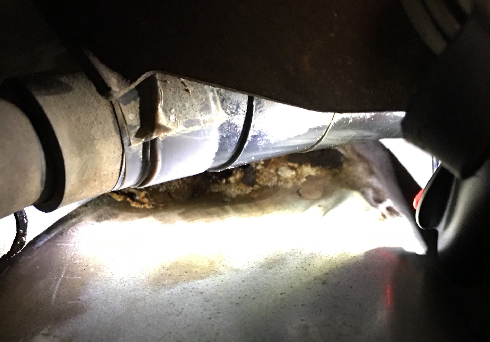

Just discovered this small bit of rust on the front driver’s wheel well under the battery box and just behind the headlight...
It’s the only rust on the vehicle, so I guess should count myself lucky!
Anything I can do to keep it from spreading, apart from keeping it dry of course? Not keen to disassemble and properly repair it at this point. Hoping there is a quick fix that can keep it in check until properly addressed next summer.
I think some debris got caught in there and allowed water to pool. I’ve cleaned it all out and it’s draining now.
It’s a tough spot to reach - the lip under the battery box.
Thanks for any tips or suggestions

Thankfully it’s not rusted through, but it looks like it’s on it’s way to that. I’ll definitely have to address it in the Spring.

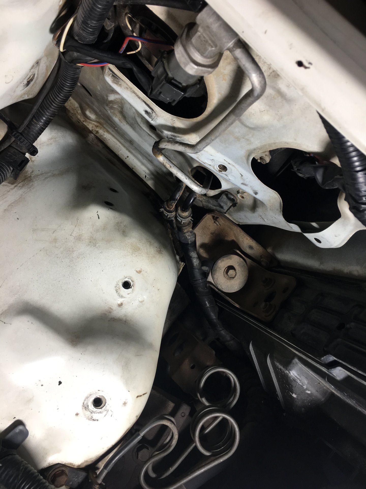

So frustrating. Dug into this today - literally dug.

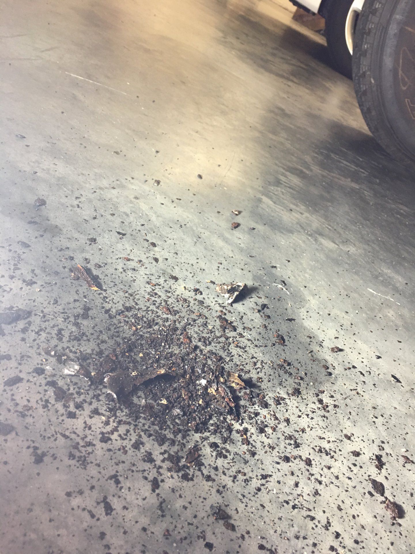

It was much worse than surface rust. It had eaten clear through the driver’s side front fender. It was still moist, damn it!
Here are some photos (notice in the second photo the size of the hole...and how it grew after removing rotten metal by the time I took the third photo!)...
I’ve removed what I could with a screwdriver and pliers and bent the good metal back on itself in the wheel well. I’ve tried to protect those two lines running above the area (transmission cooler?).
I’m replacing the 23 year old original factory radiator this summer with a new OEM radiator as PM. I’ll have much better access then. I’ll probably see about getting a professional to look at it, as I sure don’t know what I’m doing.
I do think I got all the rusted crap out though. I’m going to cover what’s left with the naval jelly I got and call it good until summer.
Any tips or corrections to what I’ve done are most welcome!

Had some rust that ate through on my rear wheel well. After removing and treating rust and then painting with POR 15, used fiberglass resin, cloth, 3M metal screen and bondo to cobble up a repair. Then painted again. Is it pretty? Not so much... will it rust again in my life time? Don’t think so. Watched several videos on you tube to get ideas. After all... it’s just rust!

I’ve pretty much removed all the rotten metal, have done a couple applications of naval jelly and will brush on some rust inhibitor this afternoon.
This summer while replacing the radiator I’ll come up with something like @cowboyjack’s repair.
It’s completely hidden under the battery box in the wheel well. Doesn’t need to look pretty. Just need to keep any remaining rust from spreading.
