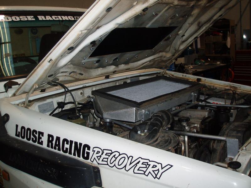

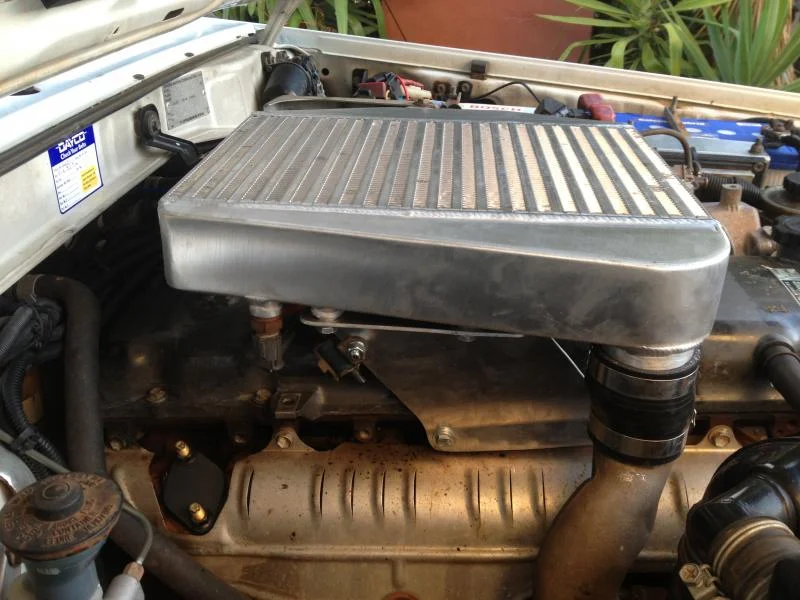

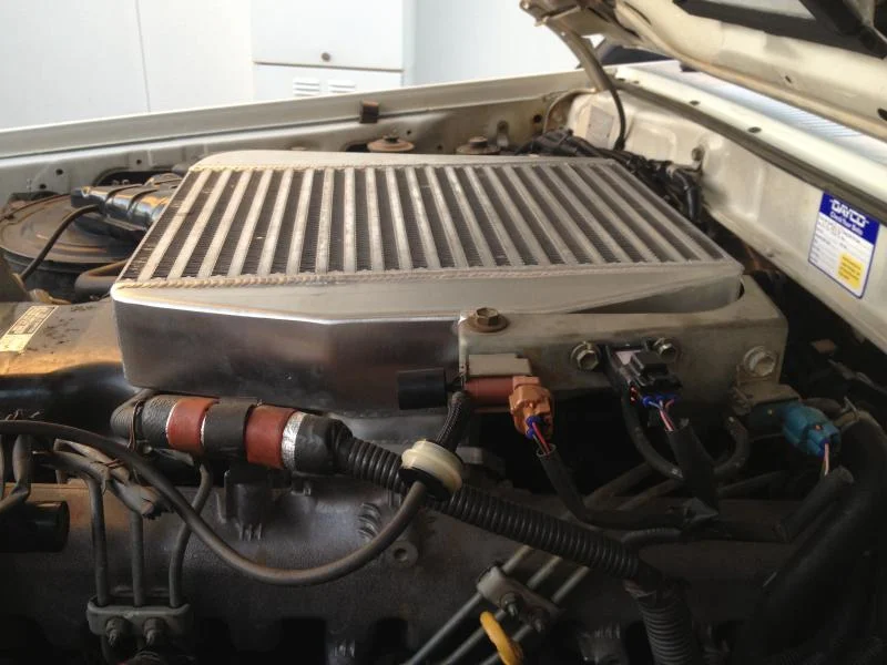

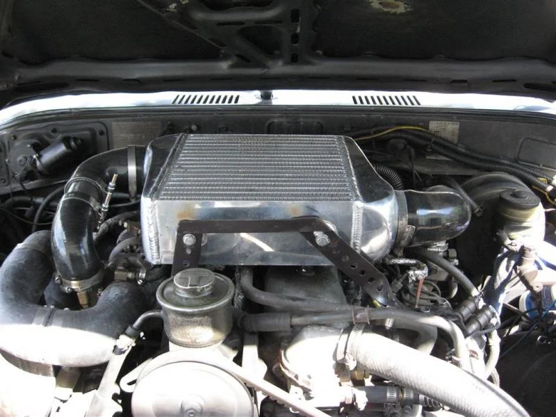

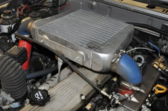

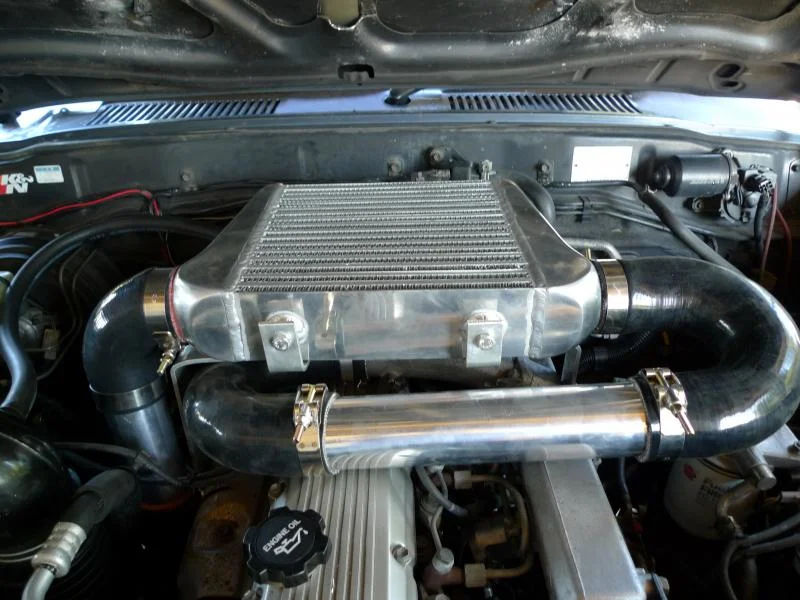

HPD End tank inlet location
attachment.php
or
Centerlized bottom entry similar to this
attachment.php
I am leaning towards doing an outlet endtank similar to this one just feeding the plenum. s***ty thing is I am going to be buying the cooler before I finish the plenum just so I can build around it so to speak.
Something like this
attachment.php
or more central
attachment.php
and creating something like Adam has done:
