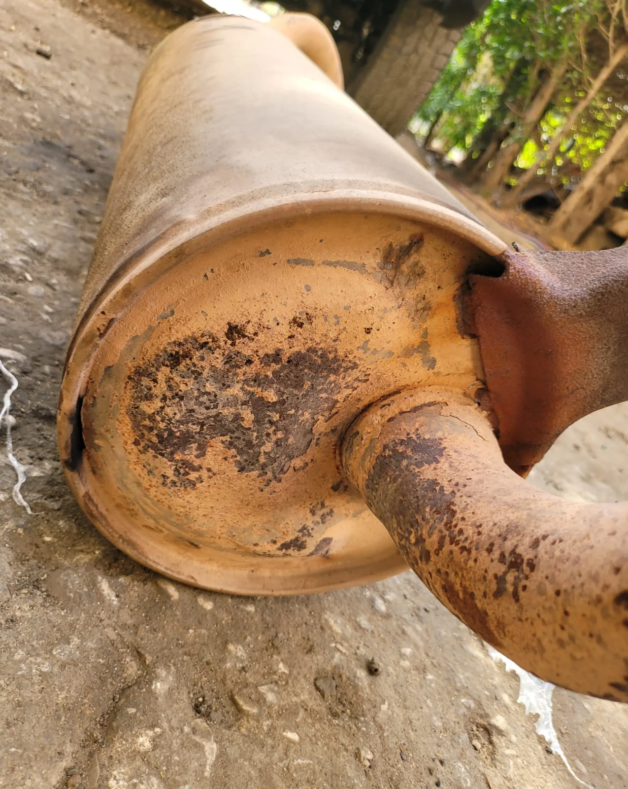

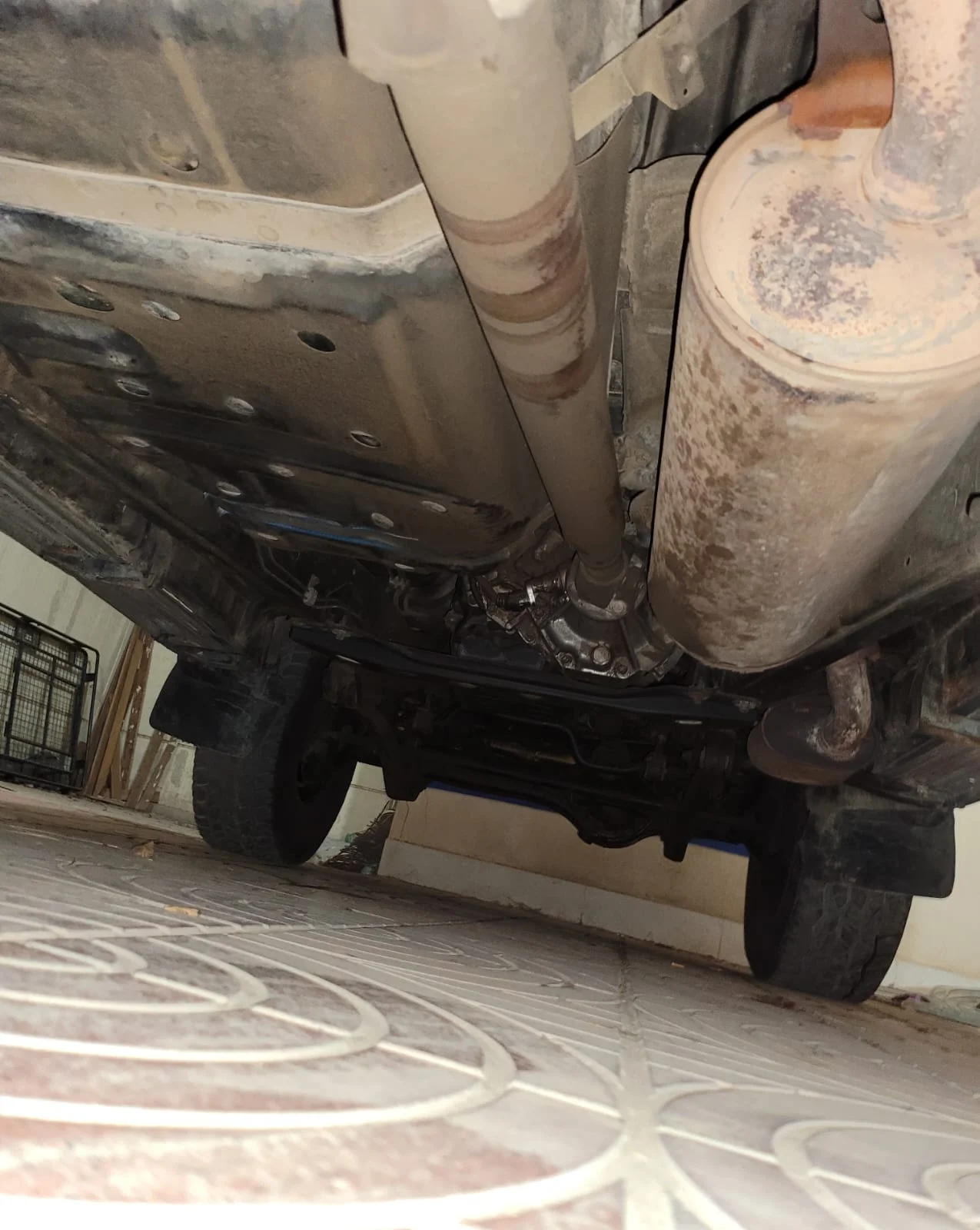

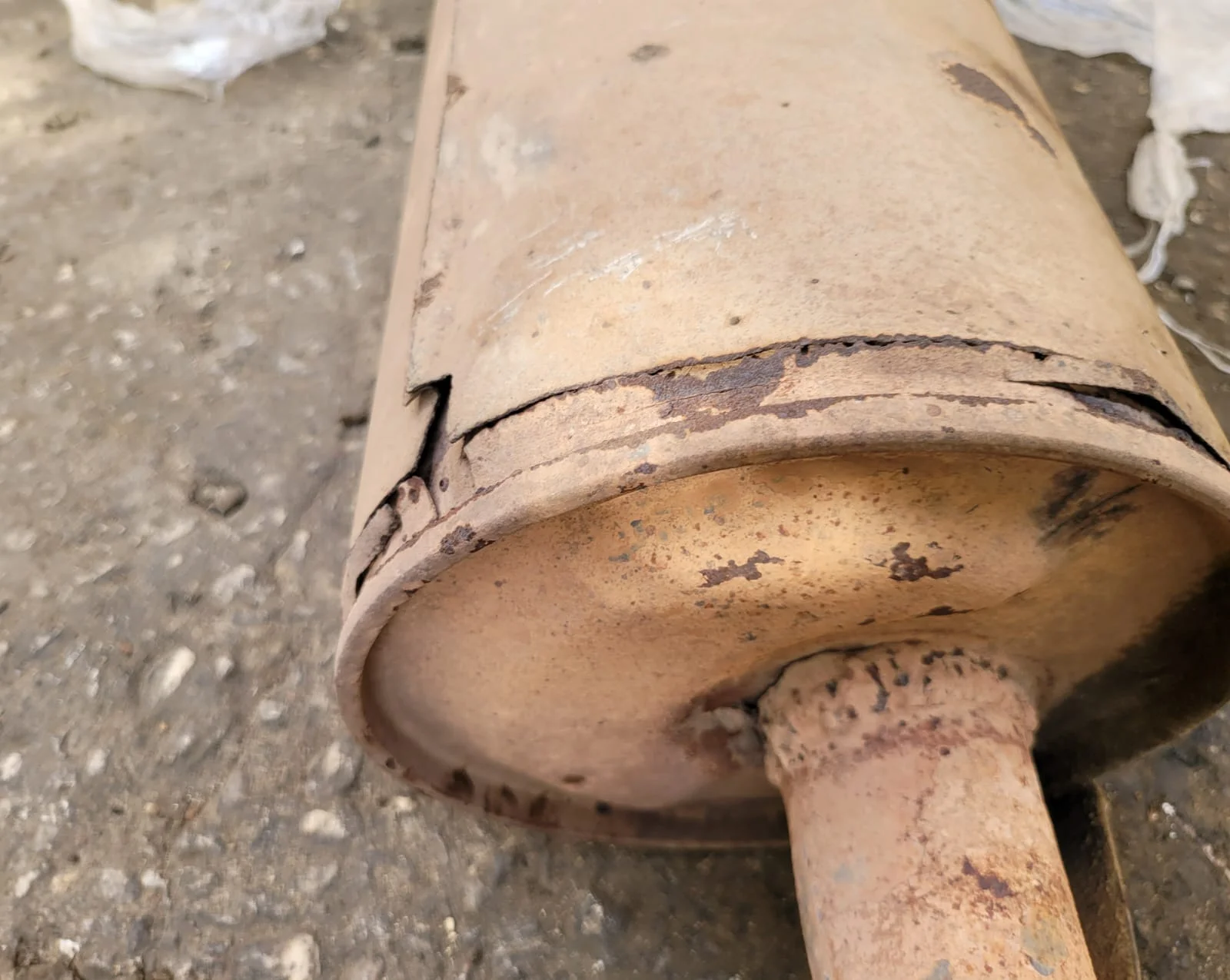

First order of business was swapping out the middle exhaust box .... it was shot, stabbed, blown and shot again. First change since well a very long time ago.
We have a lot of problems in import in Egypt, all i could find was an OEM exhaust made in China. Swapped it and a huge improvement.
Swapped the exhaust mounts as well they had evaporated along with my wallet.

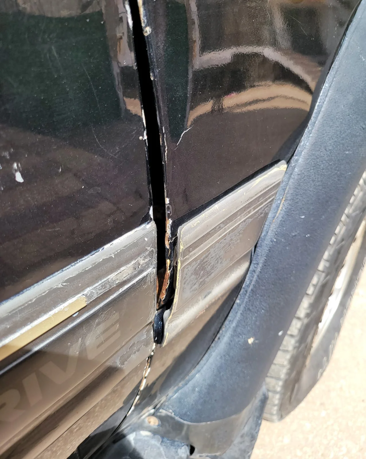

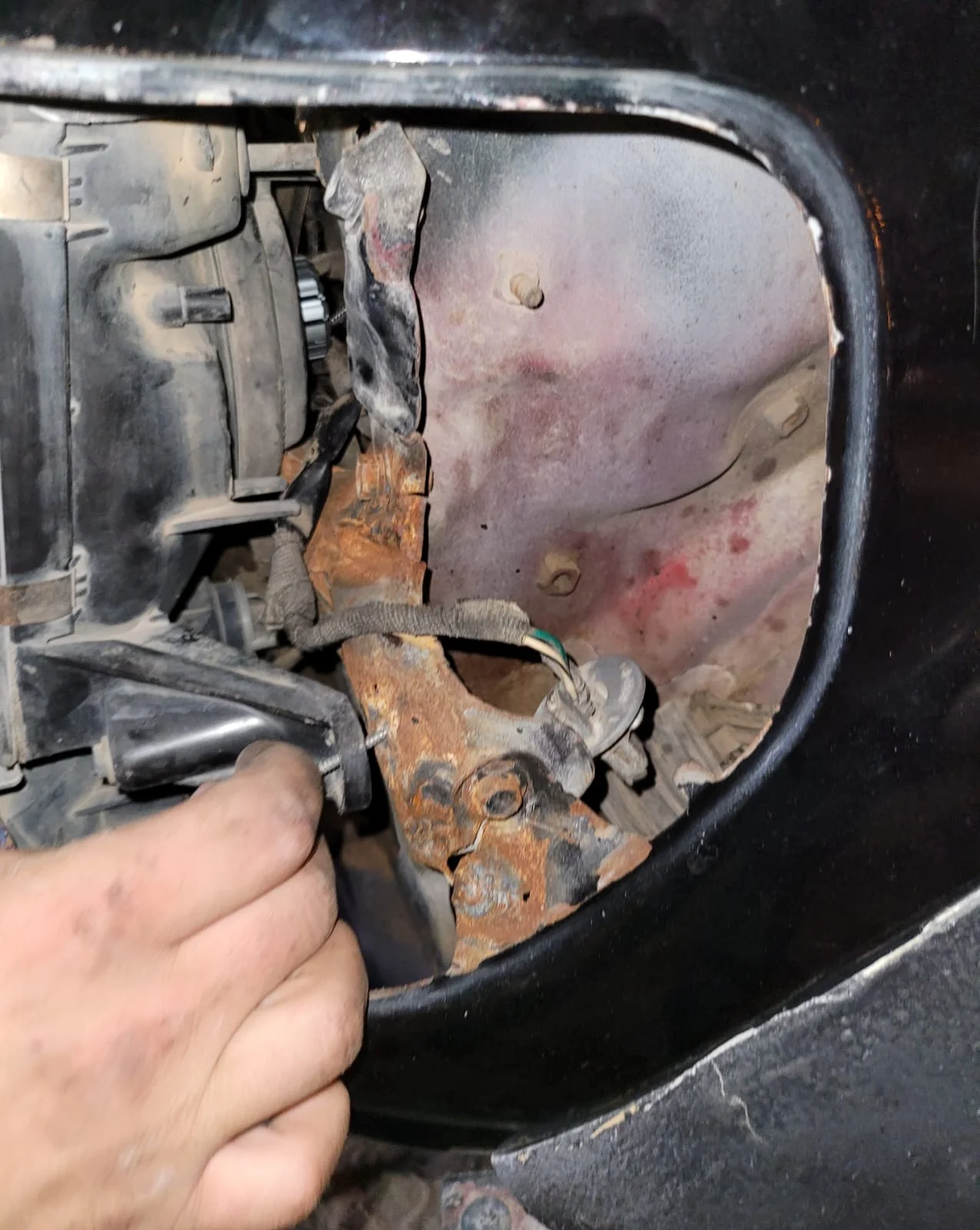

First the ugly, frame rust is bad right and left bumpers where not properly sealed by the headlights. Over the years water ingress rotted the frames.
I have another spot in the frame (bubbling).
The 4 doors seem to have aged there is rust in them but they also seem uneven. I want to change all 4 doors, both side frames and front beam holding head beams.

My first question is regarding the chassis, from first glance it seems in good condition upfront in particular. There is rust spots at the back from sea operation (boat launching and retrieval) what should i look for ?
Should i grab a metal brush and "test" the rest and how deep it is or is there something else i should be looking for ?

Umm your rust issue doesn't seem as bad in the pictures as you seem to indicate. But i believe you just maybe it is something you can hit with s wire wheel then some rust converter and seal those spots up.
I thought you could order from EAU there and if so can you not order from partsouq.com?
Well I will take more pics but I can't really asses (I lack the experience tbh). I got the wire wheel and metal brushes so maybe today after work i will take it for a deep clean (i did notice oil leaking but its far too dirty to pinpoint location atm) then take some more pics.

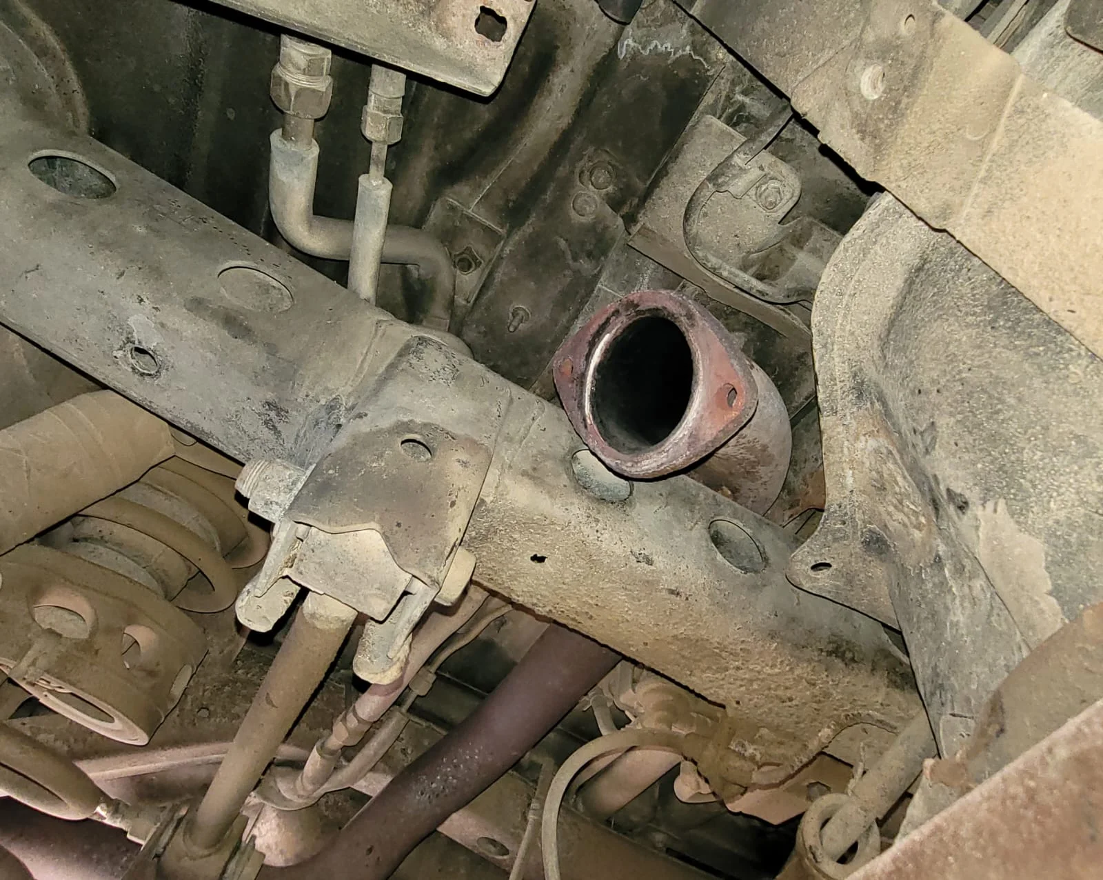

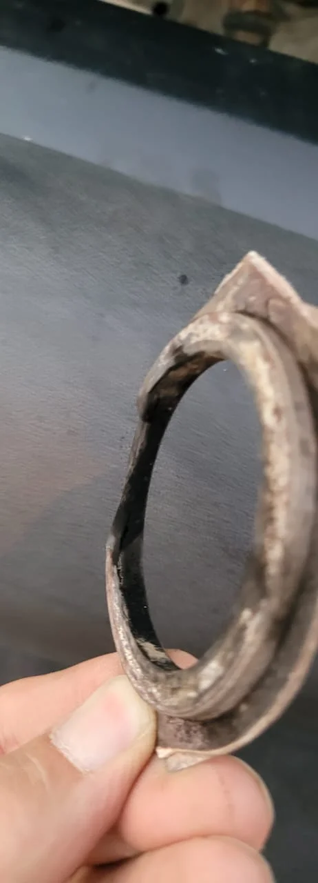

The ticking noise and I burnt fuel smell is an exhaust leak, could be at any of the exhaust junctions, a mixture of water and soap sprayed on a cold exhaust and then turning the truck on should show bubbles at the leak.
So you where right, I had changed the mid exhaust box and both the gaskets on both ends.
However the ones next to the engine had not been changed.
So car now has a full set of new gaskets.
The ticking noise is still there, the smell is gone after replacing the exhaust gaskets.

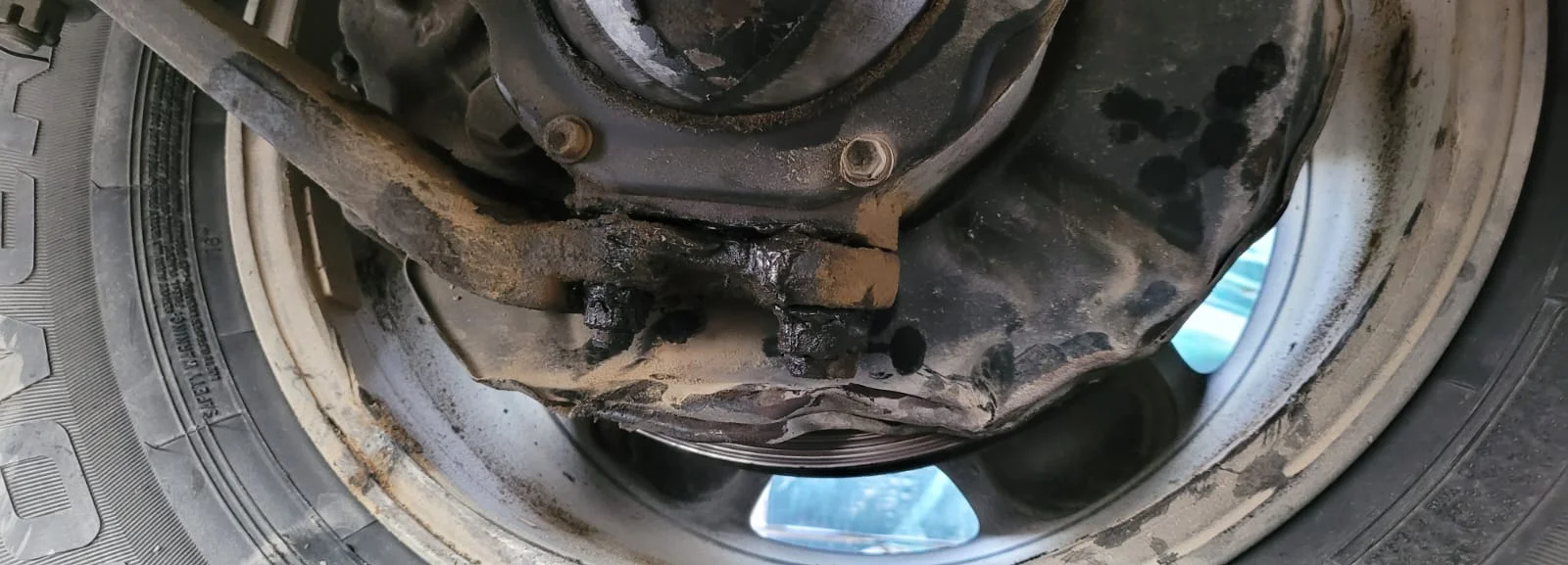

Replaced, tied up and got my suspension undercarriage sorted.
Quick overview:
Compressing the bushings in the back bushing
Sway bar bushing front worn - replaced
sway bar bushing back worn - replaced
Front back bushings (the one with 3 bushings to together and 1 at back) worn - replaced
Back bushings all 4 worn - replaced
Front stabilizing bar both sides worn - replaced
the side "finger thingies that look like a clamp on one side and a bolt" both worn - replaced
steering tightened (Needs work in the future)
Almost everything was lose and i mean everything needed to be tightened a lot ...
By worn I mean ruptured, screw driver shifts it easily. No wonder it felt like jelly with the lift XD
