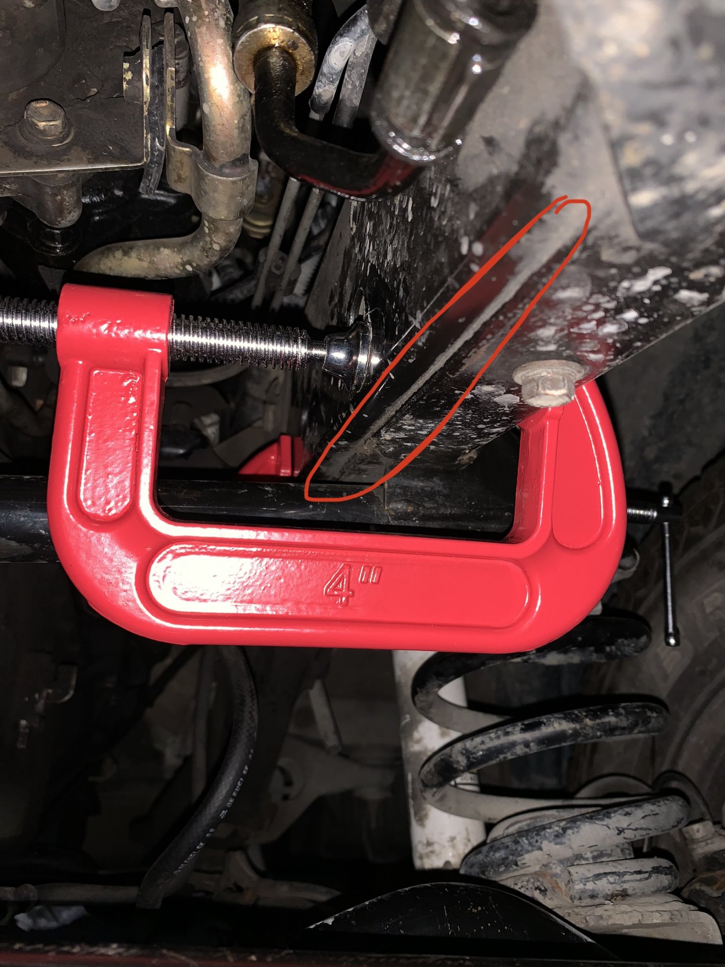

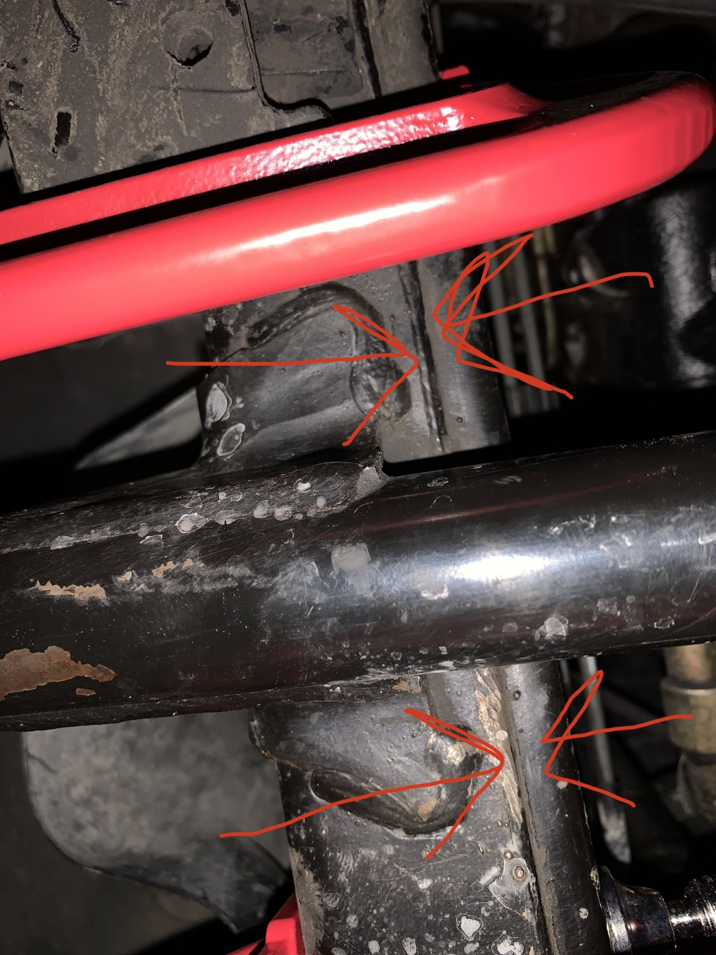

Thought I’d post an update since I invested so much time and effort to finding this bastard noise.
well I’ve found where it’s coming from.

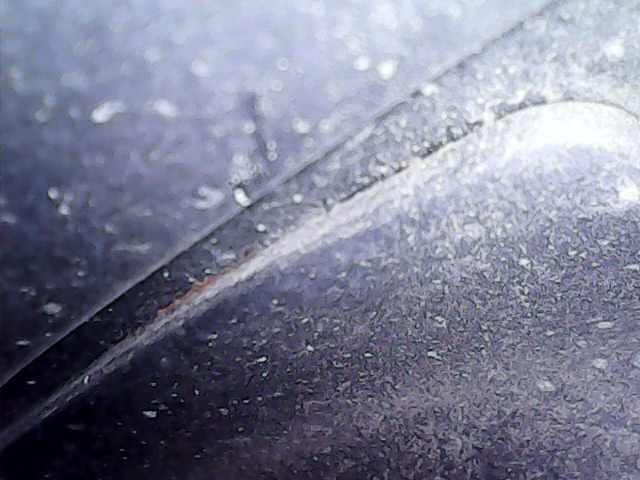

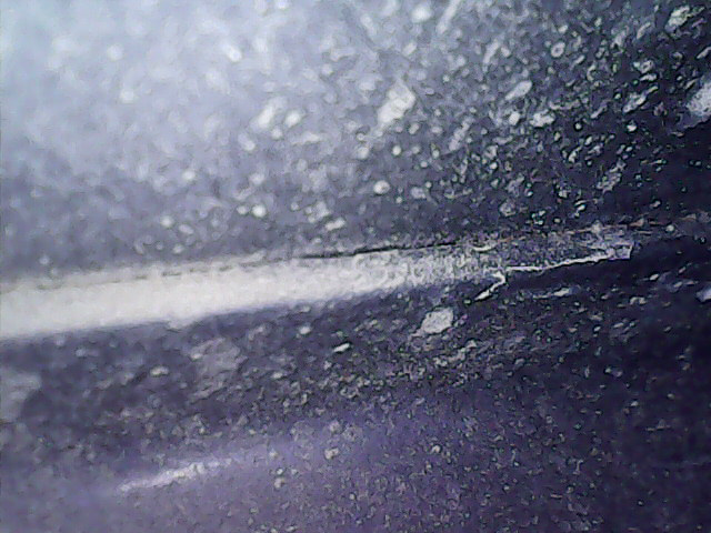

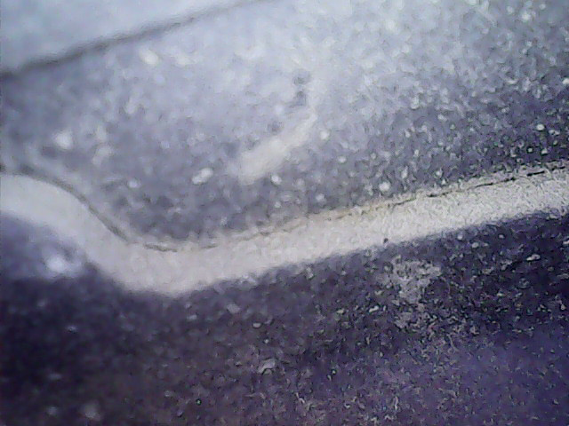

The chassis/frame near the cross brace rod appears to have a crack down the weld. You can sort of see from these endoscopic camera down the frame rail (inside).
if I clamp the frame like I’ve done in the pics the noise isn’t there anymore.
im hoping I can just grind the frame where the joint weld is, then re-weld. Thoughts?
Congratulations, with good weld prep and the right expertise with a welder, you should be good. Amazing that such a crack made all that noise.

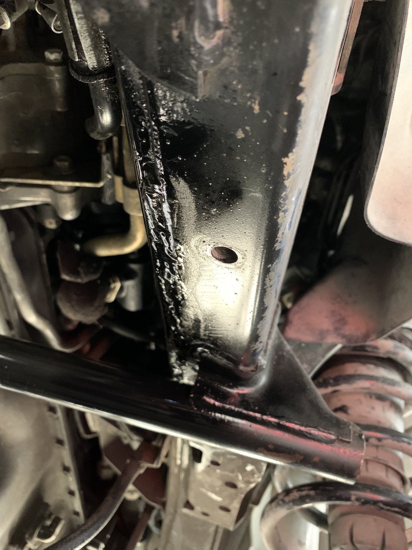

View attachment 2676363View attachment 2676364
Nice, and you finally found the perp. You could certainly try welding the crack. I am sure it would at least work for awhile.
If it were mine I would grind, prep, and weld the crack. Than I would grind the new weld flat and reinforce the area by welding a piece of plate to the frame in an attempt to strengthen it.
