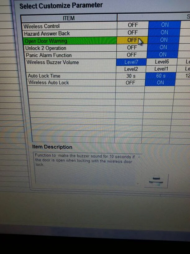

Long beep is triggered only when you press the lock button either on remote key or any of doors while any door or tail gate is not fully closed. To turn that off press the unlock button or it wil turn off after set time. I have turned that feature off in both corolla and tundra. There should be a way to turn the beep off using Techstream under "door" ECU. I will explore that today when I get home.

Yes, dealer can turn off the open door warning using techstream.
Here are screen shots showing this.
That doesn't surprise me, but I was surprised that they were willing to do it. I assumed the lawyers would freak out about it.
This open door warning (long beep for 10 seconds) is only related to the wireless door locking while any door is not completely shut. You will continue to see the warning light on instrument cluster when driving (ignition is ON) and one of the door was not shut.
