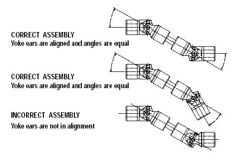

Ok, here are my thoughts on the pros and cons of the cut and turn for the 80 series axle. (rolls up sleeves, gets some coffee, sits down and cracks knuckles...)
Most people use offset bushings to correct the caster. This rotates the entire housing back to stock position. Simple, cheap, easy, reversible...not much to think about up to around 2.5" of lift.
The washer mod is a variation of the same idea, but instead of using offset control arm bushings you slot the front hole by 14 MM(or 7MM front and rear), rotate the axle back and weld on new plates to relocate the holes.(effectively washers). The benefits over bushings I see are a)that it is cheaper if you have the tools b) you dont have to push out the stock bushings and c) you retain stock bushings so you can maintain flex and good driving characteristics.
The problem with both of these solutions is that by moving the entire axle housing, they also rotate the pinion angle down towards the transfer case. driveshafts work by splitting the angles between the axle and transfer pinions between two u-joints, usually set to be parallel angles. The 80 series uses a different "broken back" configuration, the front points up so the ujoints are not parallel but are still operating at the same angle. like #2 in this diagram:
As the pinion moves down it gets to a point where the angles do not match and eventually the front shaft will start to vibrate. At this point, usually 3.5-4" of lift, most people install a Double carden drive shaft, which has three joints. The joint at the pinion is basically fixed with no angle and the two at the transfer case split the angles.
By the time you buy and install plates, return to stock bushings, and buy a dc driveshaft this becomes very expensive. Which brings us to the cut and turn.
With the cut and turn you cut through the axle tube freeing the knuckle balls, rotate them back, and weld them back on. This changes the caster without changing the pinion angle.

I would probably approach it differently - measure the diameter of the spot to be cut and turned. Multiply that by pi to get the circuference of the axle at that point. Divide that by 360 to get the distance per degree. Multiply that by the amount you need to correct and divide by two since it will move front and back and mark it on the housing. Somebody check that math for me since that was off the top of the head.
I didn't go into the fact that the tie rod will eventually hit the control arms. To address that you could either move it up front with the chevy one ton ends, or do a control arm flip which would allow you to rotate the housing a little at the same time.
with a big lift, 6+", I think you could probably do an arm flip and rotate the housing back to the point where the pinion starts to operate in a standard parallel configuration, but that is a controversial topic in the 80 forum.
B.Paul, you answered your own question. Plates are easier, and more reversible and more "adjustable".
Cut-n-turn, while cool... will take way too much math, head scratching, and praying. I'm only good at the two latter.
From cutting off two sets of balls, it's easy to cut just enough to turn them, that won't be your issue. Once they're loose, they literally rotate t where you need them.
Either way, Matt posted the diagram, just make sure that drive shaft is lined in same angle, otherwise you'll get vibes from the shaft.
