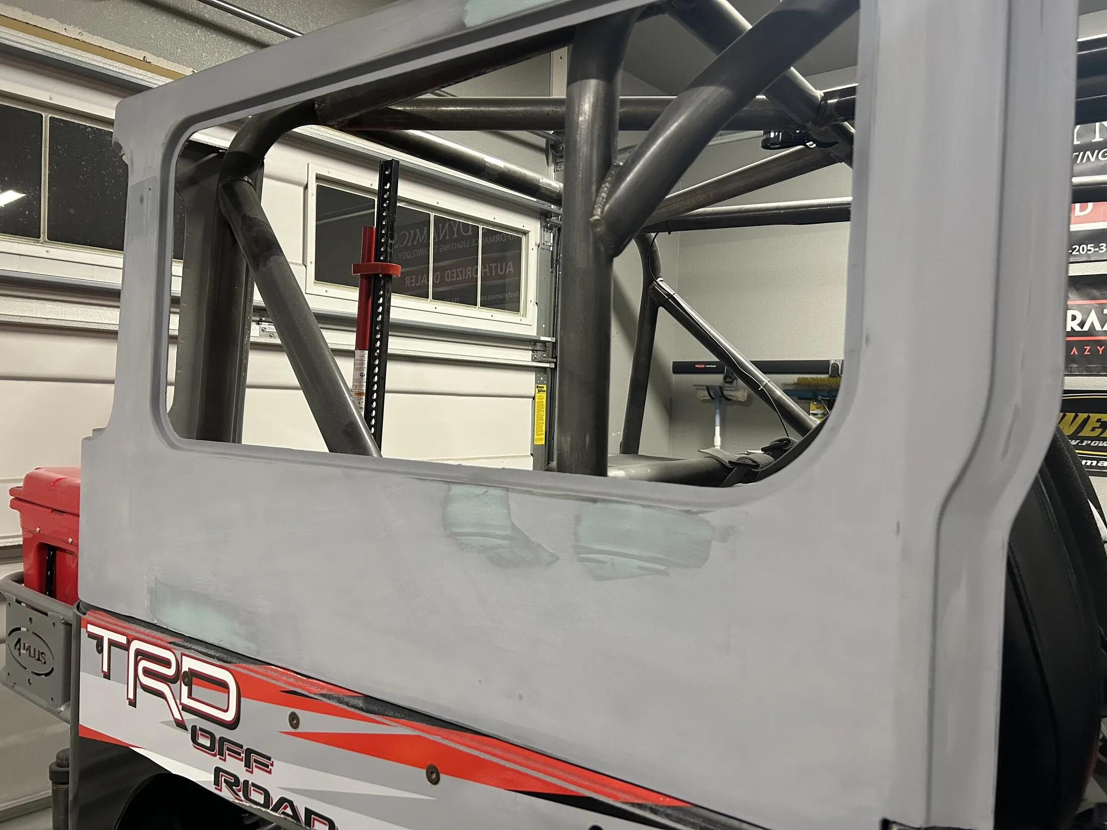

Should have these ready for paint tomorrow 🙏.

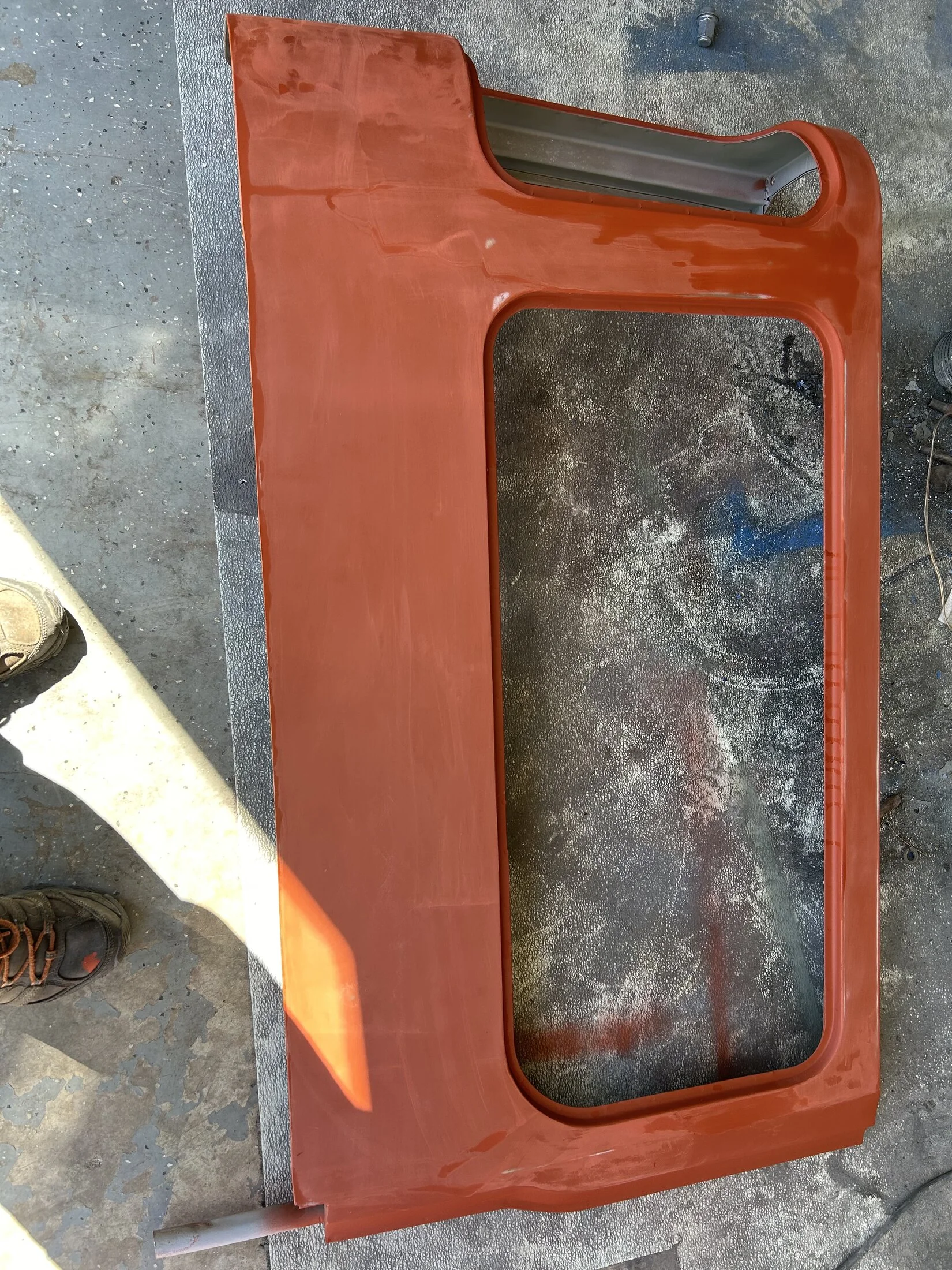

Woke up early today and got 1 side in final primer. Still a little to do on the other . Then I gave the kids a bath. Now going to drop some flowers off with my Mom and then take Elsie to the lake for a bit. Will finish the other side this eve.
Looks good. I still need to wet sand my body. What did you decide to do to the inside?
Right now the inside is primed. Honestly there really is not a lot of surface area on the inside . I think I still might line them . If this was something I was building for cars n coffee on Sat or if it was a stock build then I would do it differently but sometimes I forget this is my Crawler. And it’s ment for the hardest trails . So I have to draw the line sometimes .

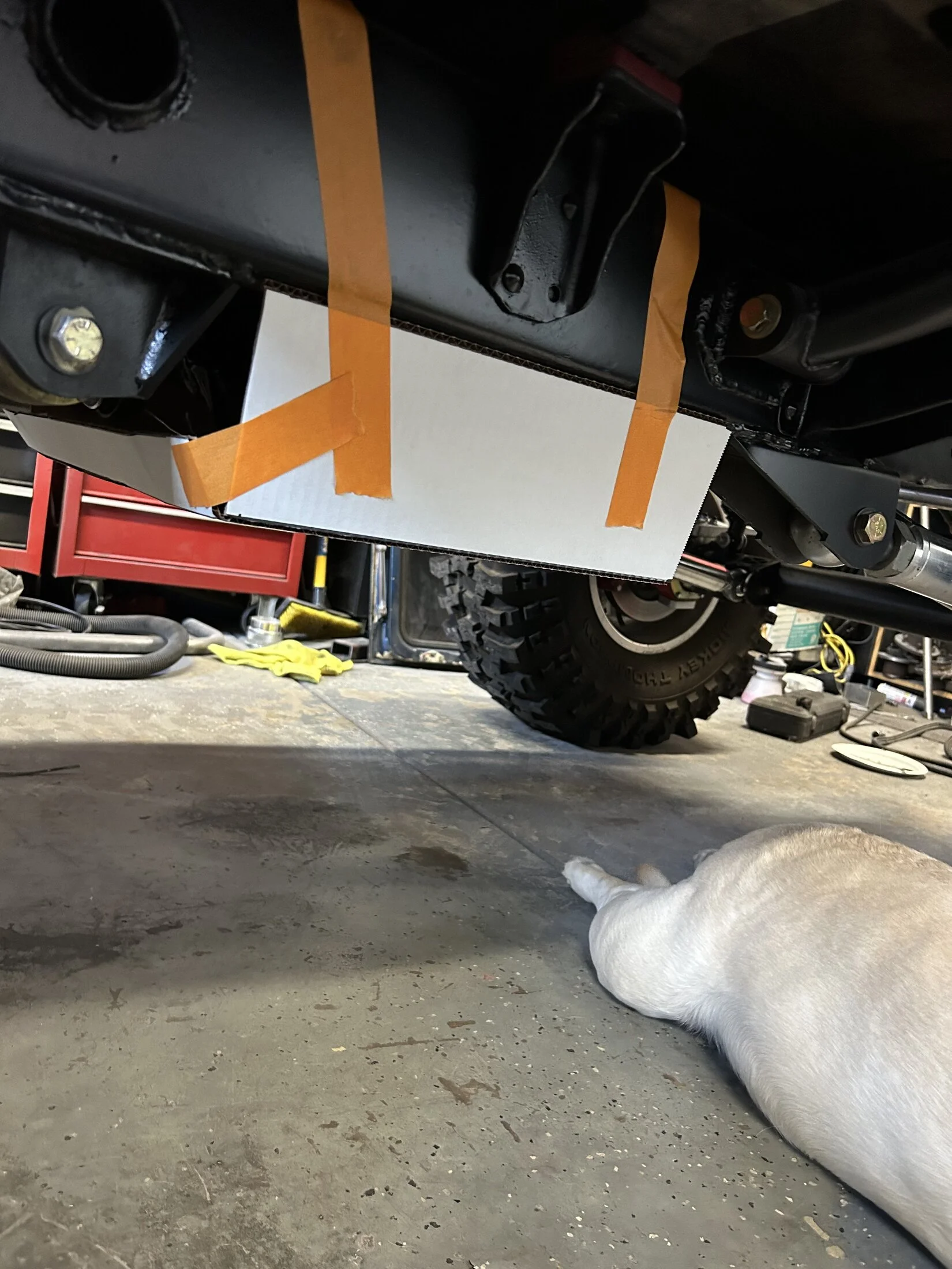

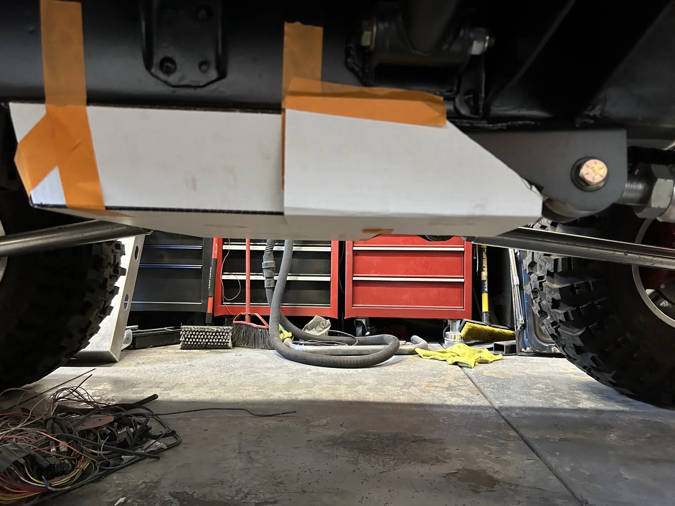

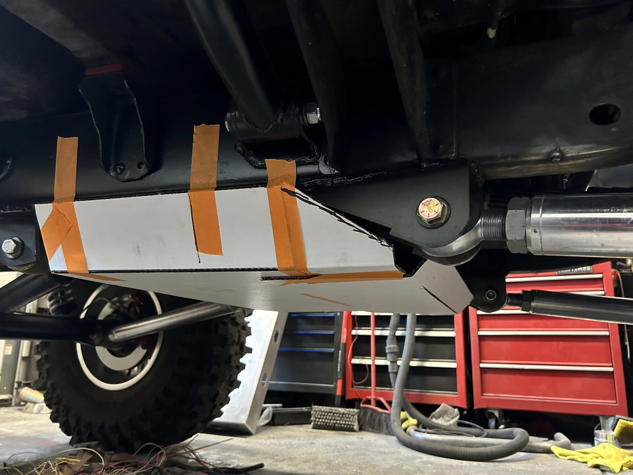

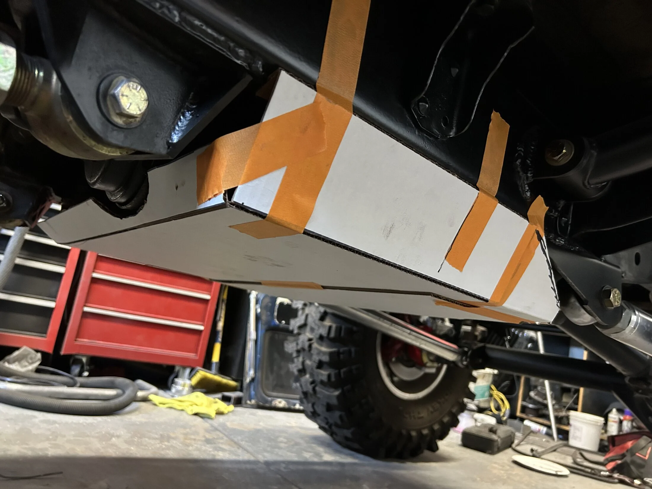

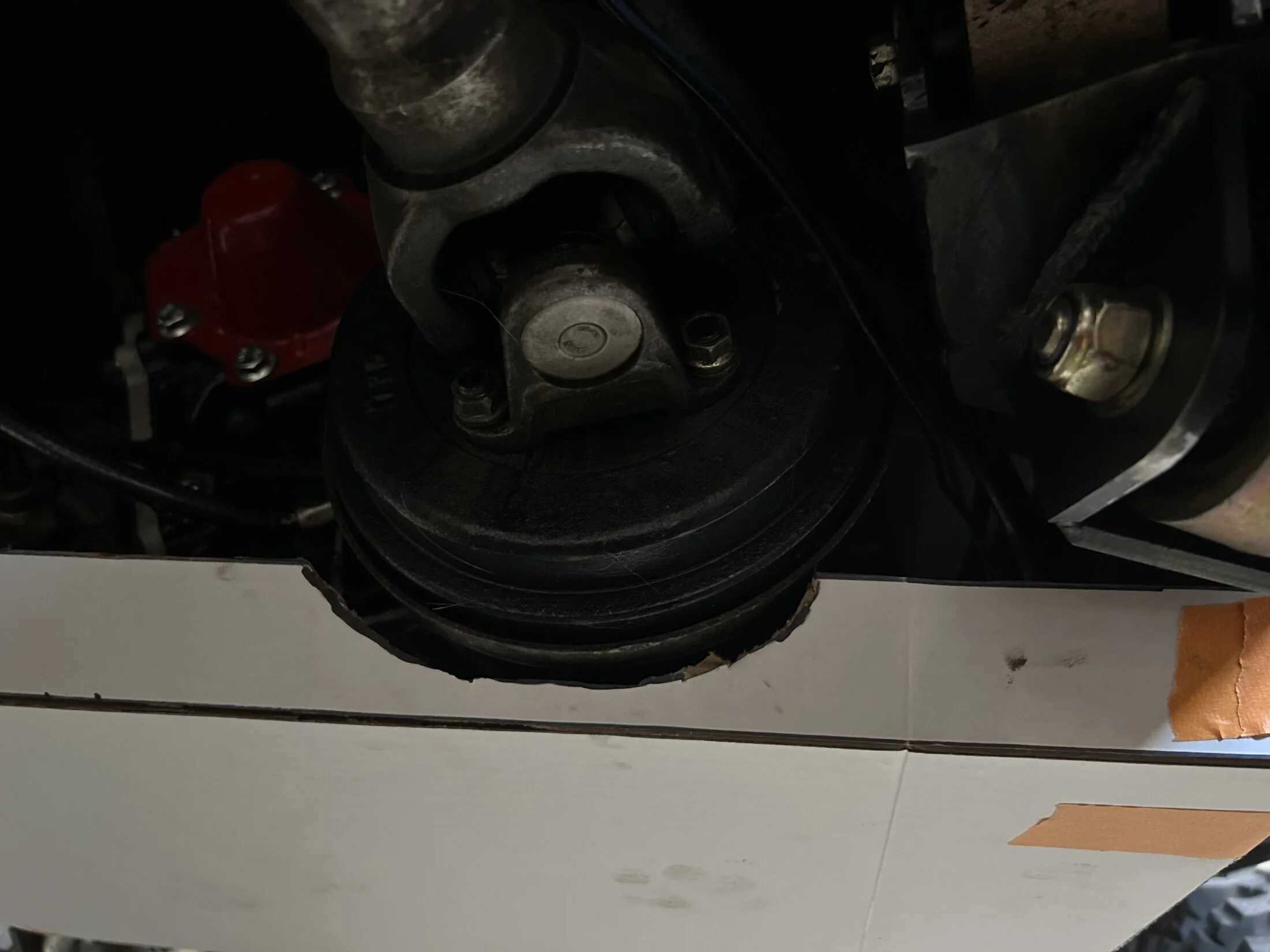

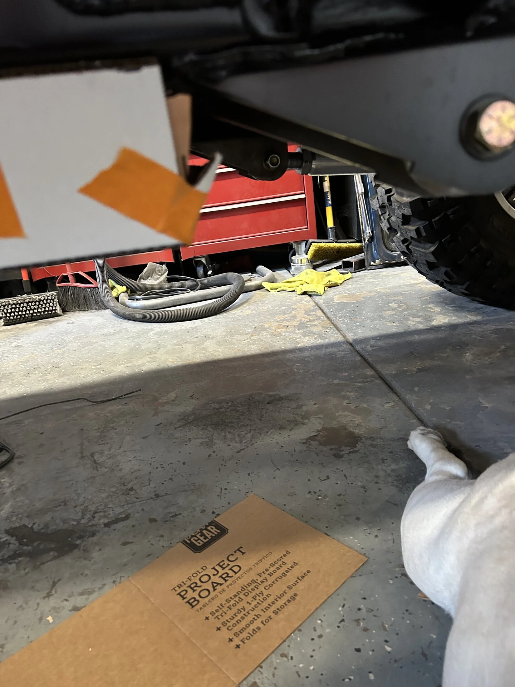

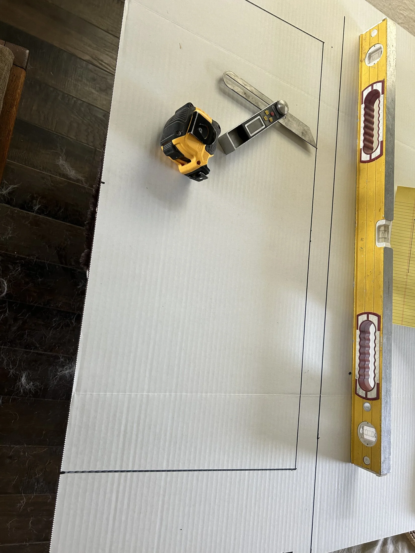

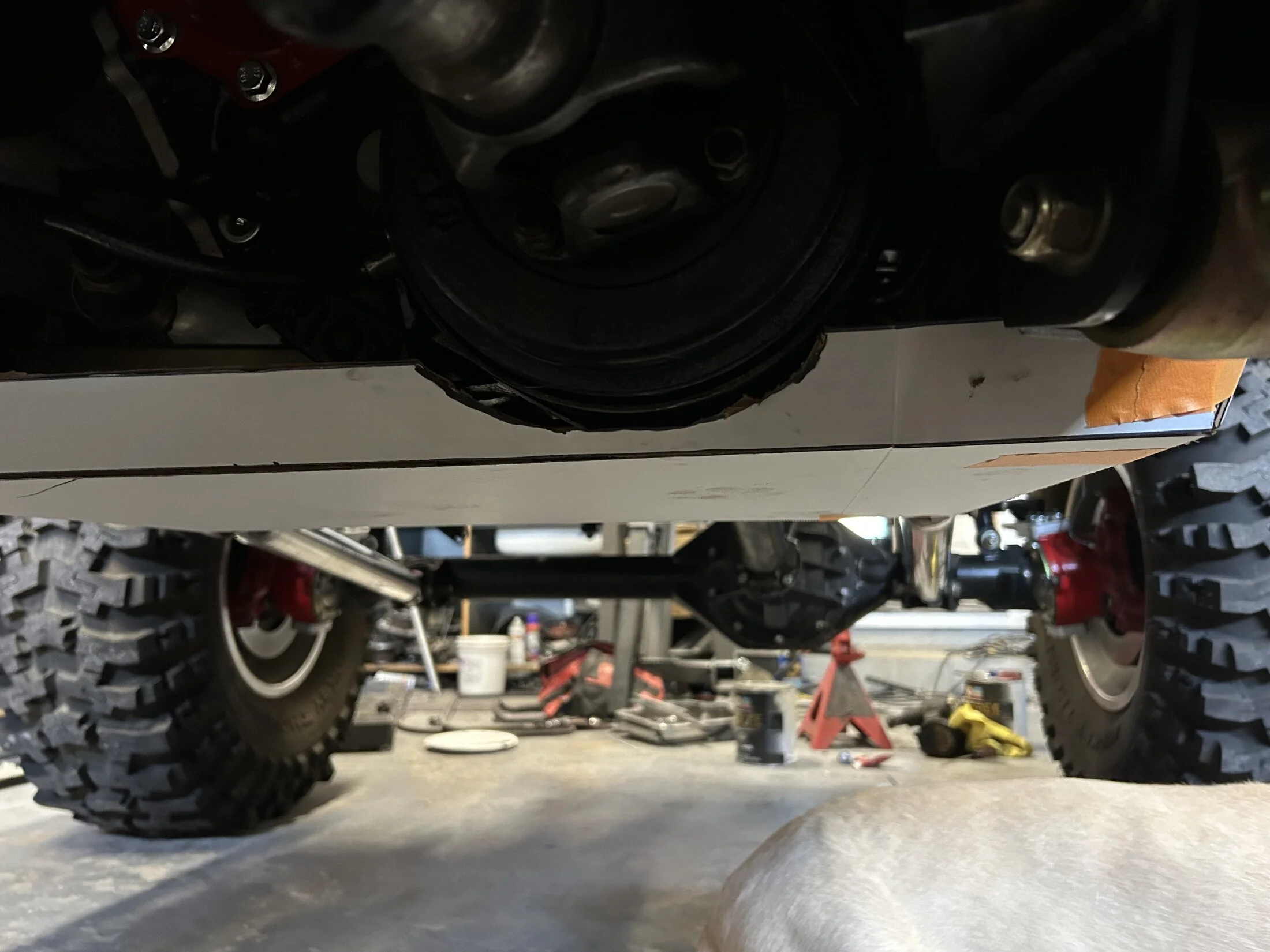

Enough Arts and crafts. Let’s make something 🤔. First round of mock up
Removable front piece would be convenient access. It should still be stout enough so it adds strength to prevent bending the front edge though.

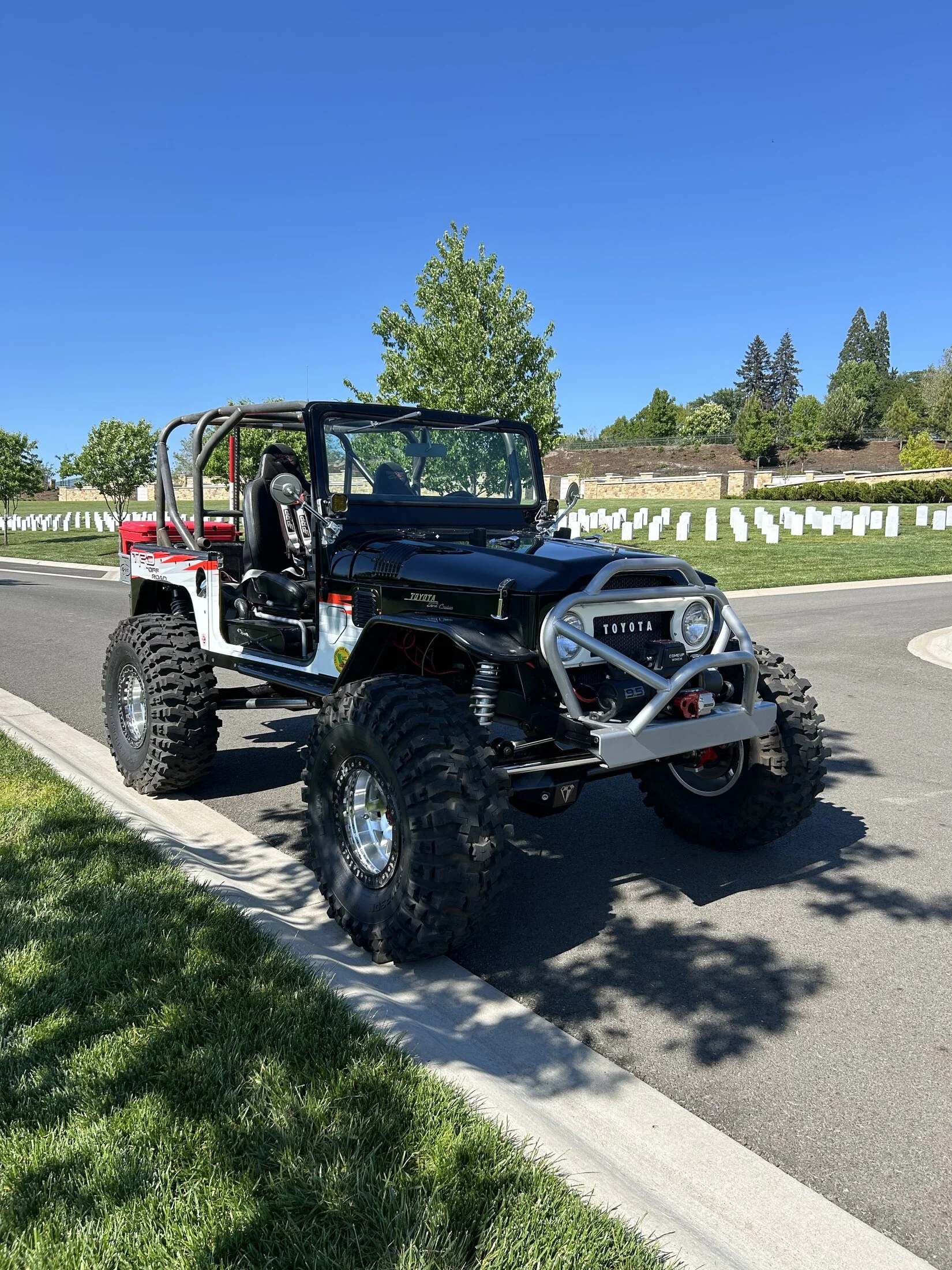

I love your dog and your 40 is awesome.
Thank you. Elsie is my Buddy

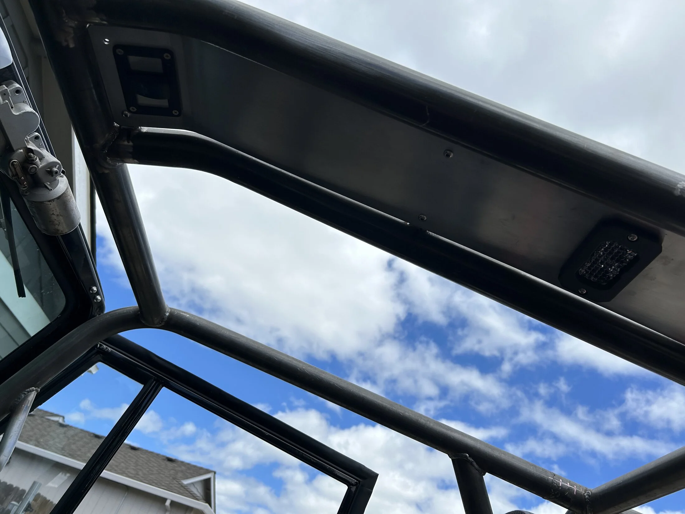

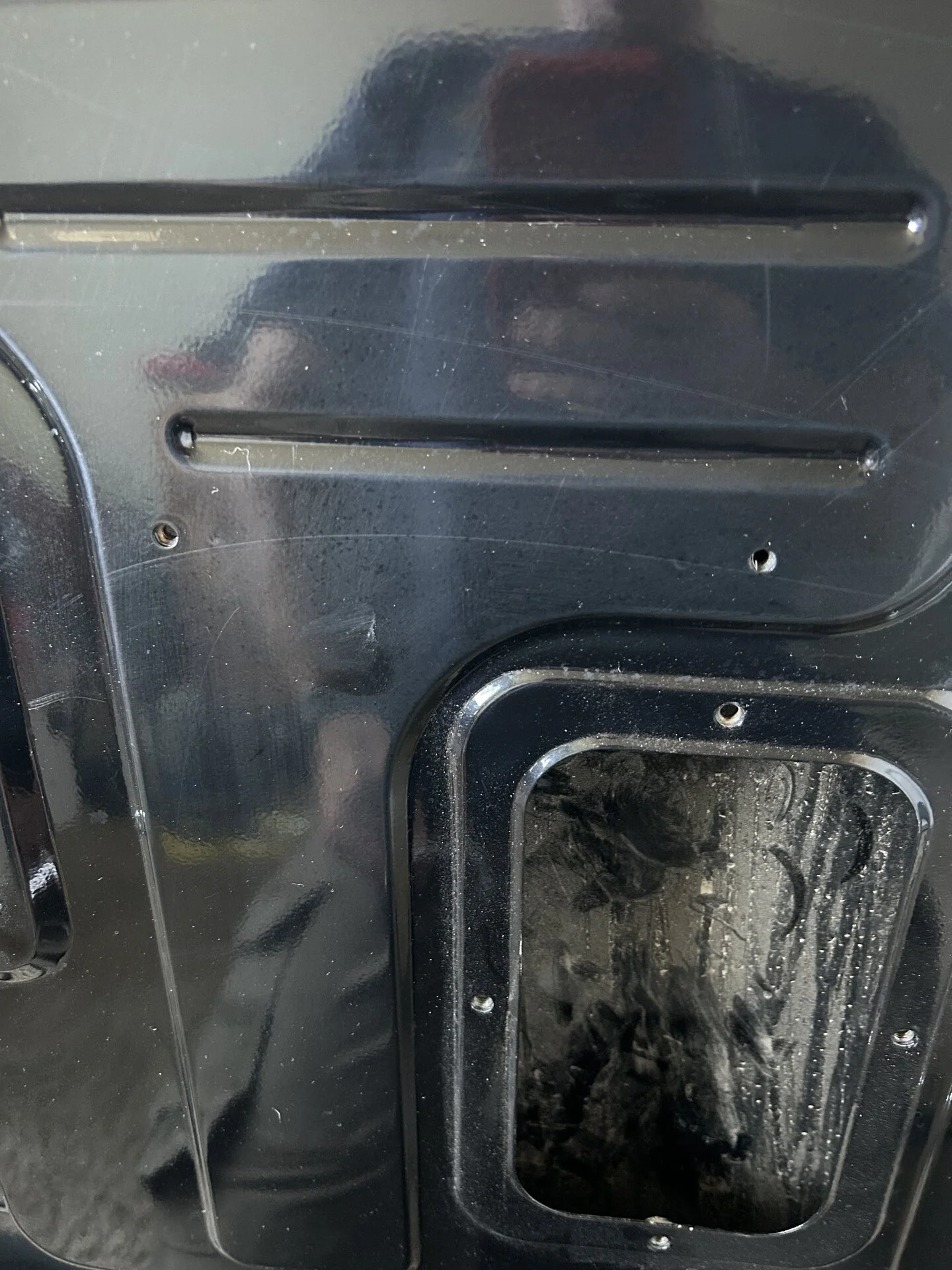

Finally wrapping up some lose ends . Got some switches installed and the overhead light . I am on the 5 week mad dash to get things ready for Rubithon 🤦🏻‍♂️. Trying to decide if I should run my top and doors or not 🤔.

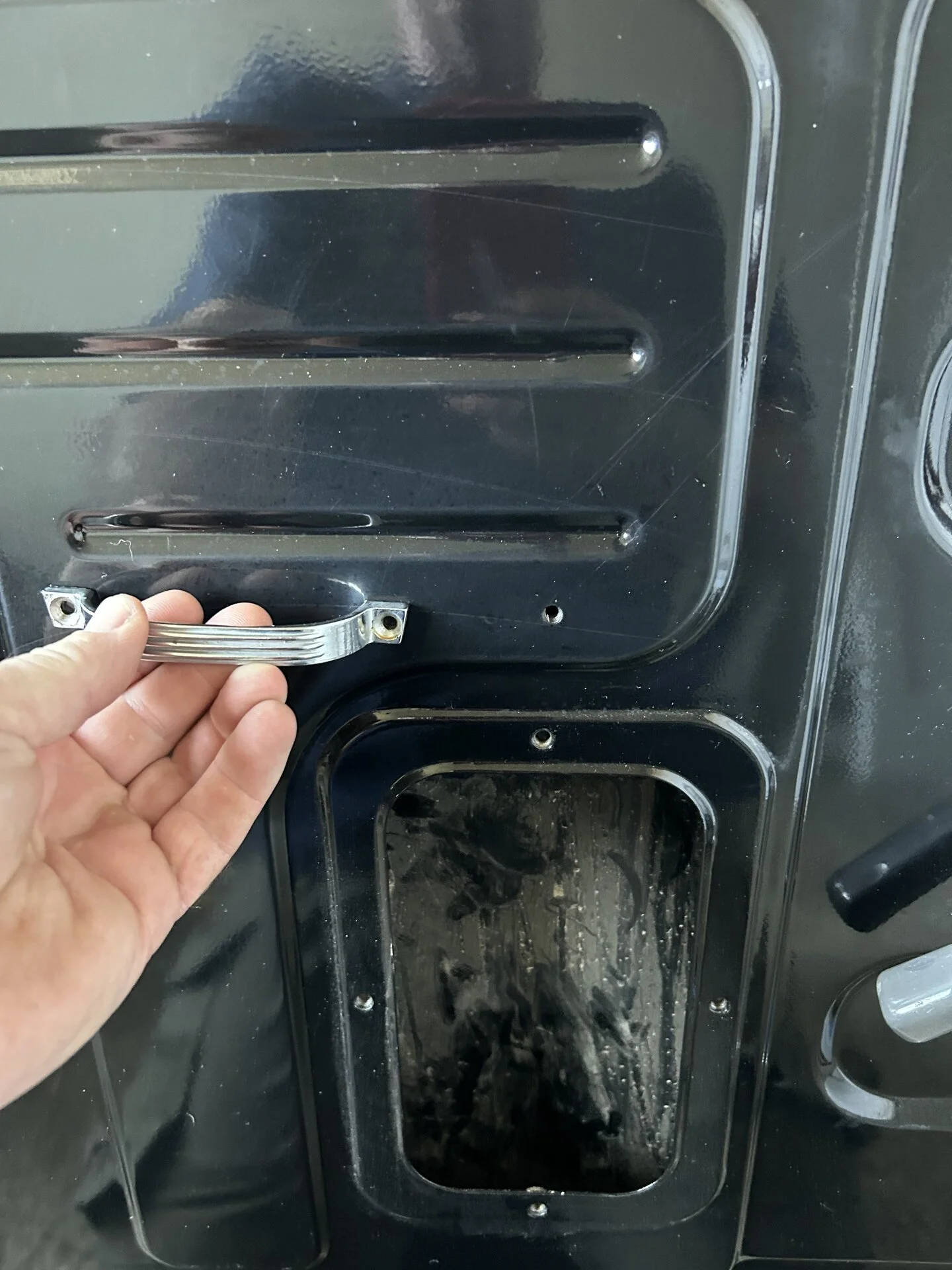

Ugg. I really am at the point that I want this 40 out of my life 😞. So I finally was able to get door handles and went to put them on and of course they are not even close 🤦🏻‍♂️. They certainly are the correct handles. I think 🤷‍♂️. Have not seen any different ones . And as far as I know the holes in the doors are oe 🤷‍♂️. But they are not even close . I mean I can drill new holes but then I have a hole still in my door . I guess. I should just be glad it’s my wheeling rig and not worry about it 😞. Still pisses me off though
There were two interchangeable styles of _early_ chrome door pulls. Think they stopped ~ 9-1973.

So 🤔. Would I be dumb if I raptor lined the inside of the hardtop sides 🤷‍♂️. The inside of the tub will be . The only thing I guess I don’t like is the dust is kinda hard to get off the Raptor liner . Hmmm.
I used Line-x inside the tub of my fj40 and under when i first restored it 20 years ago. I found very little rust when i decided it was time to give it another go. Many people don't like to use that stuff anymore but i can say that it does offergood protection against damage and rust.
I used white raptor liner on the inside of my hardtop instead of a headliner. I dig it. Really "brightened up the room". Go for it.
